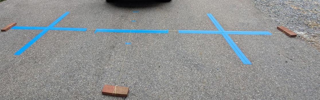

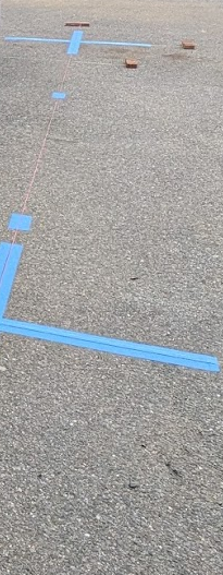

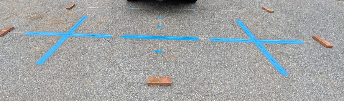

Here are a few photos to give a visual of what you're in for if you opt to do it yourself.
Rear marks
2024 Tacoma 2025 Limited - Grille swap with TRD OR/SPORT? 1756409843645-zi
Front marks
2024 Tacoma 2025 Limited - Grille swap with TRD OR/SPORT? 1756409912753-ka
Side marks (crosses are the same as you see in the front & rear, but you add those two extra short lines for the side views to know their angle positions).
2024 Tacoma 2025 Limited - Grille swap with TRD OR/SPORT? 1756409982902-ev

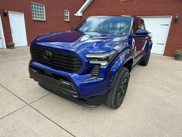

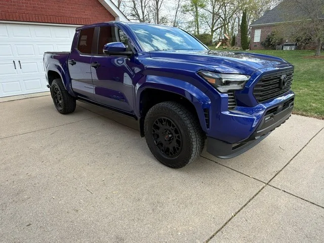

Just Plastidip everything you want black. Easy peasy.
Wolf359
Jun 22, 2025
43
Middle Tennessee
2025 Toyota Tacoma
That's what I did! 8 coats black and 2 coats clear plasti-dip without taking the front apart or all of that camera hot mess. Been on several road trips without any issues.
