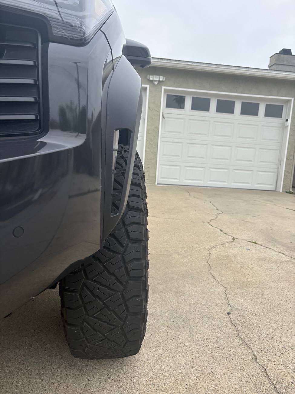

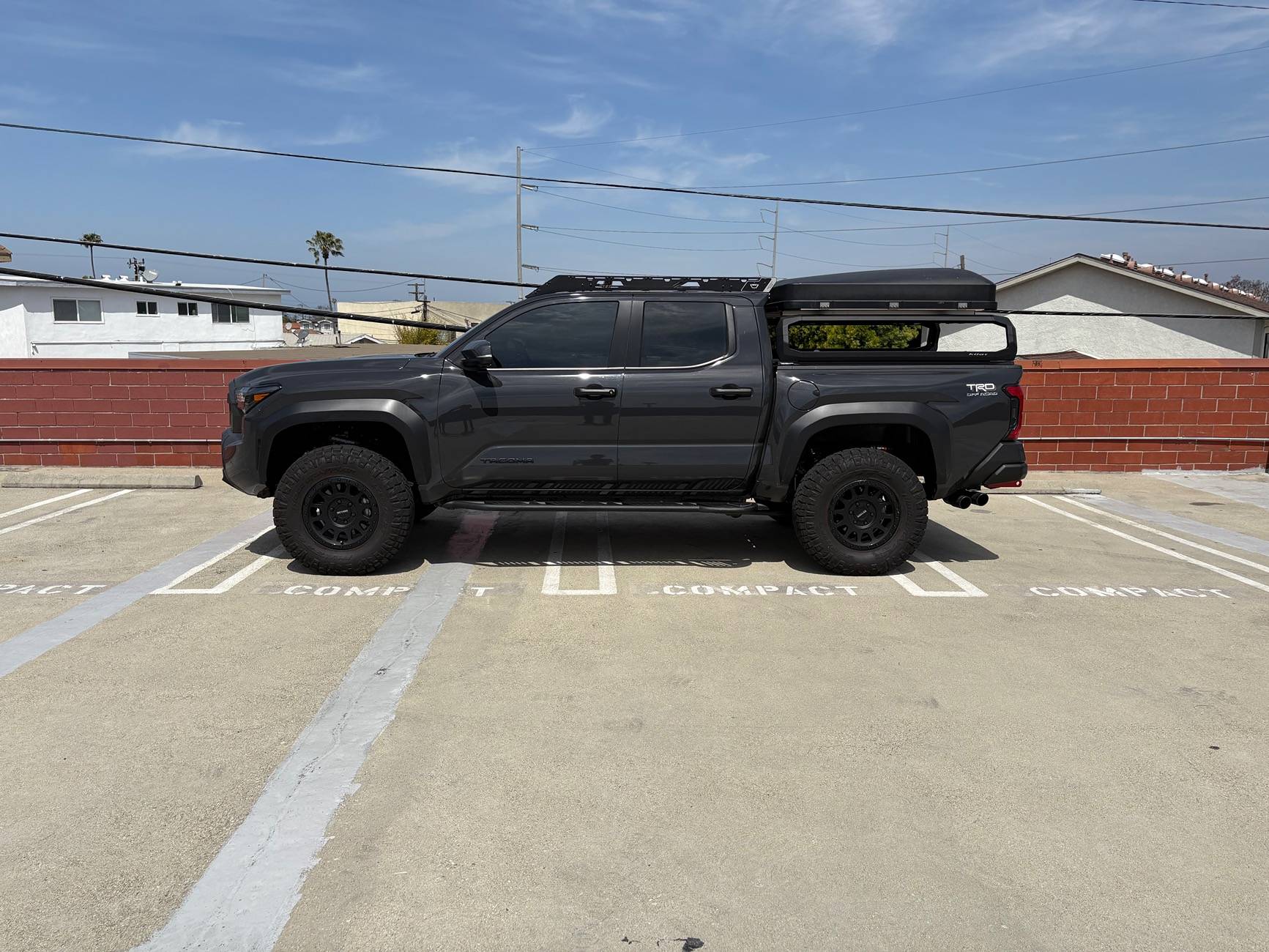

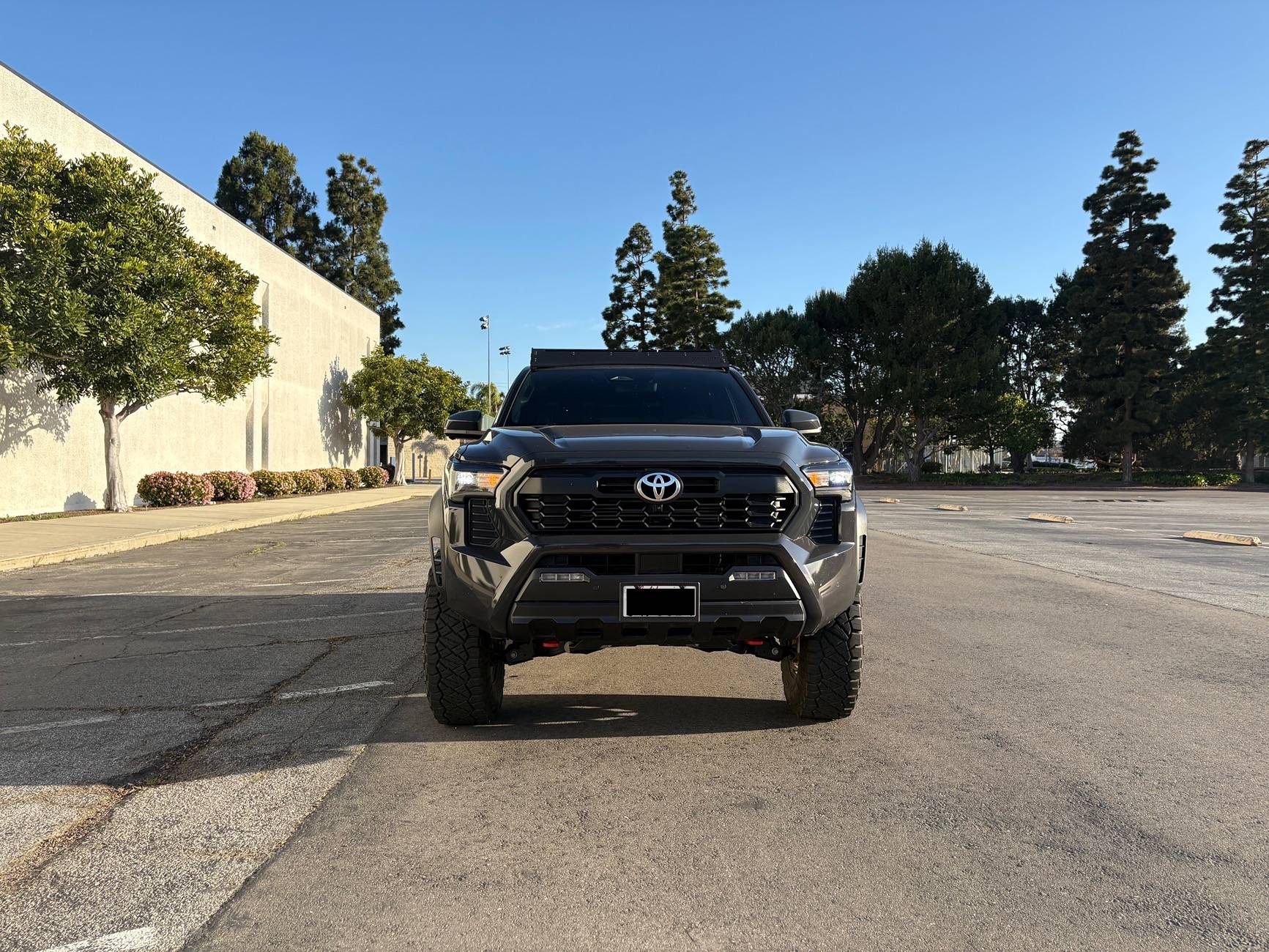

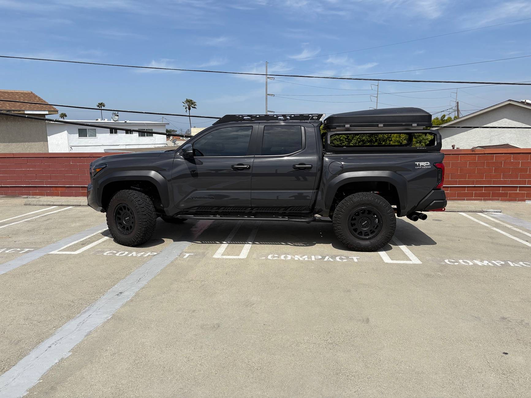

You're right on the height but I was thinking the extra width would visually fill out more of the wheel well. My current tires are 11.26 inches wide but the Mickey Thompson Baja Boss ATs are 12.8 inches for their 35 x 12.5 R17. I live in LA. Its a looks thing. However, I've decided to stay with my current setup. It's functional and doesn't look bad. Maybe when re-gearing for these new 4th gens becomes available I will revisit this larger tire issue again.
I have the Mickeys in 35x12.5 and I would say yours looks good the way it is. If you go any bigger you would want to PPF the rear end or deal with rock chips, also, the 4th gen doesn't need re-gearing with 35s.

Honestly ,imo..your truck looks great and i would enjoy it now, looks rugged and very usable, ..you have done nice job on your truck, many happy safe miles to you
Thanks for the compliment! I'm just going to keep things as they are until I need to replace my tires in the future. I'll revisit the issue again then. For now, I've very satisfied. Can't wait to test my rig setup with my overlanding trip to the Grand Canyon next week.

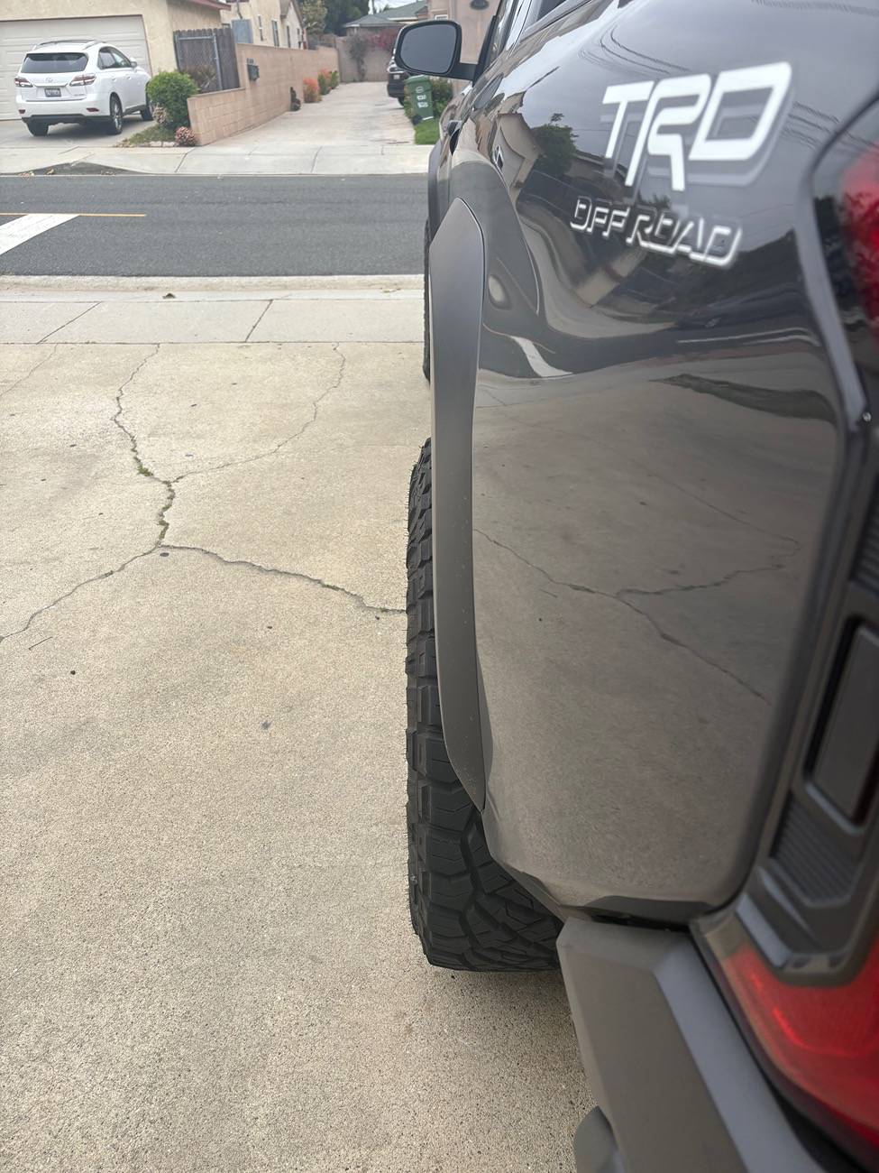

+25 offset, 8.5inch rim width, 285/70R17 tires
Here is the poke! Better stay with +35 if you don’t want poke. I added RCI fender flares they now are flush again.

Looking at it down the side I didn’t think there was much poke either, hit a muddy road and it was flying all over! The level puts into a little better perspective.

TRD Off Road, JRI shocks 1.5 front lift 1.0 rear lift, Nokian OutPost NAT tires. Factory control arms. Alignment is all green. Full droop I’ve only got about 1/4 inch of clearance between the UCA and the shocks ?, UCA,s are next on my list.

Well the level doesn’t lie! The only difference is the OP’s tires are 1/4 narrower. The math is simple, +55 - +25 = 3cm or 1.2 inches, my wheels are 8.5 inches wide, factory is 7.5 inches wide, this pushes the wheel out another 1/2 inch. VS OEM this set up pushes the wheel and tire out an additional 1.7 inches, now add a tire that is 8 tenths of an inch wider than OEM pushing the width out another 4tenths for a total of 2.1 inches wider than OEM. UCA’s make no difference.
