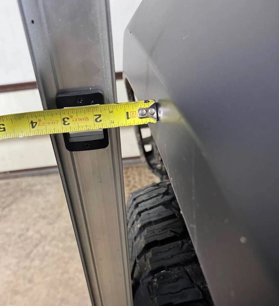

+25 offset, 8.5inch rim width, 285/70R17 tires
Here is the poke! Better stay with +35 if you don’t want poke. I added RCI fender flares they now are flush again.

I definitely want poke. See now yours looks like more poke than TacoMoFo but you basically have the same tire size and offset. Same truck too. It’s hard to judge.

Looking at it down the side I didn’t think there was much poke either, hit a muddy road and it was flying all over! The level puts into a little better perspective.

Well the level doesn’t lie! The only difference is the OP’s tires are 1/4 narrower. The math is simple, +55 - +25 = 3cm or 1.2 inches, my wheels are 8.5 inches wide, factory is 7.5 inches wide, this pushes the wheel out another 1/2 inch. VS OEM this set up pushes the wheel and tire out an additional 1.7 inches, now add a tire that is 8 tenths of an inch wider than OEM pushing the width out another 4tenths for a total of 2.1 inches wider than OEM. UCA’s make no difference.
