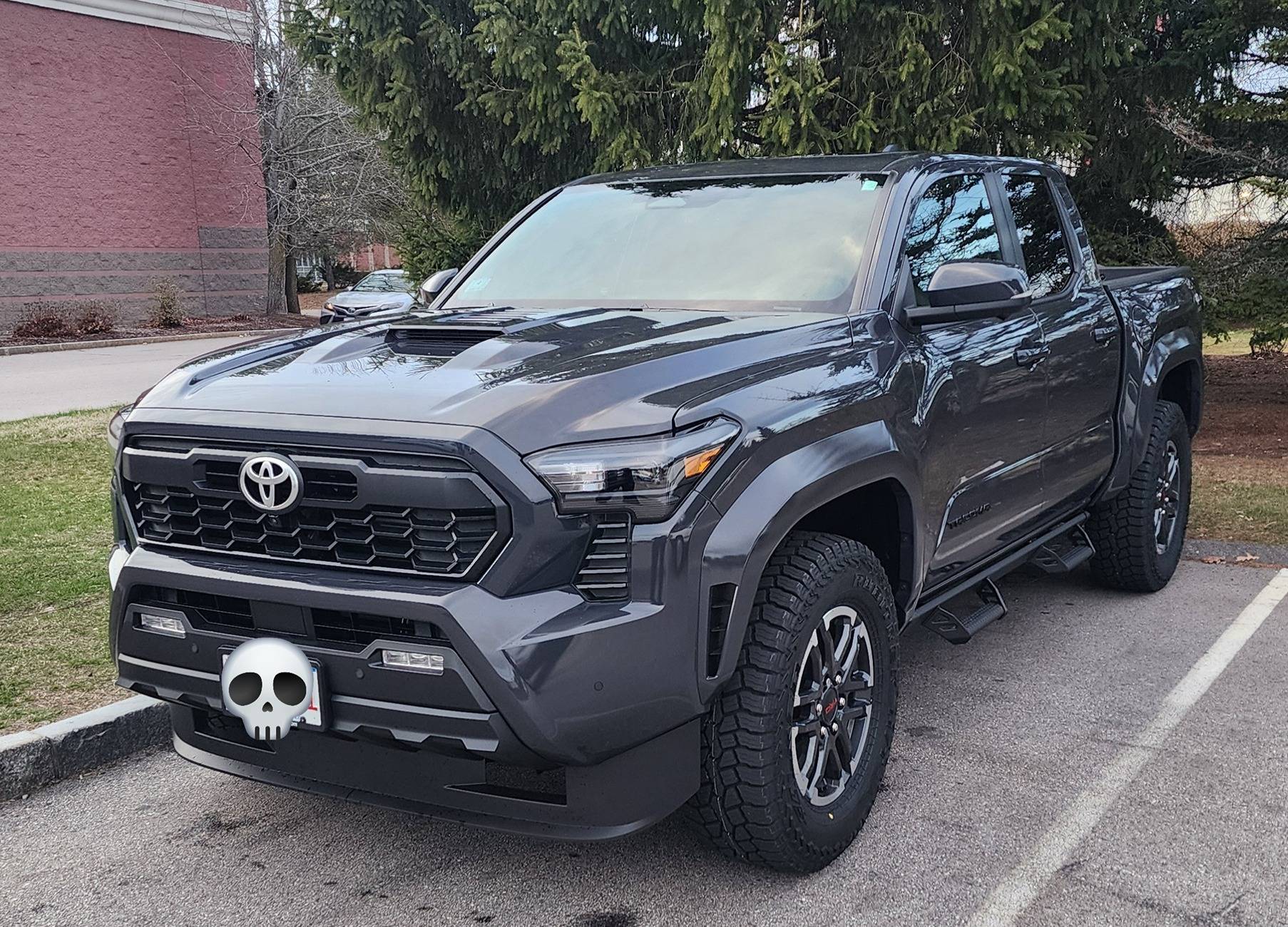

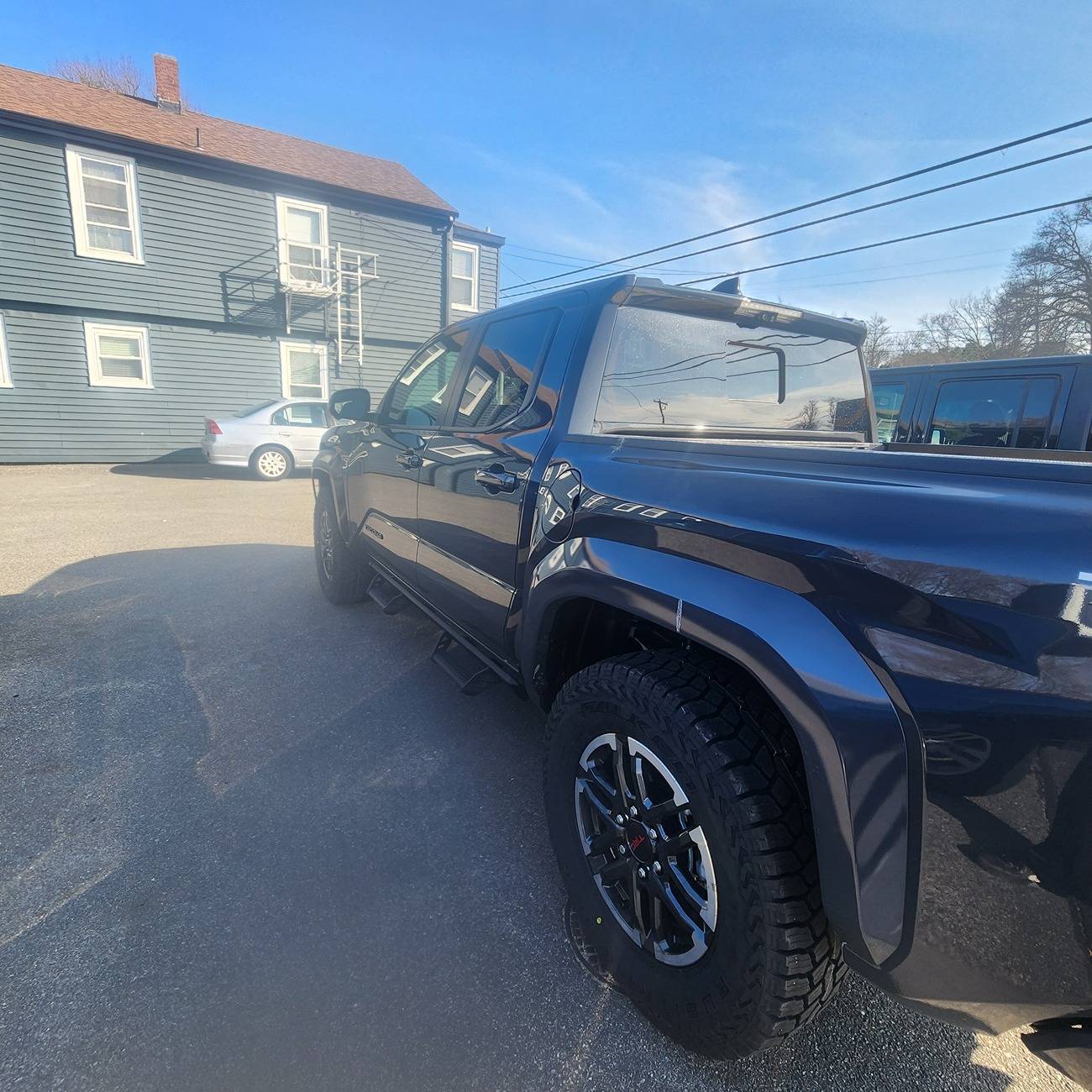

2025 TRD Sport just purchased 3 weeks ago. My old girl (2015 trd sport) always sat on Ko2's but decided to go with the Falken Rubitrek A/T. Stock was 265 65 R18. Stepped it up to a 275 70 R18 and they look amazing. They fill in the wheel wells and gave me about an inch of ride height over the stock General Grabbers. There's still room to possibly get 285 but some front fenderwall trimming might be necessary. 2 weeks running these tires about 500 miles and averages 17.4 mpg, downgraded from an average of 19.
