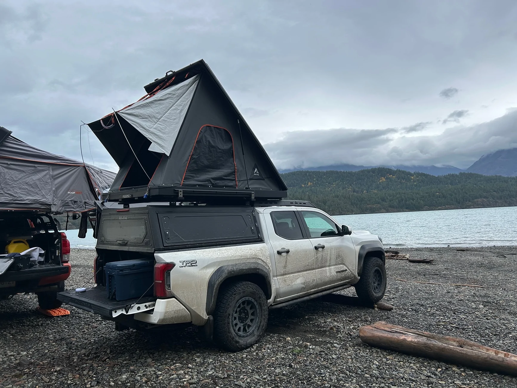

I’d rather sleep in the bed tbh. Not a fan of the roof tent
Well, I'm in the roof tent camp. Granted, to each their own. I now own two roof tents. One on my 4Runner, and the second on the Tacoma. There is no going back to anything else for me. In my case I carry too much junk to sleep in the truck bed.

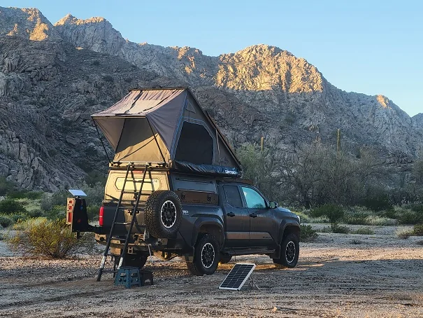

What rear duel swing rear bumper are you running and did you upgrade the rear springs to a heavier coil?
I would appreciate your help.
Pappy
Jon
Jan 11, 2025
437
602
Intermountain West
The bumper is Victory 4x4. In the rear I'm running Dobinson 821 springs with a 1/2" spacer. If I did it again I would go with the Dobinson 823 springs. The front springs are AllDog.

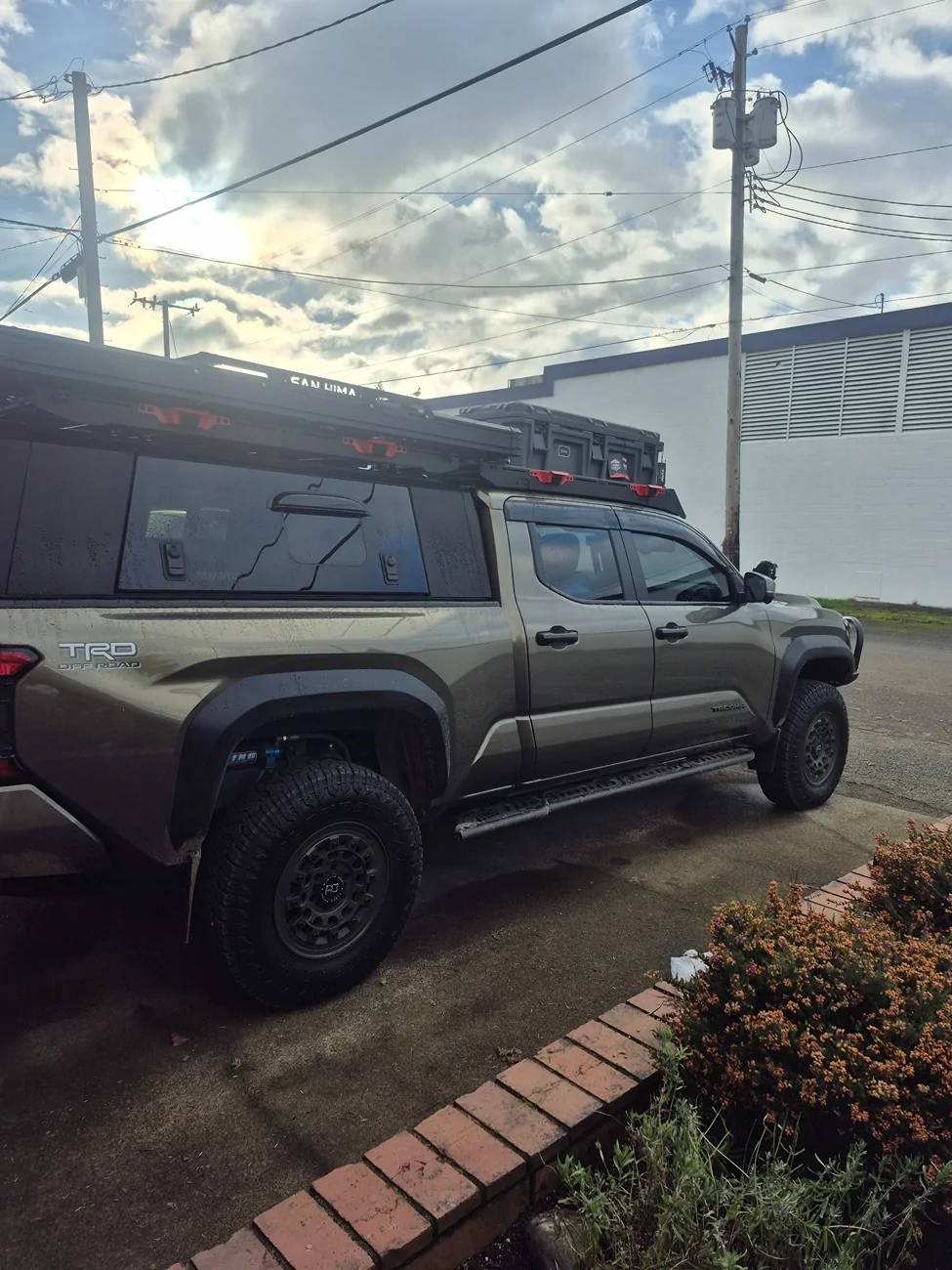

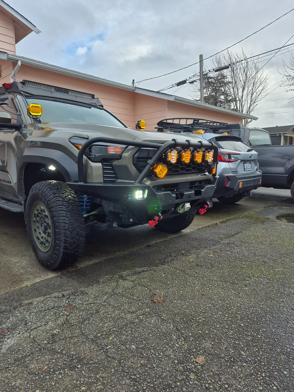

I have king all the way around with Dobson 821, now and 823s on order, due to the rooftop tent, 500amp solar panel will a 3000w solar battery. With the 821 and the back end loaded, it's a little spongy for me. That's why i'm going to the 823's especially thinking about a dual rear swing, how do you like that bumper? It looks awful large and lower to the ground compared to the stock?
I love my hybrid backwoods front bumper, with the Warren 12K winch. But now I'm half an upspring, the front King c
oilovers from 500 pound coils to 650 pound coils. To lift it back up and restore the performance.
I'm really waiting for a dual swing. That wraps around to the Fender.

I really like the bumper. I hate having the spare tire under the bed and this is the third truck I've owned where I mounted the tire on the bumper. It's a very heavy bumper with the swing-outs, 20L gas, and the tire. The weight added up with the camper, the 200AH batteries, 380W solar, 13 gallon water tank, and all the junk I carry for a long trip. If they ever come out with an auxiliary fuel tank I will need to upgrade to the 823 springs, if not the 825.
