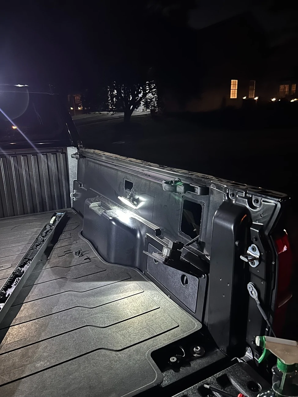

Here I am in the middle of installing it :

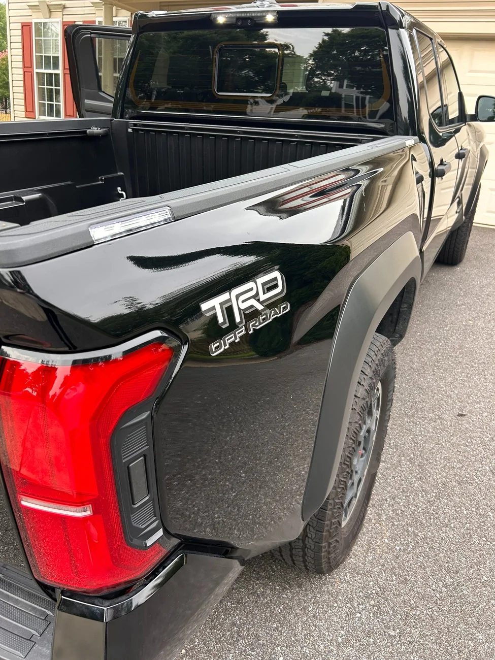

Here's how it looks installed during the day, barely noticeable:

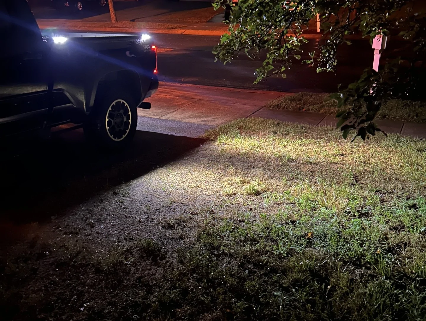

And then this is it at night :
Overall, I like the way it all looks. It does help with loading the truck up at night or early in the morning but let me know what you guys think and if you will be doing this soon!
