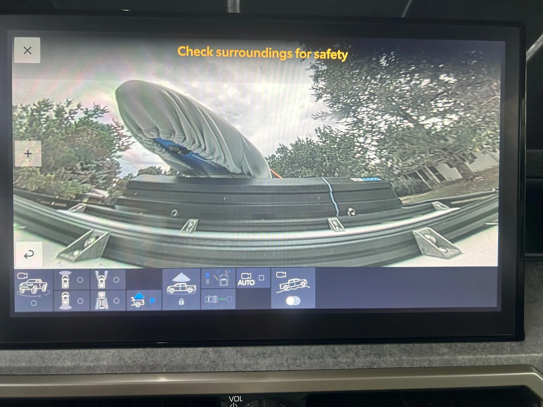

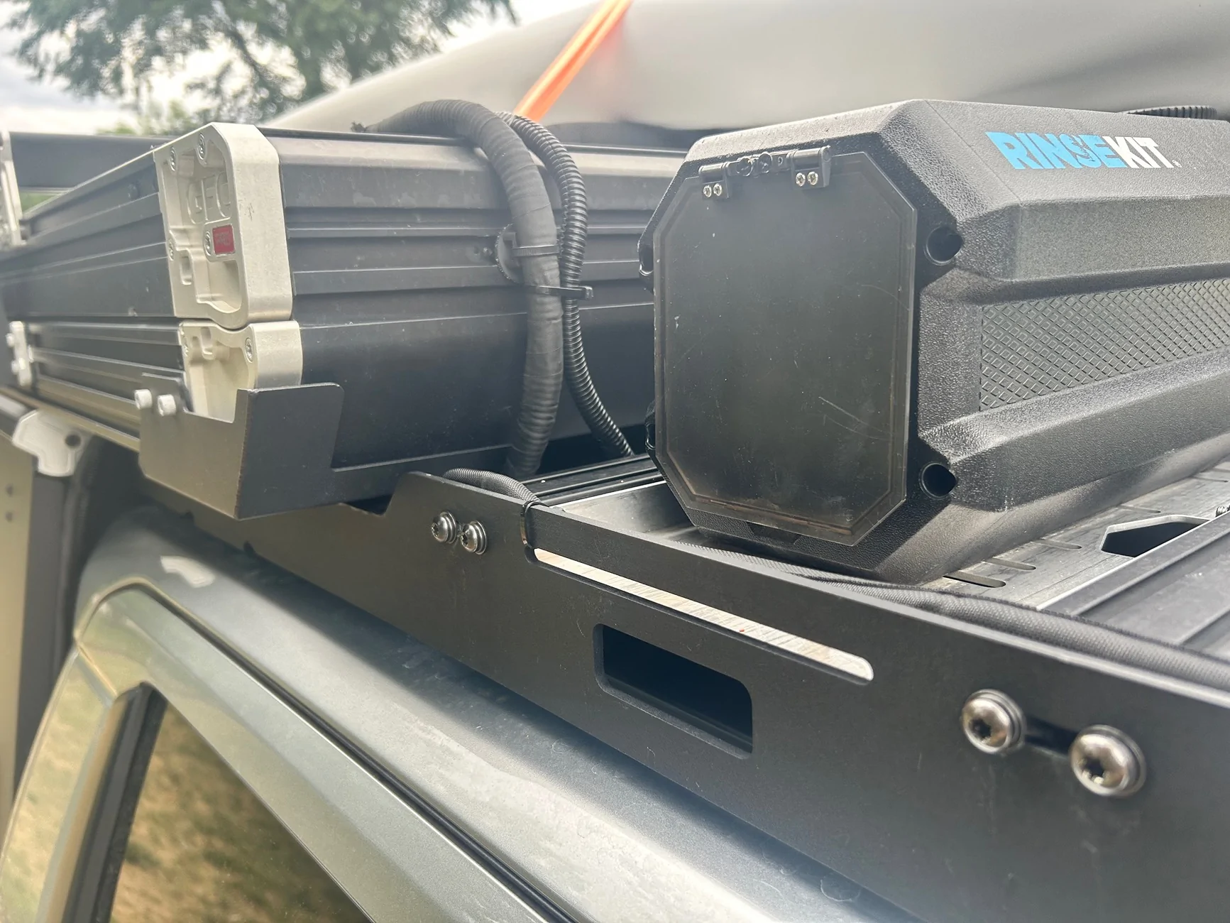

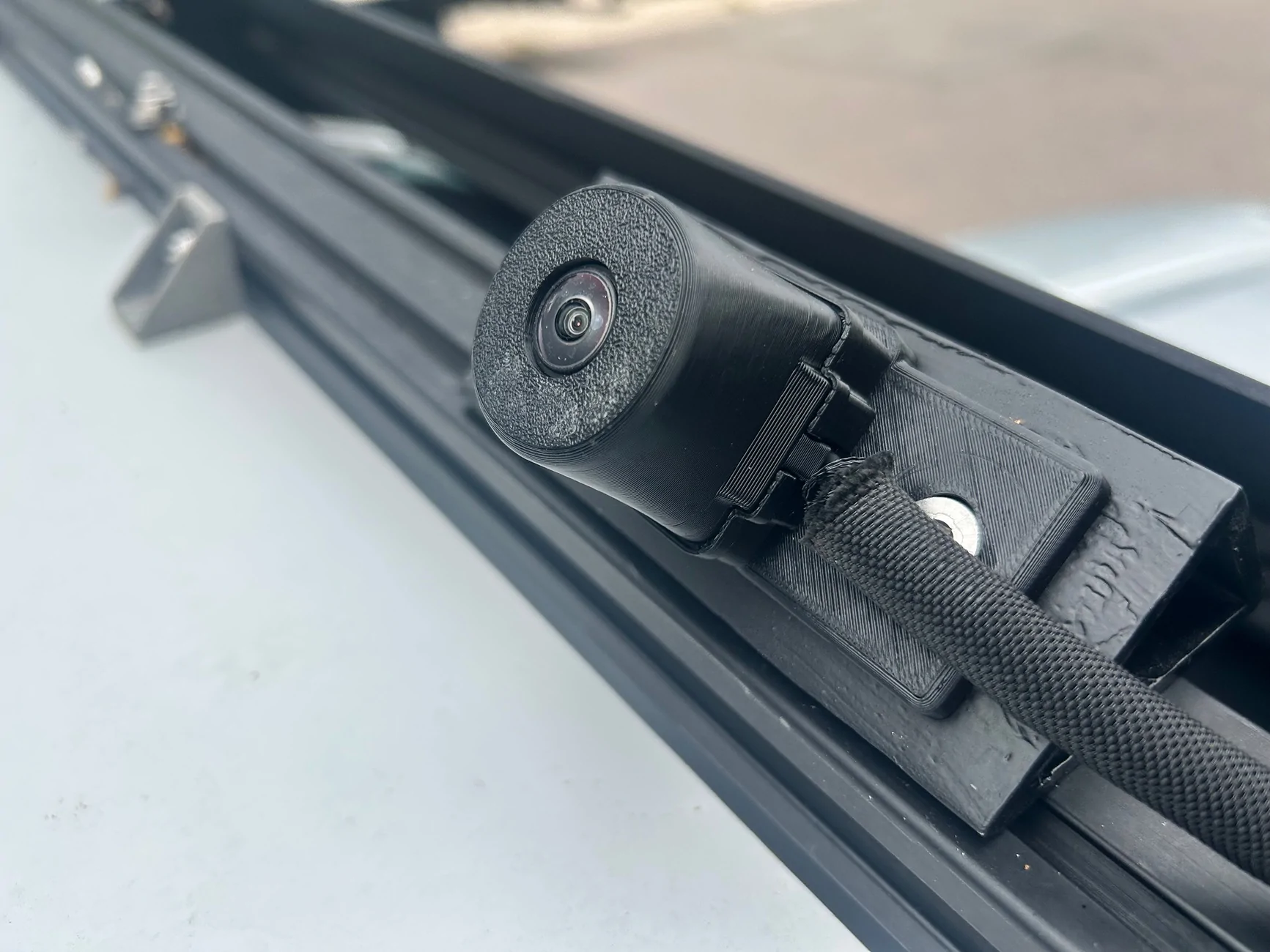

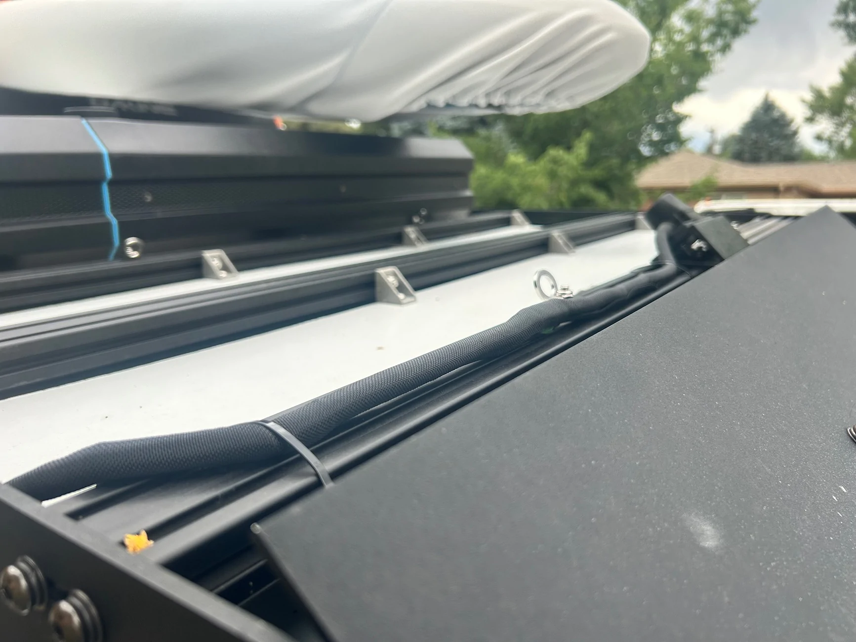

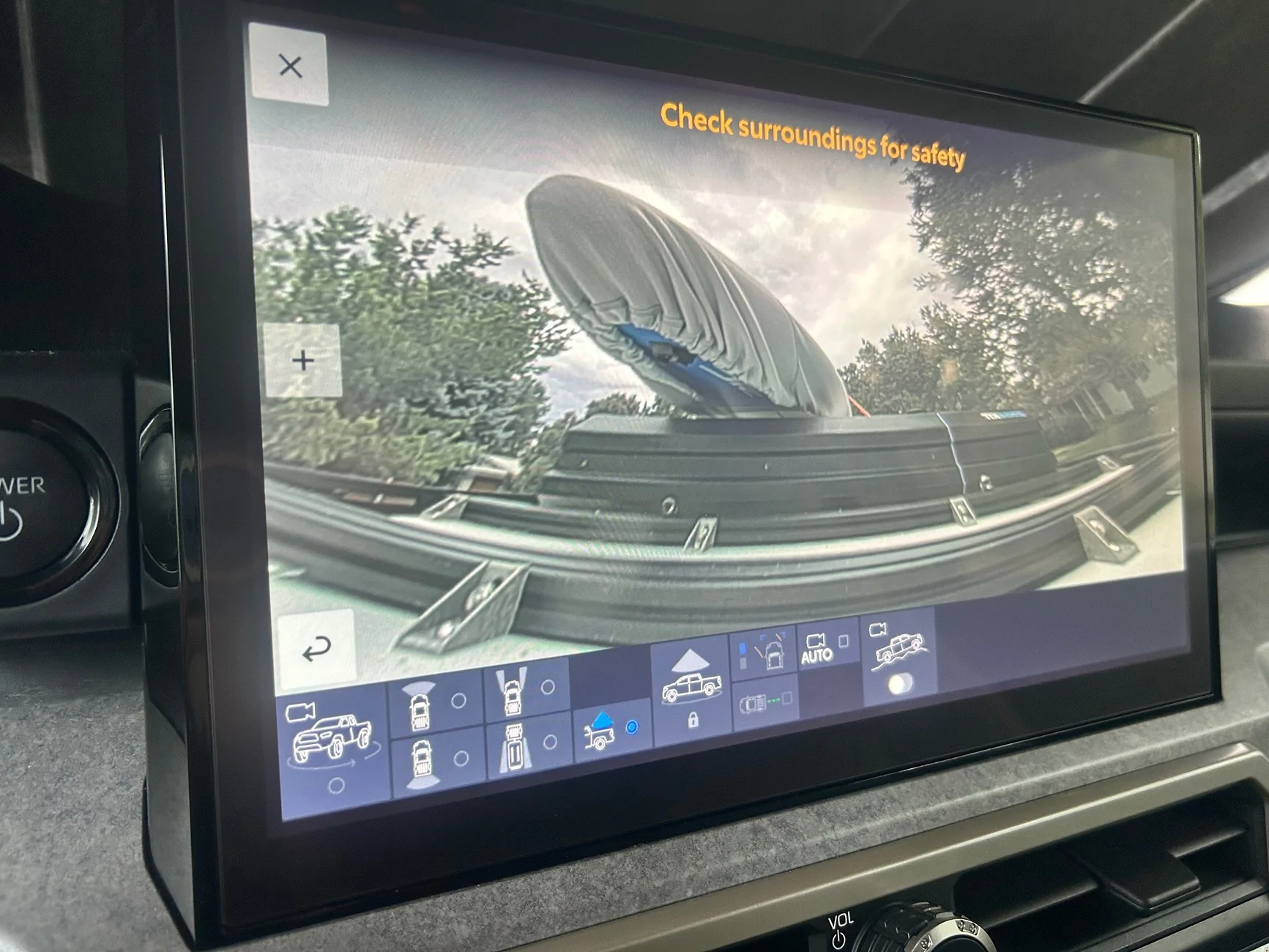

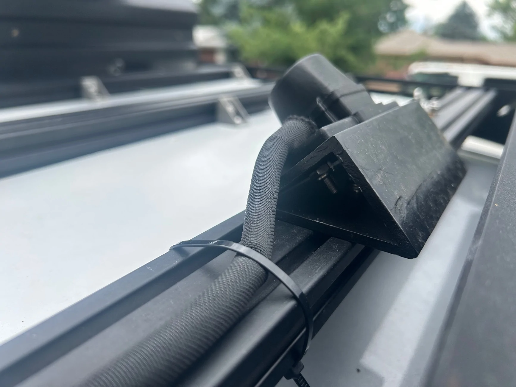

Doesn’t work at night but that can be fixed with a small led ditch light on an aux switch! Waiting on my drop-in series 10 anchors to clean up the harness on the roof rack
For the boys who run gear on the roof for long trips or windy days 🤙🏼
Shout out to GG off-road for the relocate housing / bracket is self made fabricated from aluminum triangle. Haven’t been on the boards that much lately maybe someone else has done a roof cam, here’s what I ended up doing as another option. Cheers
2024 Tacoma Roof Camera Installed on a Trailhunter IMG_6171
2024 Tacoma Roof Camera Installed on a Trailhunter IMG_6166
2024 Tacoma Roof Camera Installed on a Trailhunter IMG_6174
2024 Tacoma Roof Camera Installed on a Trailhunter IMG_6173
2024 Tacoma Roof Camera Installed on a Trailhunter IMG_6175
2024 Tacoma Roof Camera Installed on a Trailhunter IMG_6169

Was that the camera that was used to view the bed and repurposed? Or is this a different camera?
Yep it’s the wide angle cargo camera. The rear view mirror camera was moved to the back of the GFC hatch

Where are those camera connections made, at the CHMSL or is there a different place to tap into them? Does it require me to drop the headliner in the 4G?
Yea you drop the headliner and route down the side rear passenger seat, go out the boot directly under that seat
