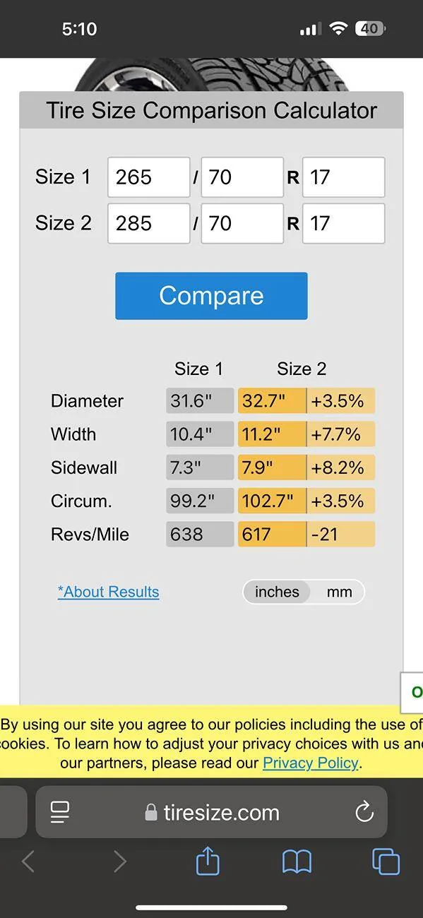

I am looking at getting a new set of tires/wheels. I'm seeing that the most popular fitting here are 285/70/r17's, I'm looking to pair them up with some Method 305's. My question is, how does the speedometer read after putting on these bigger tires and are you guys getting them recalibrated? I'm thinking of getting Mickey Thompson Baja Boss LT 285/70/r17 (Load E).
Assuming you are currently running 265/70/17 the move to 285/70/17 will increase the diameter by 3.5%. So if the speedometer reads 60mph you are actually going 62.1mph. I have the same on a 2021 TRD Off Road with 2.5” Ironman Lift. Looks great. If you can fit 285/75/17 that will give you an extra 1”. Stick with Load C unless you are hauling very heavy loads. Load E is too stiff for this light truck and results in a bumpy ride. Load C will be much more comfortable.
2024 Tacoma 285/70/r17 recalibration? IMG_6290
