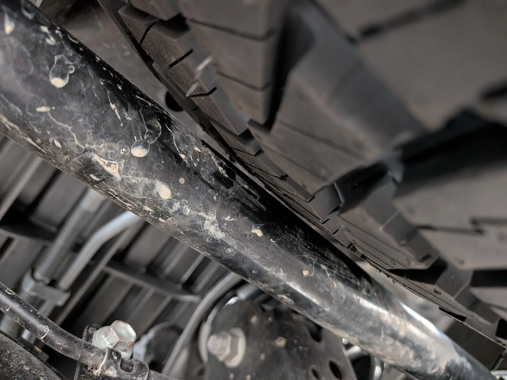

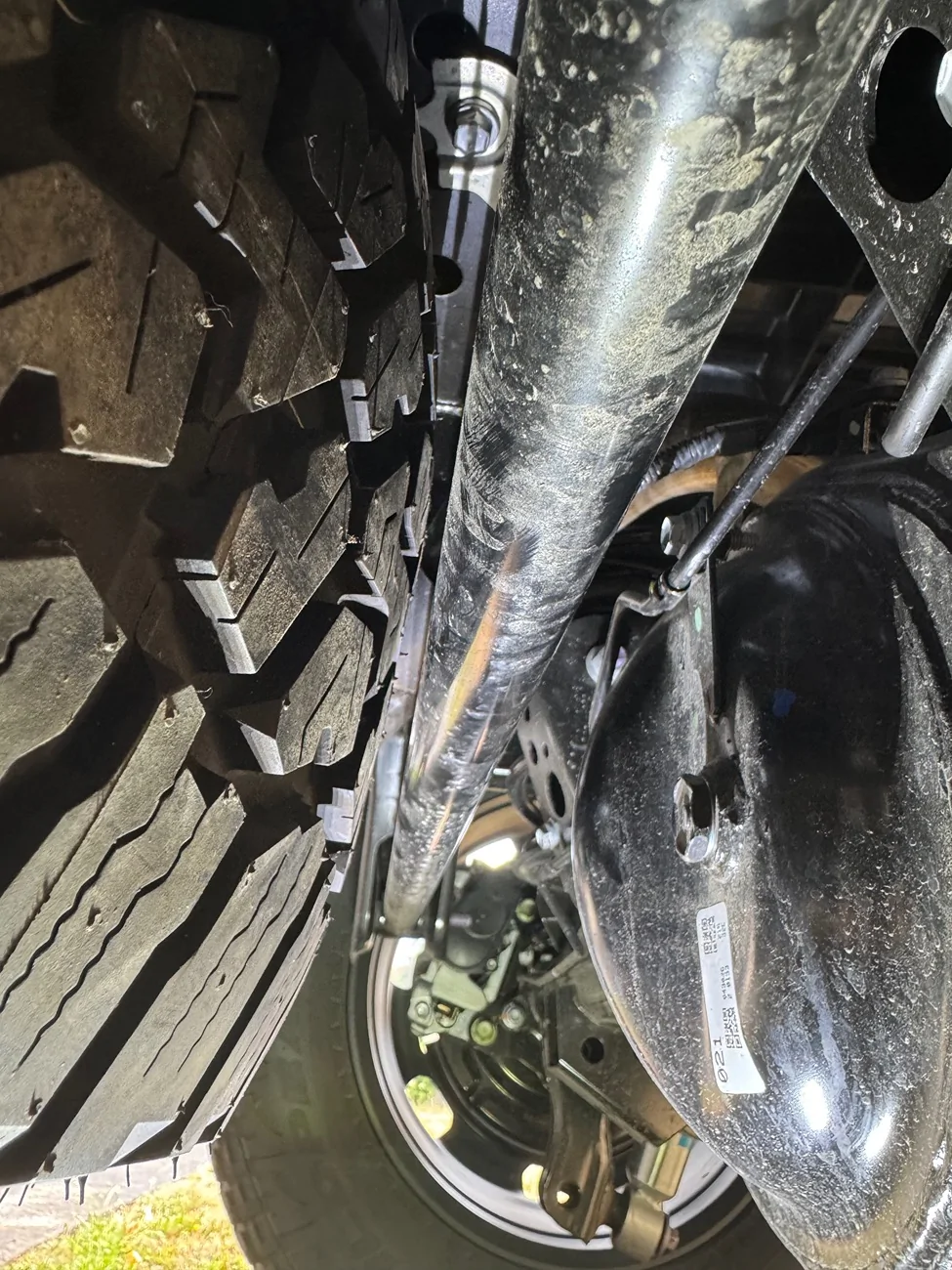

I can confirm that a 285/70/17 Falken Wildpeak AT3W retail version at 38psi will fit in the spare location. It’s VERY tight and require guidance.
2024 Tacoma Spare Tire Alternatives for a 285/70/r17 IMG_4770
2024 Tacoma Spare Tire Alternatives for a 285/70/r17 IMG_4768

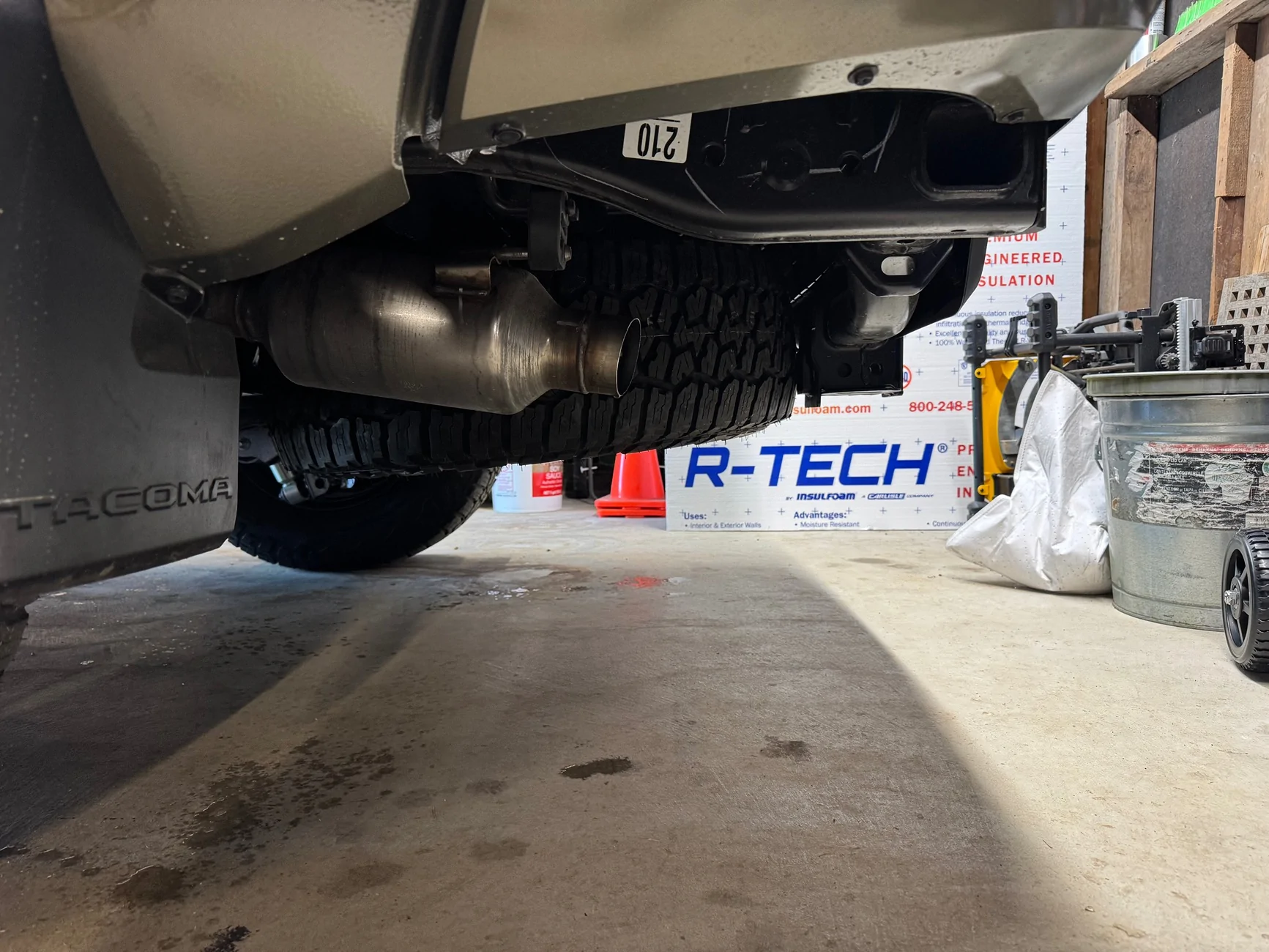

Ditto. Got the 285/70r17 Pathfinder to fit with guidance, but after track bar relocation it was this close
2024 Tacoma Spare Tire Alternatives for a 285/70/r17 47889-c40d9784307487fb3dab98384f33fcdd

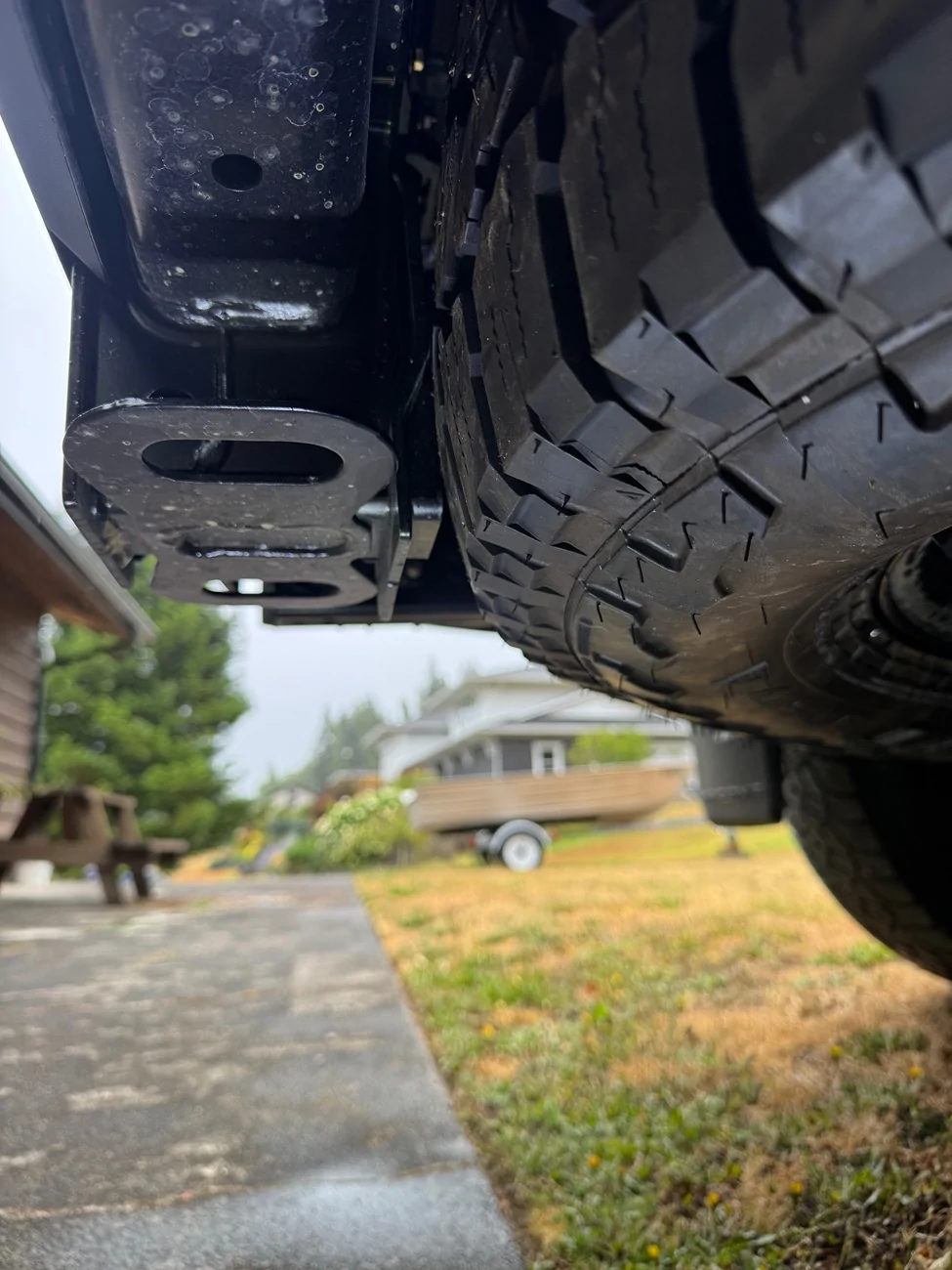

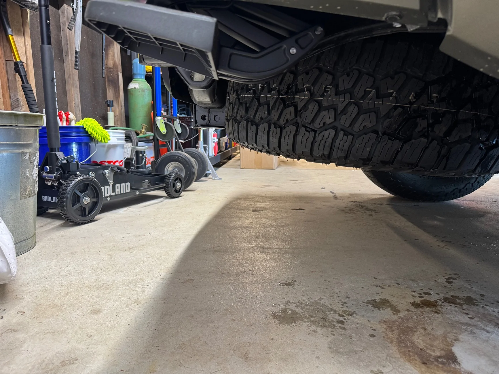

Yeah I've read in several posts that it fits. I'm more concerned about the change in clearance at the bottom

Side views. You loose an 1”+ 1/4
2024 Tacoma Spare Tire Alternatives for a 285/70/r17 IMG_4775
2024 Tacoma Spare Tire Alternatives for a 285/70/r17 IMG_4776

Probably acceptable for mild off-roading but looks like too much exposure for the spare tire to get side wall damage during technical trails, IMO.
