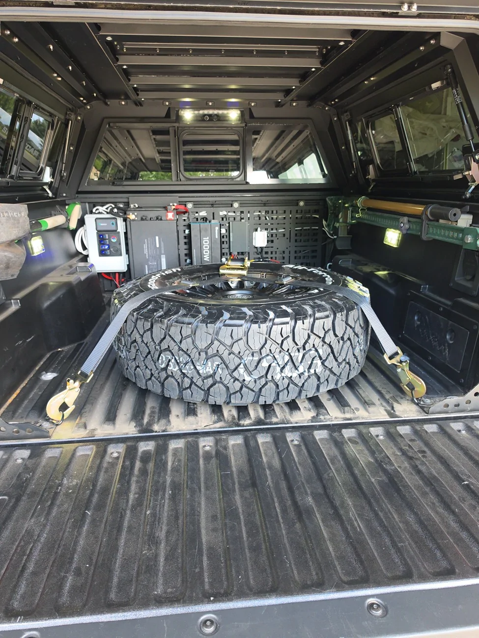

I liked the idea of having a perfectly matching spare. Failed to do any research before buying (5) 285/75/17s. I don't bother with the spare for day to day travel and something about having that spare area underneath the bed just feels great. Unfortunately, when I hit the trails this is what I'm stuck with doing. Not the end of the world but tough to pack around that.
Good luck with your search for a more practical solution!!

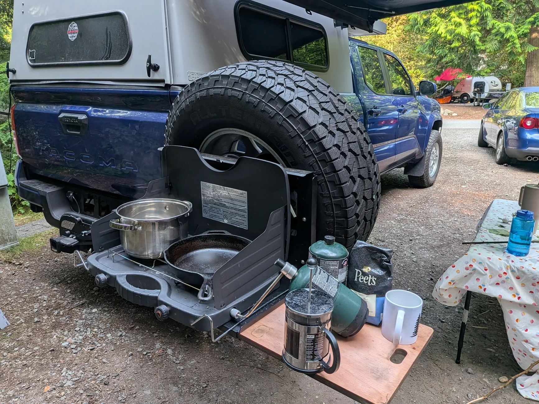

Trailswing dude ! Or Ultraswing.
Can take it on and off. And you can do some good ol fashioned cooking and have your bed space back. Can find used ones here or there for under $1k
