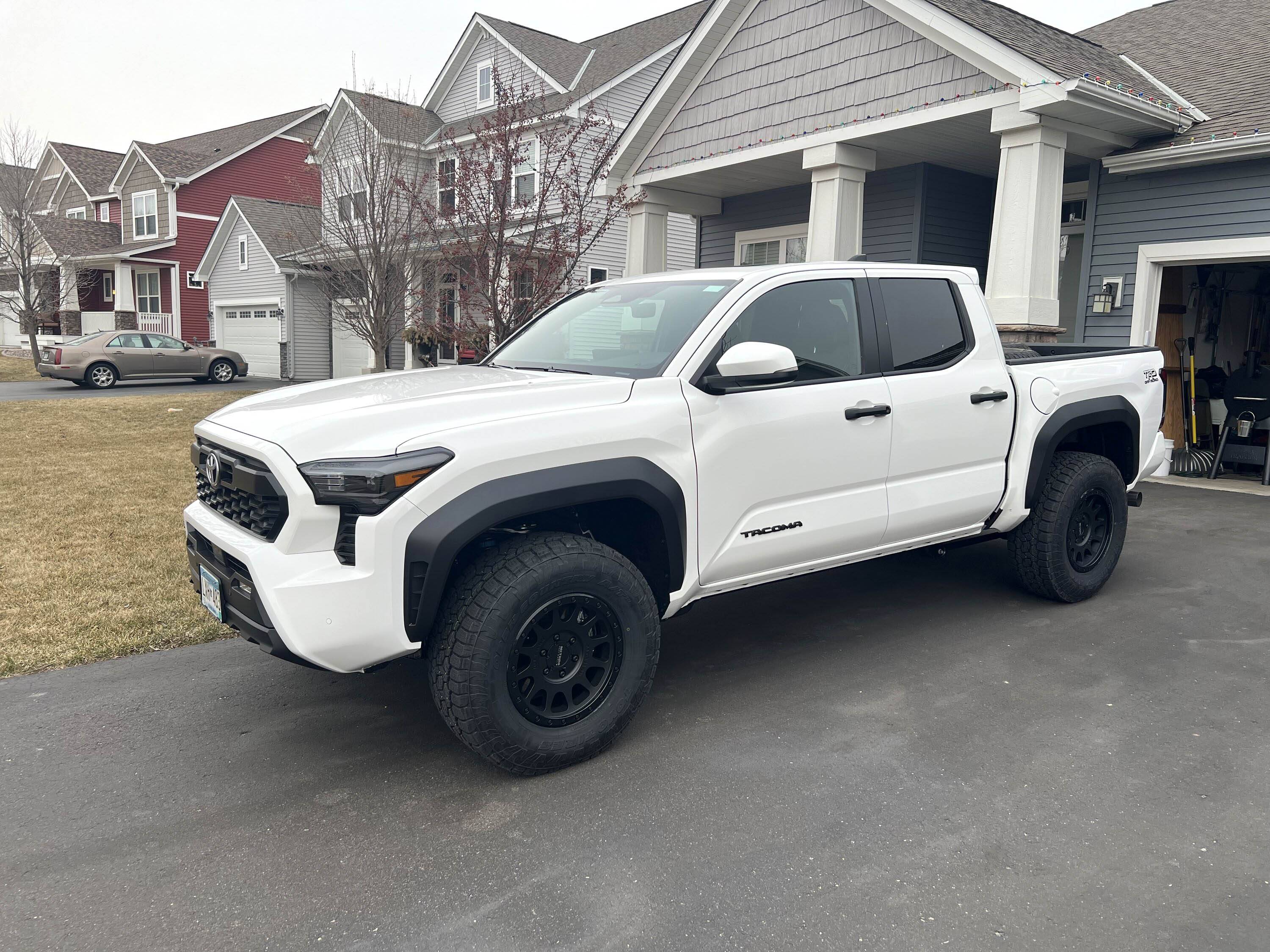

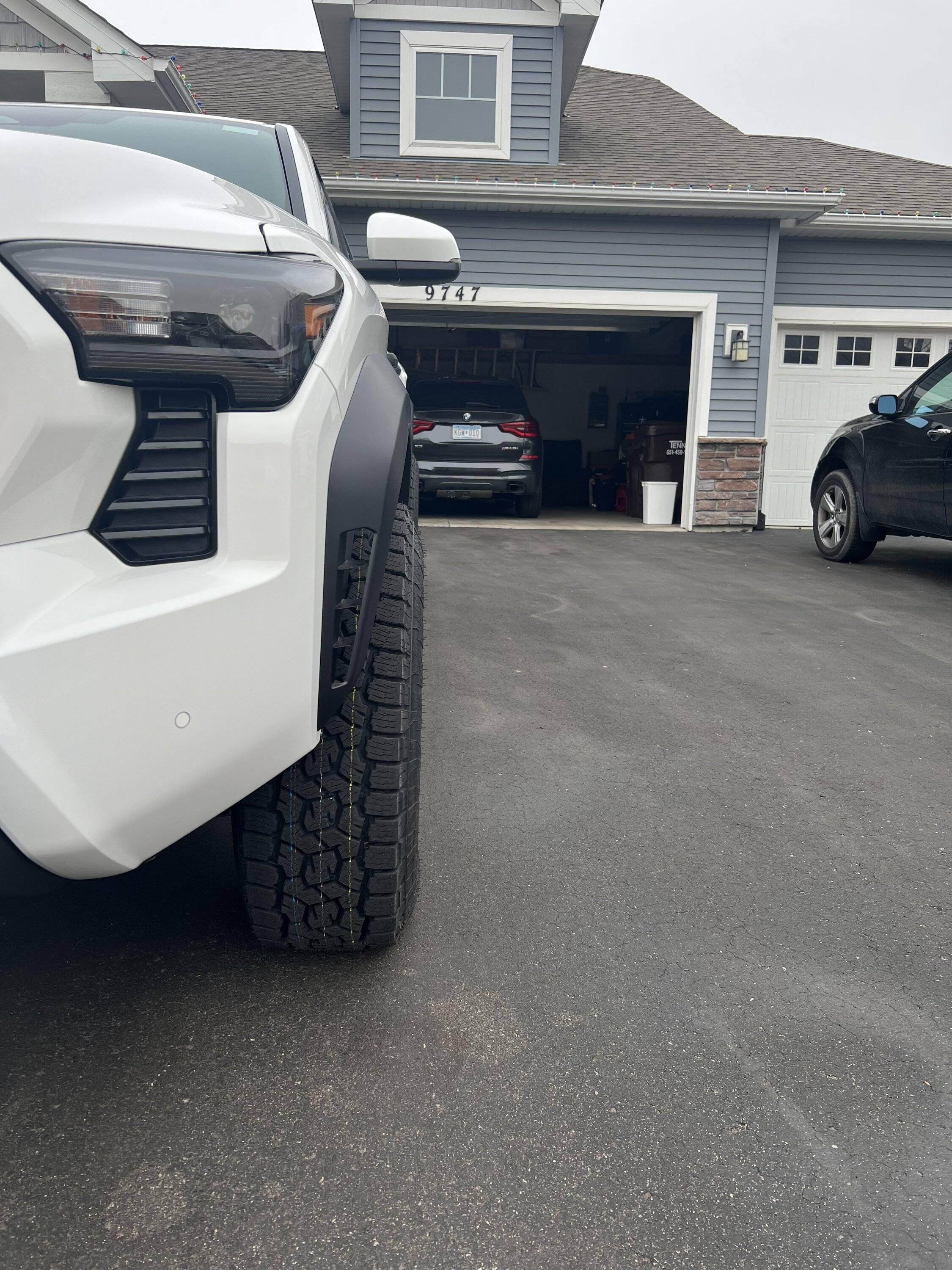

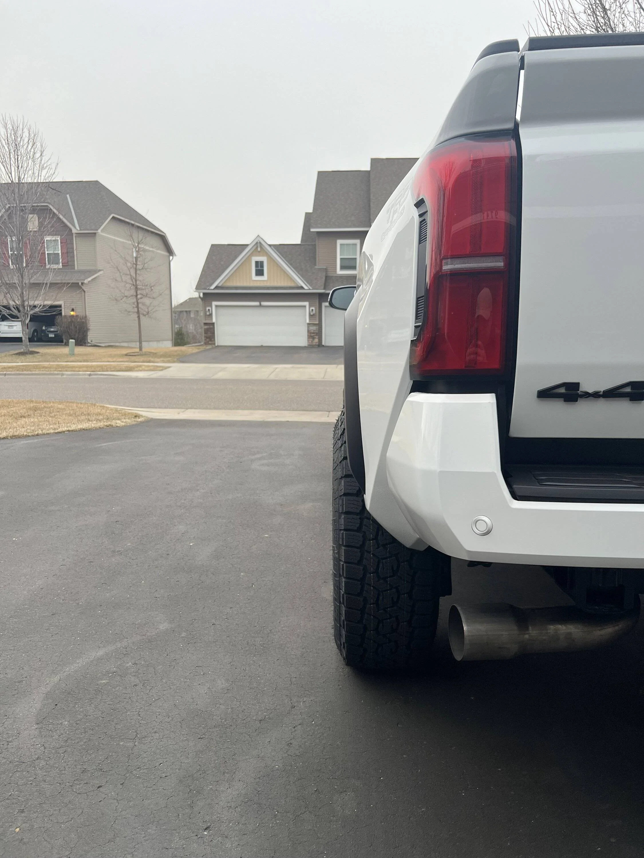

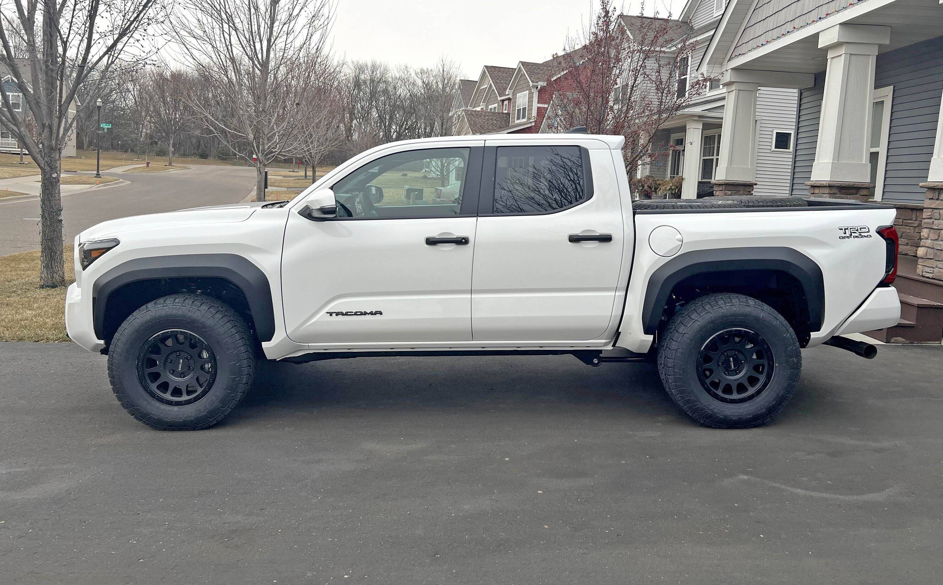

Hi Tacoma4g,
New to Tacos. Truckless for the last two years, last one was a 16’ Tundra DC Pro. I’m enjoying the new Taco but I wanted to give it more presence.
Just got back from Discount Tires and wanted to share my new wheel/tire setup. Required no modifications or removal of any OEM parts
2024 Toyota Tacoma Offroad w/ 5’ bed
- completely stock suspension
- no cutting or crash bar removal
Tires: 285/70/17 Toyo Open Country AT3
- standard load, not 6, 8, or 10 ply
Wheels: 17x8.5” Method MR305 NV Black
- +25 offset
Enjoy!

Thanks, I am looking at a very similar setup for my TRD Sport when it arrives and these pictures helped. What did you do with your stock wheels and tires?
In the garage. Haha
Looks good. Now get those front windows tinted!
Thanks. On the to do list and a bed cover.

That looks great! I was thinking +25 might have too much poke, but I think the fender flares on the Off-road are wider than the SR5. I wouldn’t hesitate to use that offset when my OR comes in.

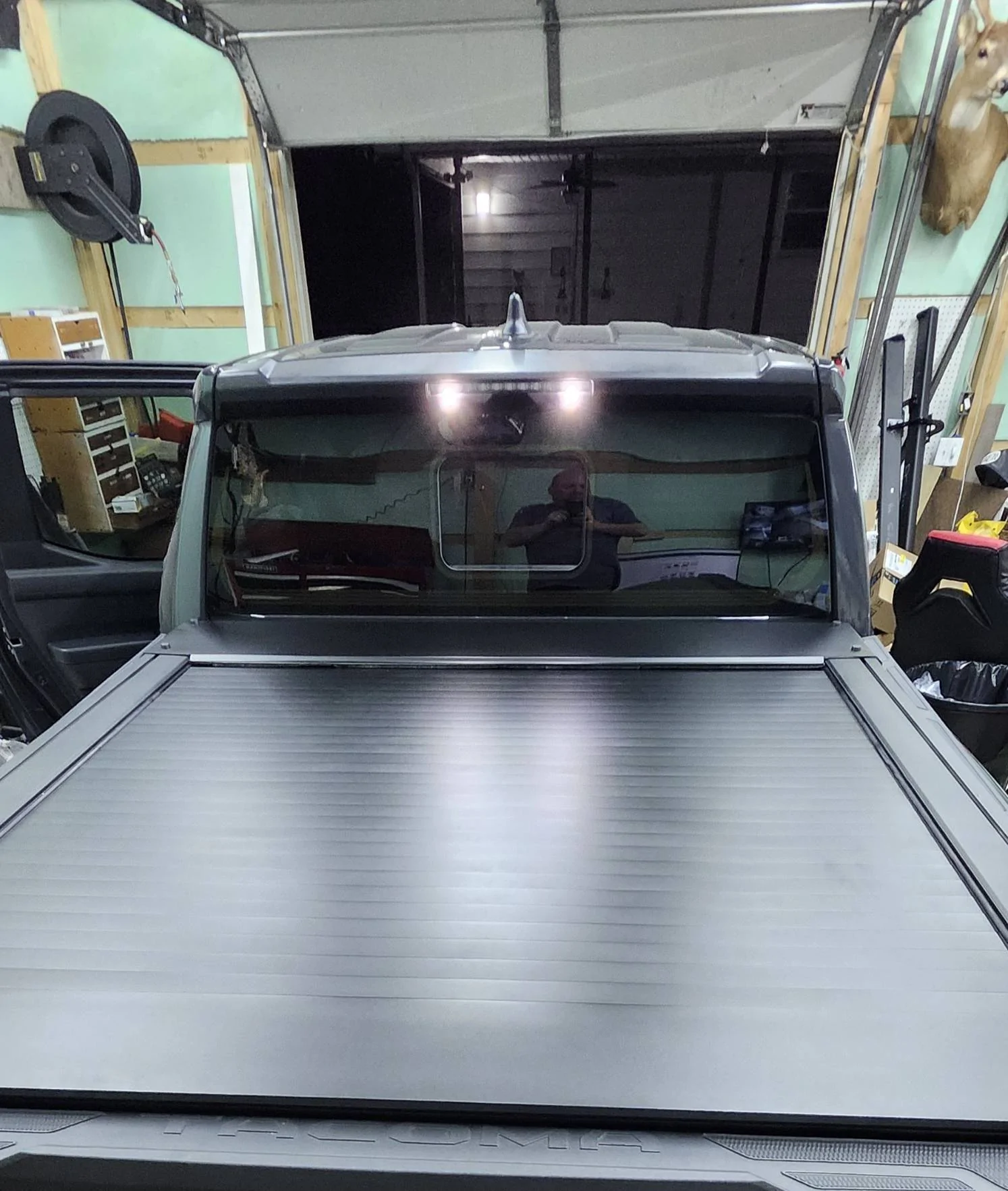

Nice. My son got his taco last 2 weeks ago. Tires are not on the list but a leveling lift kit (if I can find one) and tinting the windows are the last two things to do.
He is in the sheet metal union so he needed a locking hard cover. Turned out great.
