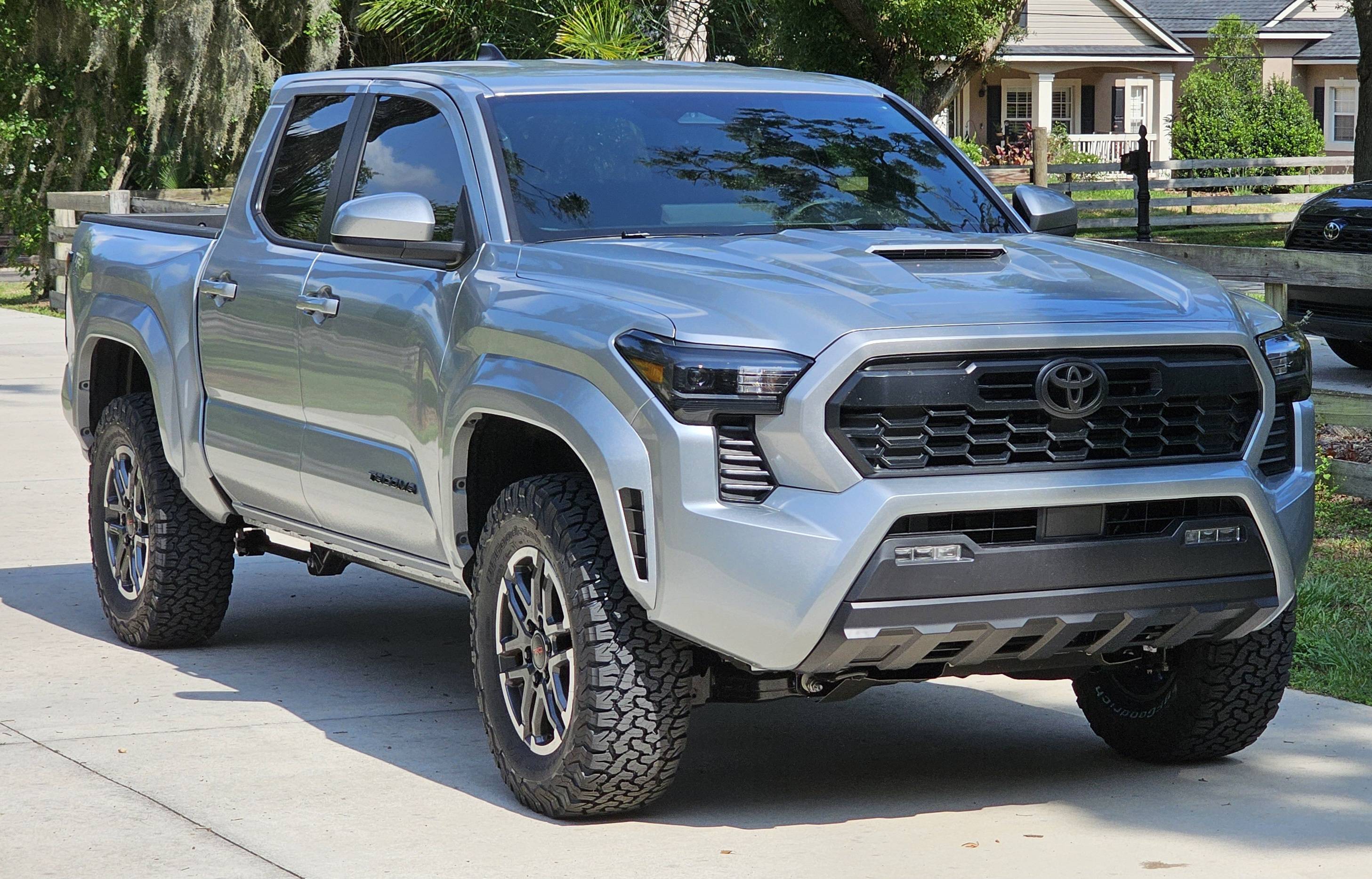

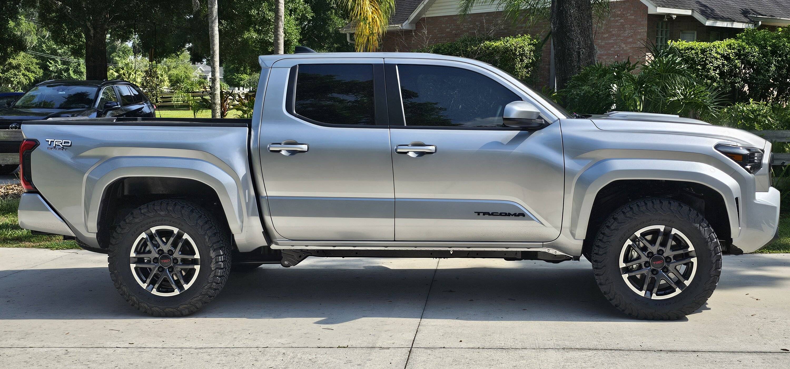

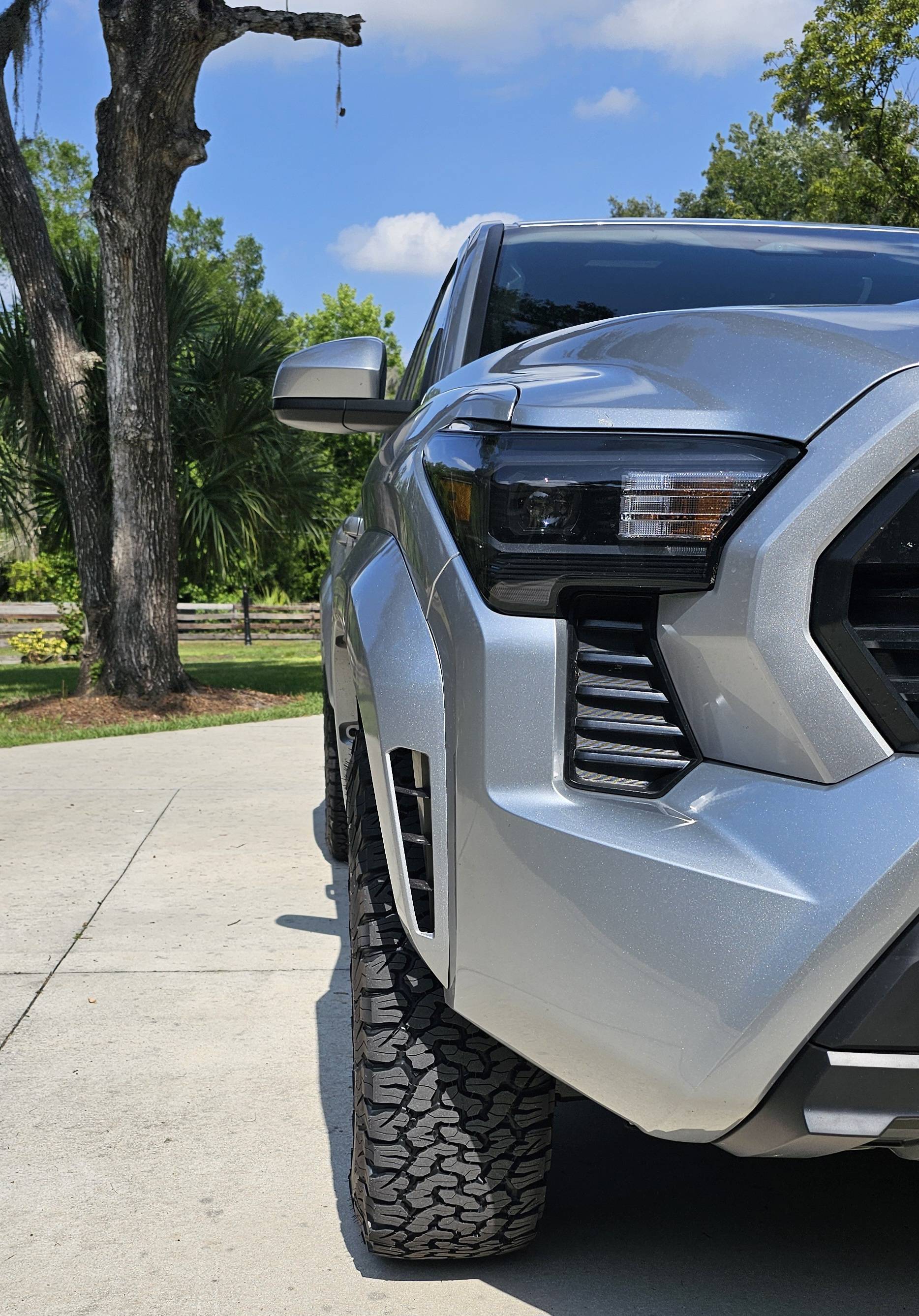

I only saw one other post with 285/65R18 BFG KO2s so I thought I'd share mine also. I can confirm no rubbing and a smooth ride.
I plan on adding the black XP wheels once they come off of backorder. They have a 45 offset and 8 inches wide vs the stock is 55 offset and 7.5 inches wide. That should give it close to 3/4 inch more poke. Which I think will be perfect for someone who doesn't want to go too far out.
2024 Tacoma 285/65R18 BFG KO2 tires on stock suspension (2024 Tacoma TRD Sport) 1000018581
2024 Tacoma 285/65R18 BFG KO2 tires on stock suspension (2024 Tacoma TRD Sport) 1000018582
2024 Tacoma 285/65R18 BFG KO2 tires on stock suspension (2024 Tacoma TRD Sport) 1000018580

Ride is slightly more bumpy on unsmooth roads, but not enough that the average person would even recognize. The steering actually feels better. Almost like the steering wheel tightened up a bit. So overall looks better and drives better IMO.

I like that look for offset / poke but the black wheels do look better - especially on silver

Man idk why but a 285 just doesn't look as wide as I was hoping on these trucks. Maybe it's the stock wheel width. Other then width it looks good filling up the wheel well. Hopefully my 18x9 methods will make the 285 look a bit wider. I think a 305 will be overkill

45-35 offset will make it look wider. It's just tucked to tight right now
