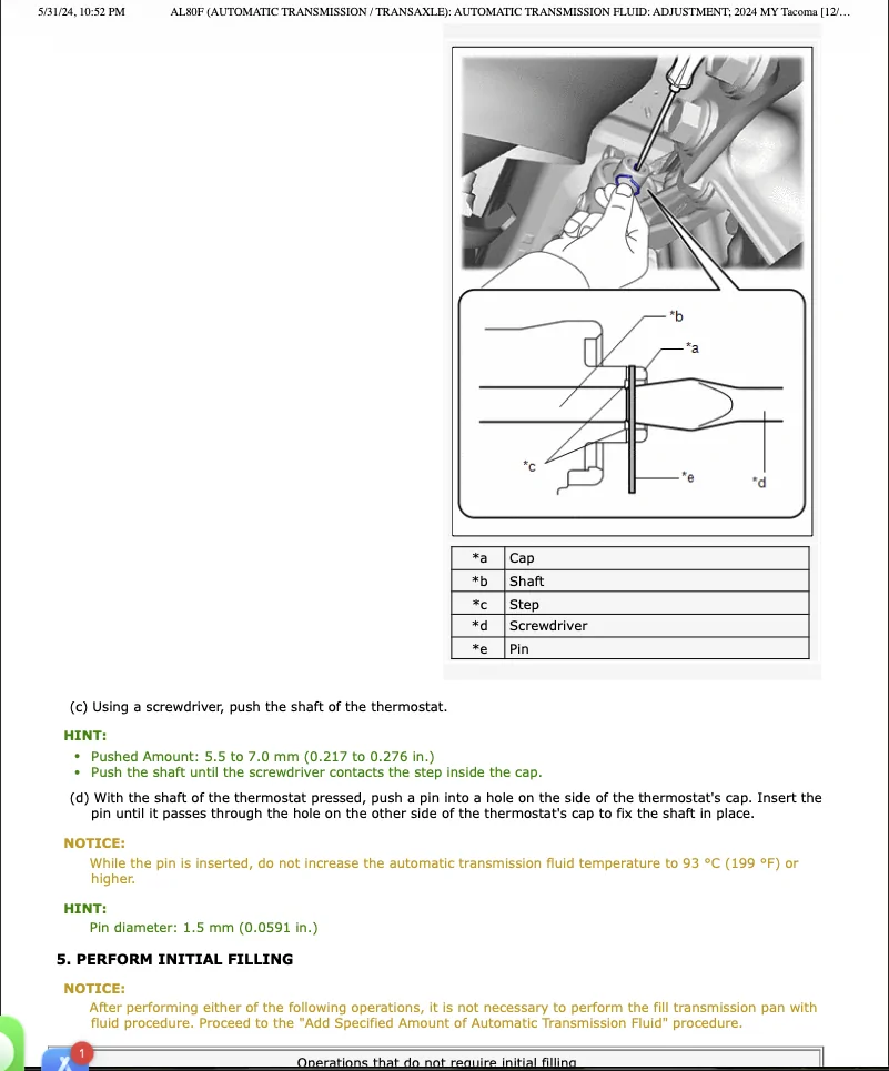

None of this is in that video. If I'm gonna jack w/ transmission fluid, I want to know exactly...
2024 Tacoma 4th Gen auto trans drain/refill procedure pdf Screenshot 2025-11-28 at 10.02.09 PM

Interesting this implies the transmission thermostat only opens at 200F. Seems like anyone running a transmission cooler may be running their transmission too cold, below operating temp. So you'd have to set the thermostat on the transmission cooler to only open above 240F.
