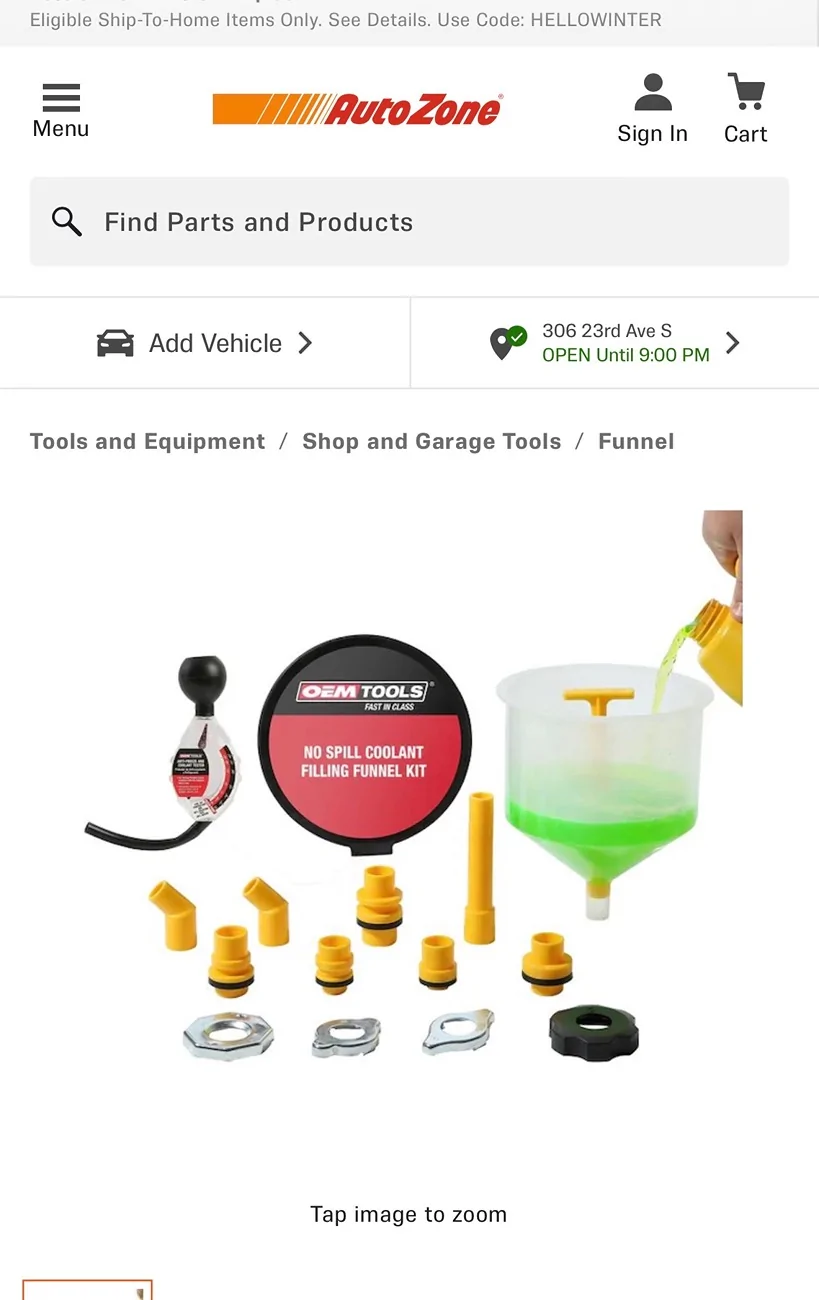

Ive always used one of these buckets funnels that seal to the radiator cap. Fill the funnel with coolant, pull the plug on the funnel....open the petcock, let it drain while keeping the funnel topped off, and from emptying completely. You do an air free exchange of old/new fluid in the radiator. Fool proof.

Thank you for the reply. I have that exact tool I used on my Honda Civic with the universal adapters. I was mainly concerned because of the electric coolant control valve on the new motors. I don't know if there is a special procedure to open/close it for refilling. Also, I don't see a radiator cap under my hood, just the coolant overflow reservoir, which does not appear to have a pressurized cap.
