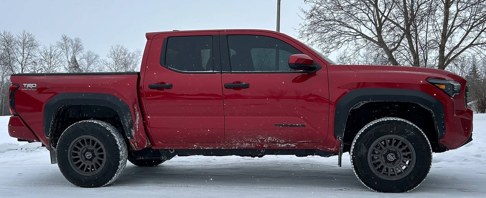

I’ve been running the Peak Suspension 1.25” leveling spacer for about a month now. Truck drives and rides great.
