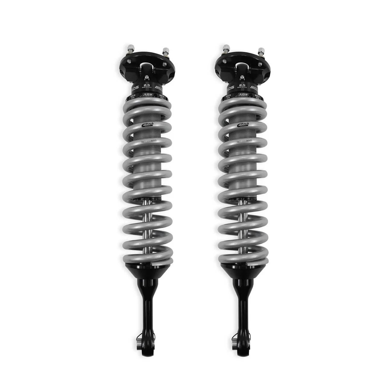

Eibach has 2 inch mono tube all around and an upgraded monotube up front and resi out back.

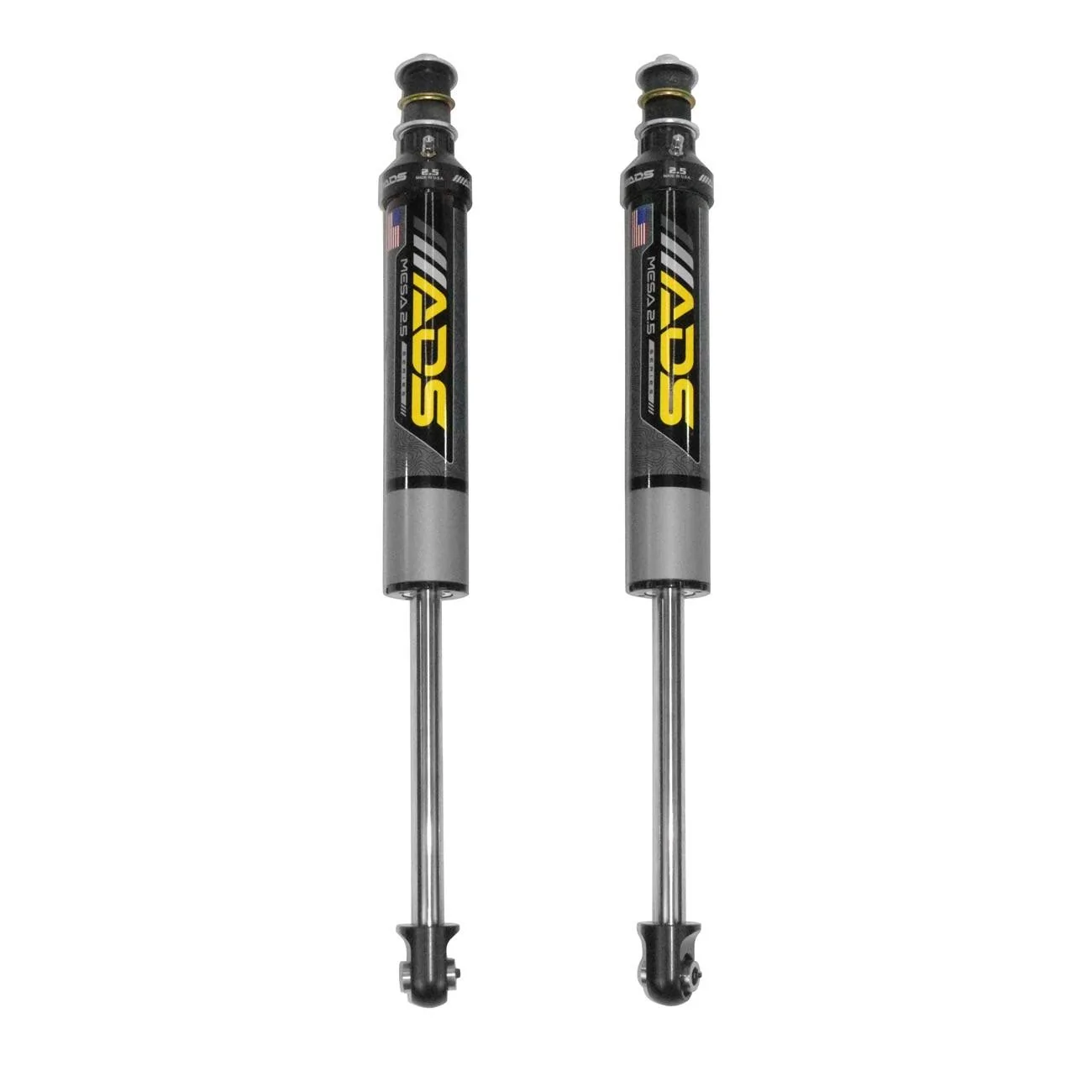

The ADS MESA Series offers a front coilover with an IFP 2.5 Shock body, and a IFP 2.5 Shock for the rear. This provides increased fluid capacity and resists shock fade, resulting in increased performance.
Additional Features:
  • Black anodized billet aluminum top and bottom caps
  • 0.875-inch diameter Hard-chrome plated steel shock shafts for superior corrosion resistance
  • Fully rebuildable
  • Made in America with American components

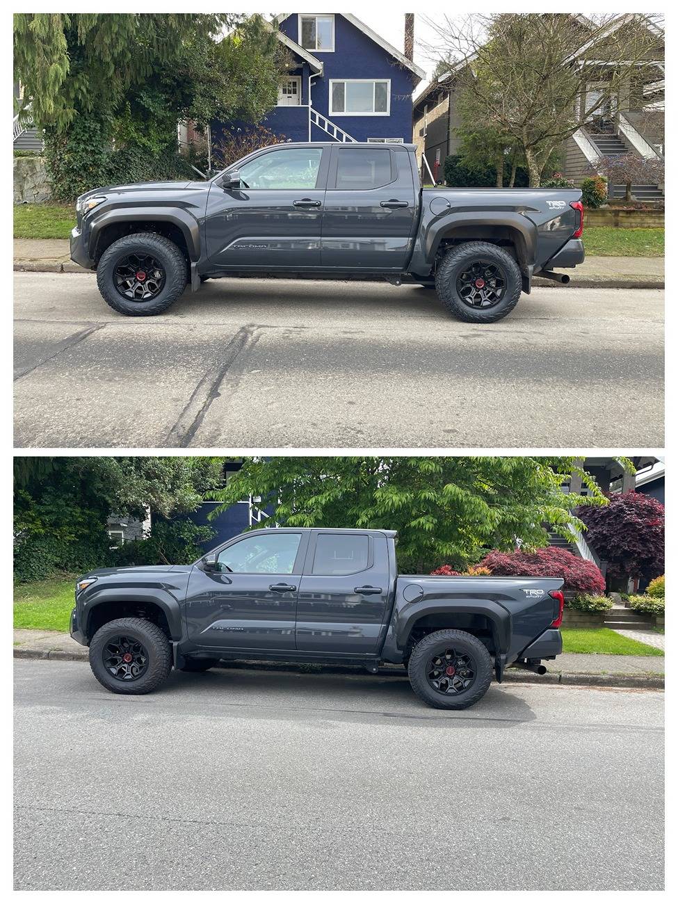

Here is a before after picture of installing a rough country 1.5" levelling kit on the front of a 2024 tacoma TRD sport. Stock rear suspension.
Make sure to get an alignment afterwards. The camber and toe were out pretty far.

I ended up getting the Eibach coilovers with reservoirs and the bumps and turns are so much smoother in my offroad. I still need to adjust the front to level out the front. The back is still 1" taller.

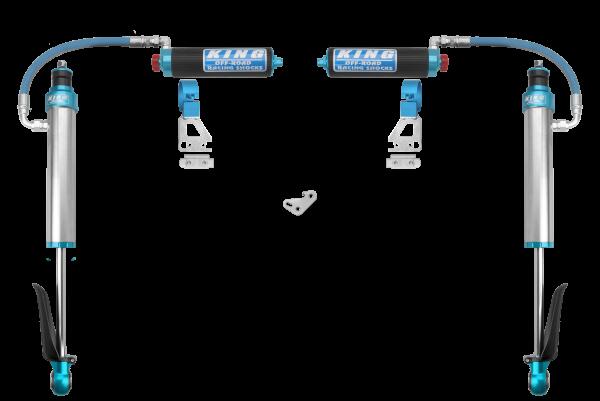

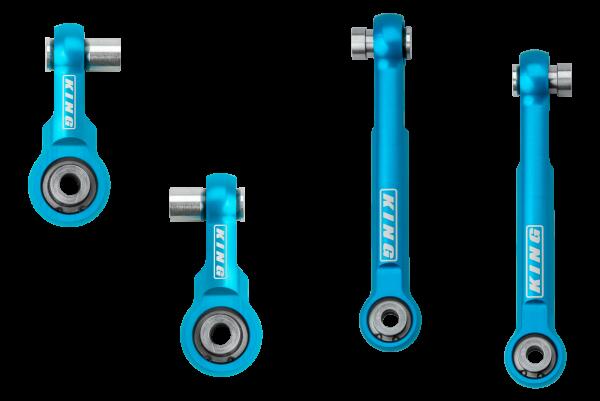

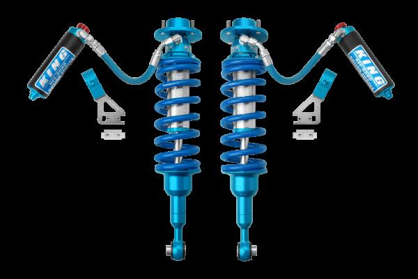

I had the $500 Westcott kit for about a month. I was not happy with the ride and had it removed.
I bit the bullet and had a complete set of front and rear King 2.5 shocks and sway bar links installed. The shock upgrade made a night and day difference in the ride. Buy once, cry once.

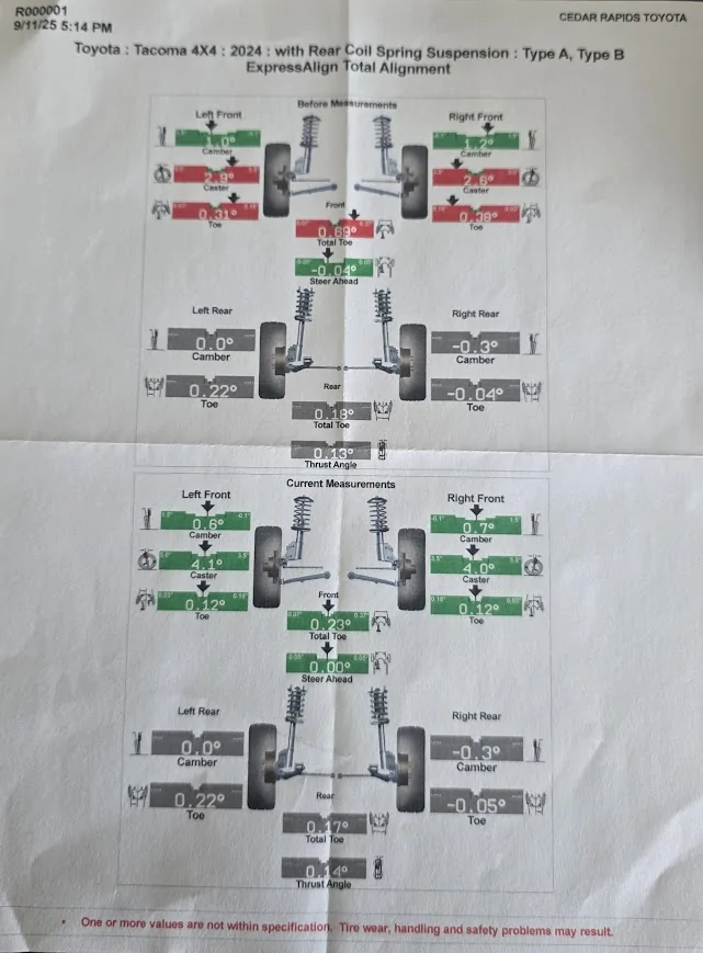

I put the RC front 1.5” leveling kit on mine. Easy to install and looks good. I did have it aligned afterwards to insure it was good
Do you still have the alignment sheet of the before and after numbers?

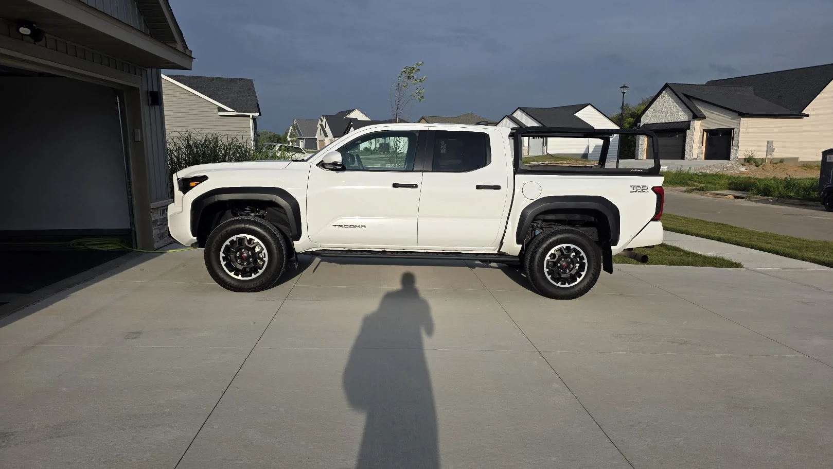

All dogs spring kit was perfect for my needs. Takes maybe a couple hours to swap the springs, and then get it in for an alignment because wow it was off. Factory tires still on, frame sliders do kind of make the truck look lower so worth taking into account visually.
