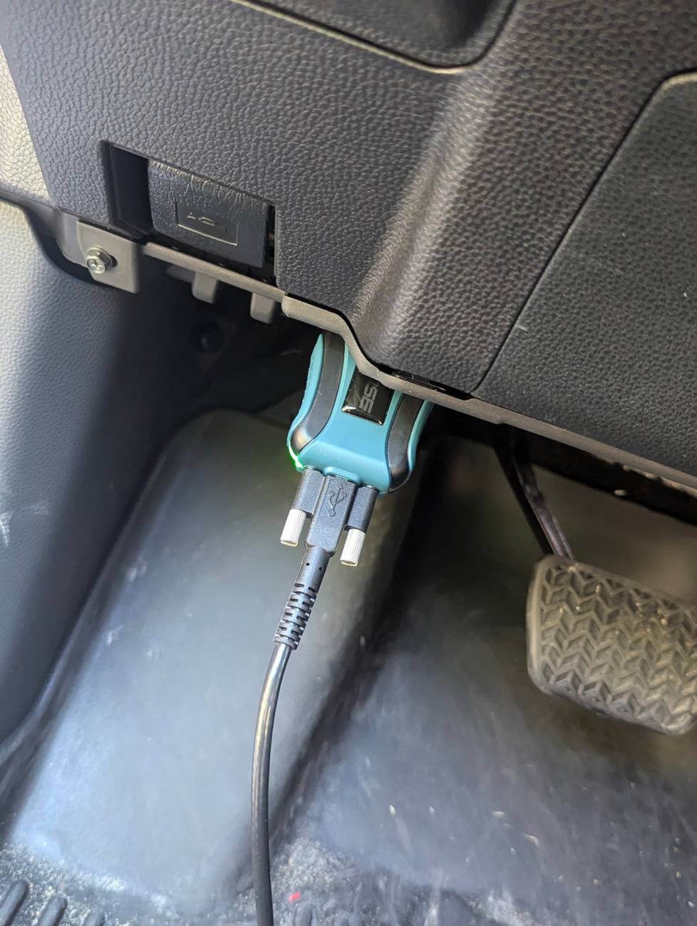

Now, as with all Techstream installations, you'll need a compatible MFC VIM J2534 cable. I used the Drewtech Mongoose, which is the one that Toyota recommends, however, I know some people either run the knock-off Chinese ones or the Tactrix Openport with the older versions of Techstream with no issues. I can't confirm if these will work with Global Techstream Plus, but I have a hunch they will.

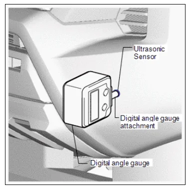

The Park Assist system is completely separate from ADAS. It consists of the parking (ultrasonic) sensors. ADAS uses the radar in the bumper and the camera in front of the rearview mirror.
In previous years, you could just replace parking sensors willy nilly. But now they require "programming" if the serial number changes, requiring you to input the angle of the sensor when programming it. The tool I used is pretty much exactly what they use at Toyota to calculate this angle. It's done by first verifying the ground is flat (per Toyota, within 0.2 degrees on sides/back/front of the vehicle) and then measuring the angle of the sensor.

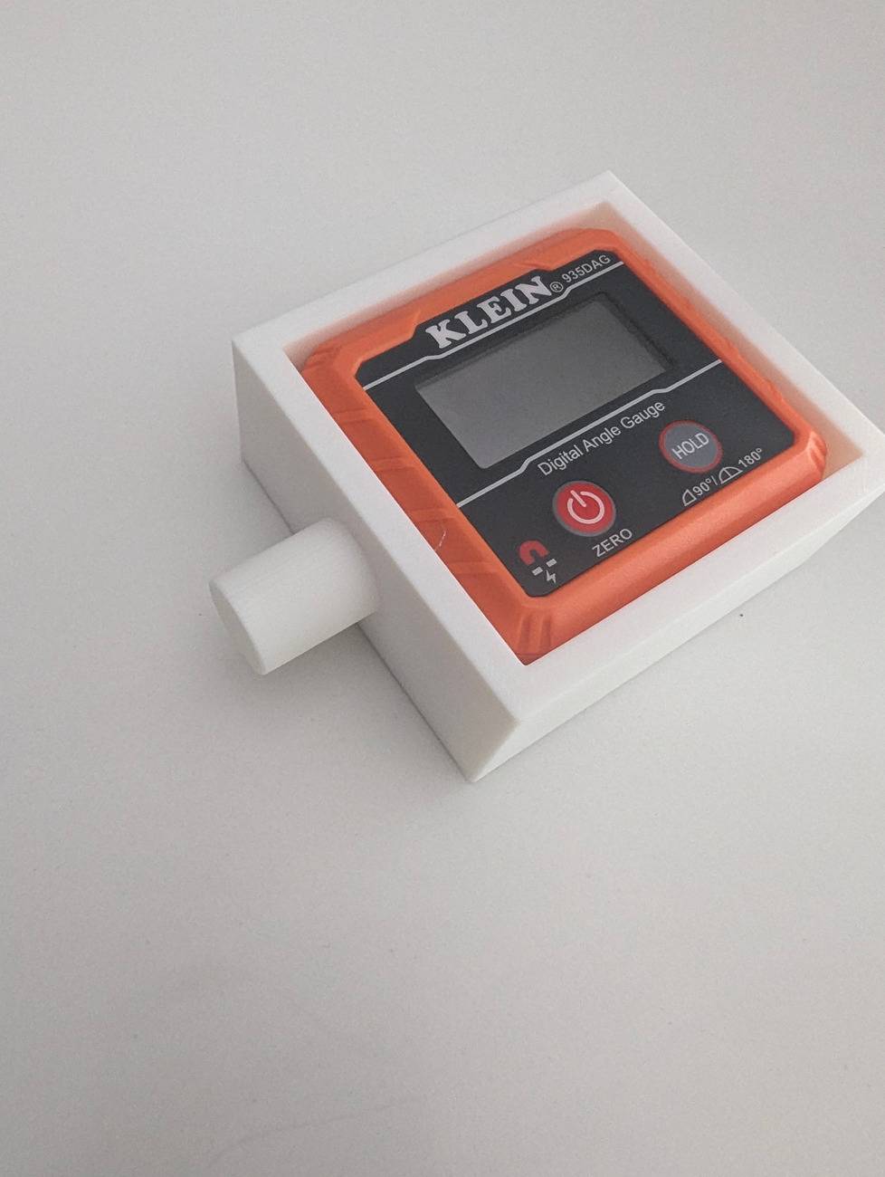

This is Toyota's "measuring device" - it's literally a digital angle gauge with an "attachment".

I have the newer DrewTech Mongoose-Plus Toyota 3.
I've heard of people using the generic ones, but technically you're doing so at your own risk, as they're not Toyota approved. On the flipside, I haven't heard of people bricking their Toyotas with the generic adapters, albeit older generations.

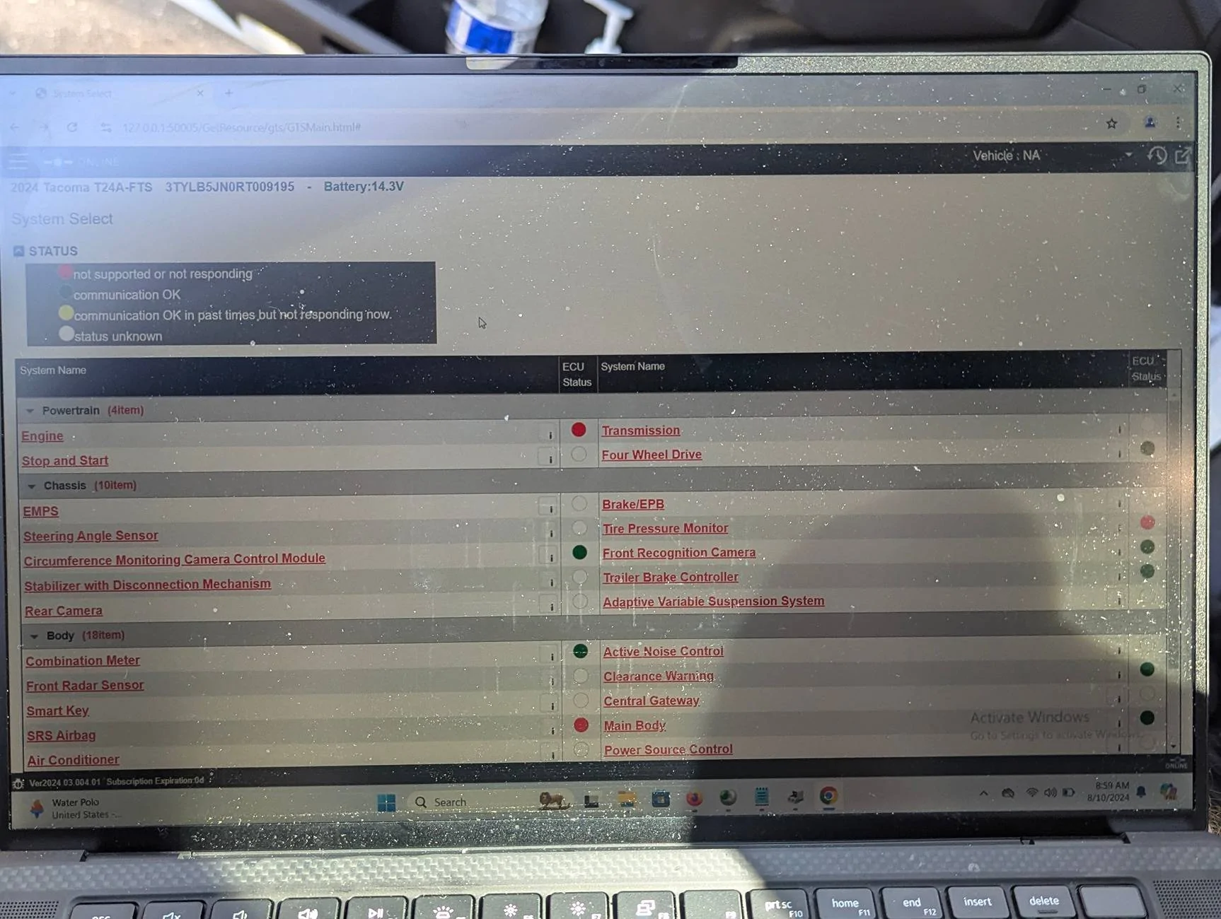

What issue are you trying to solve ? If it's the ADAS system, I personally wouldn't mess with it. But it seems like from your other post it has to do with your USS sensors - which would be the clearance warning system.
Are you able to run a scan and post your DTCs here? We should be able to figure out what needs to be done via TIS.

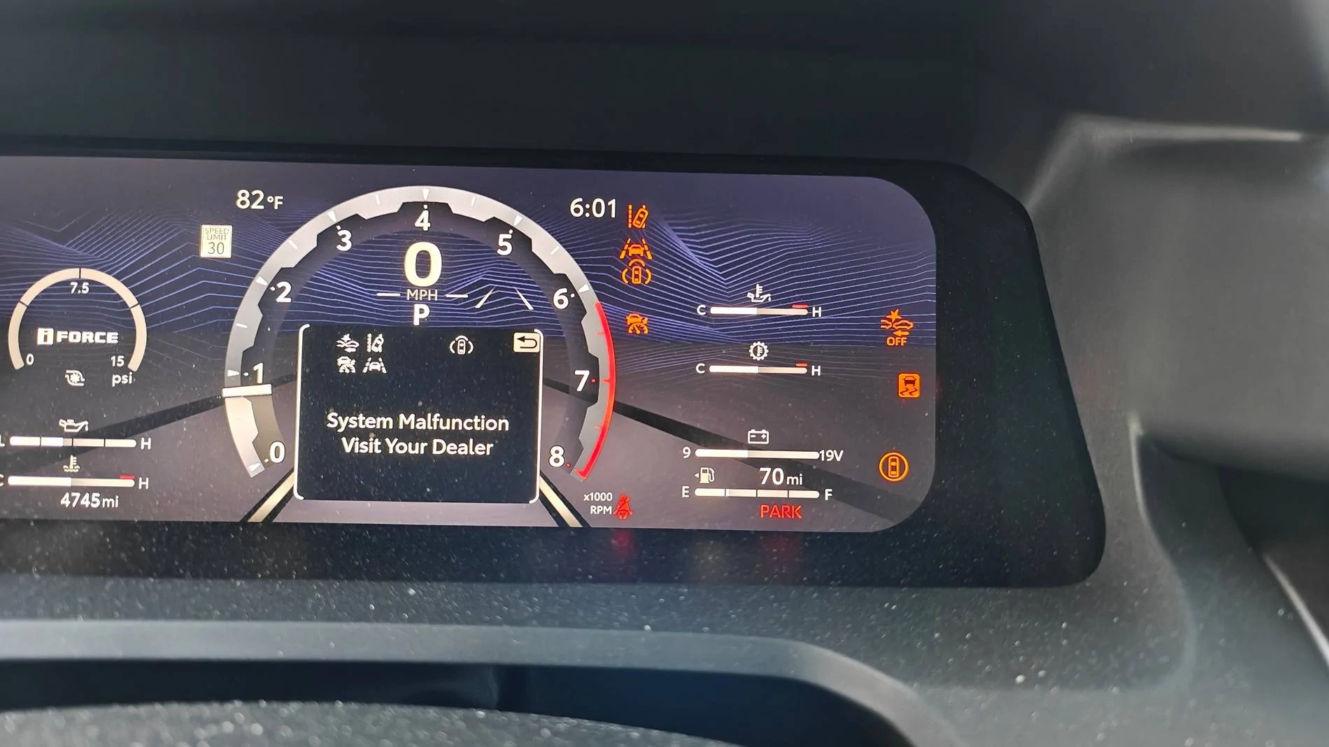

That's correct, it was showing the ICS which are clearance sensors. I deleted that message but still have the malfunction on the dash (see screen). How do I find dtcs? I could not find any codes.

I don't have access to the software anymore but there should be an option to run a full scan and pull all of the DTCs.
But if you're sure it's clearance warning just select it from the systems menu and it should show you any active DTCs.

I ran a health check and showed 0 DTC. I then started looking at the (RoB) Vehicle Control History and noticed that at the same time I started getting the malfunctions after self performing alignment prior to going to the shop, it said "Zero Point Calibration of Steering Angle Sensor Malfunction". I started looking around the "EPB/Brake" system since that's where this RoB came from.
Finally I decided to risk it and resetted the memory in the EPB/Braking and thought I really screwed up because I got like 10 more malfunctions when I took it for a drive. I then performed a "calibration" in the EPB/Braking and this resolved all issues! Everything works as it should when I tested it. Looks like the calibration in the EPB/Braking does more than just braking. It also does steering, front radar level, and probably some other stuff.
It was nerve-wracking but worked out in the end. Thanks for your help!
