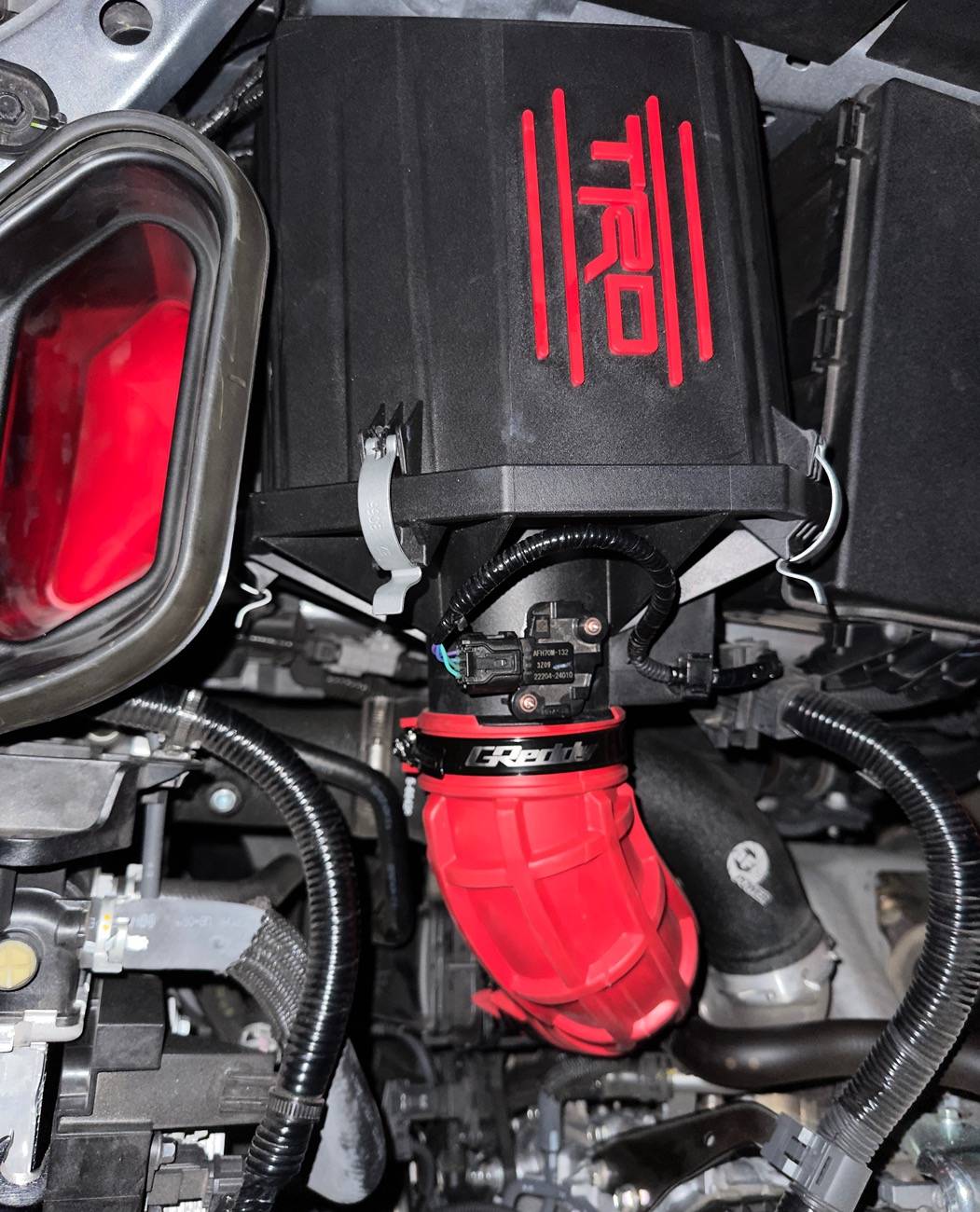

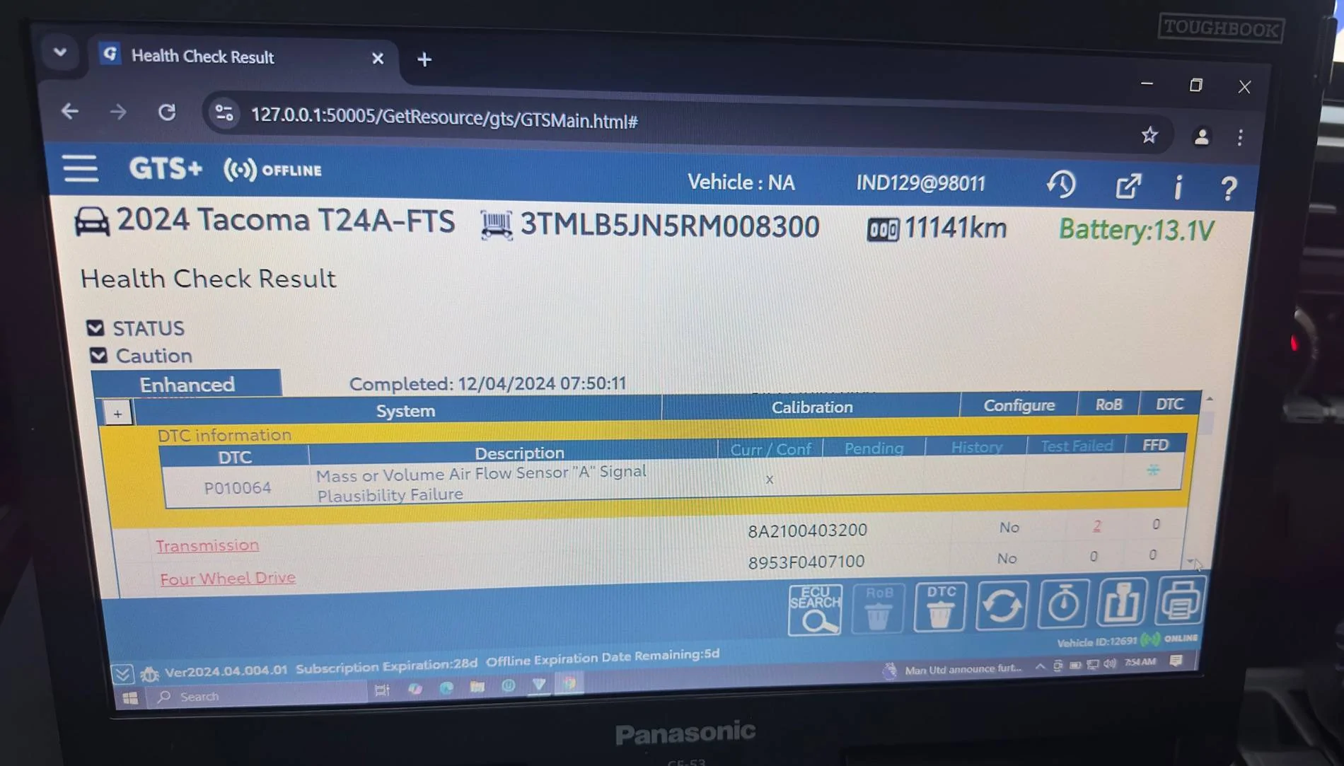

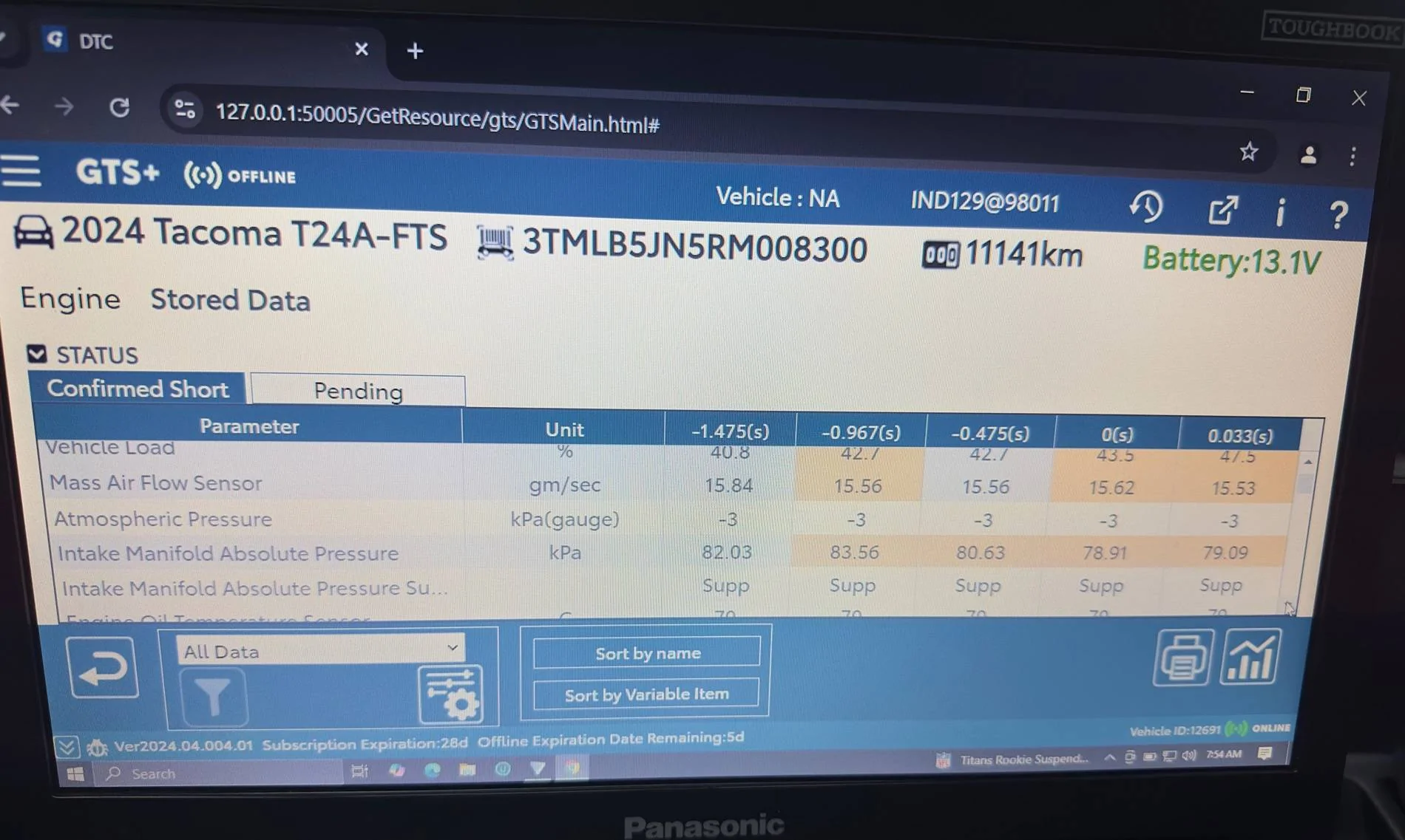

4th gen Tacoma offroad non hybrid has maf sensor issue when running the new trd pro air intake?
it will get a lean bank 1
Traction control turns off
Secondary collision braking will turn off
Engine start malfunction
crazy
but when running the stock intake it all goes away..
cleared dtc but it comes back after a short drive tried reset the engine learning value but after a drive it comes back.. changed it back to the stock box everything clears itself and nothing appears with the stock intake and nothing comes back on again..
this is crazy looks like I will not be running this intake box for awhile
