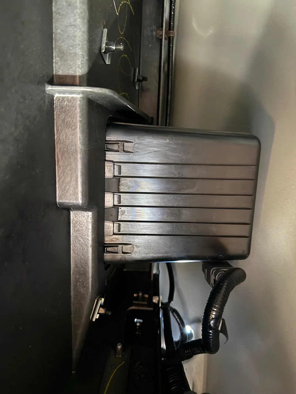

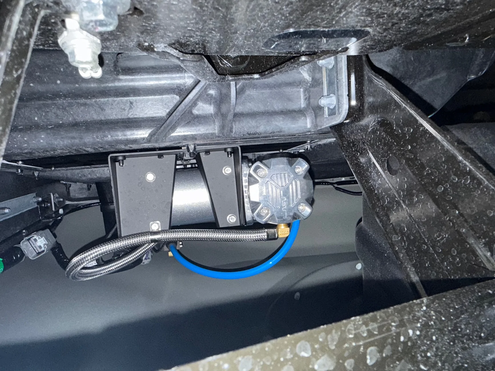

Thanks for the links. This is what I have been wanting to do. I would rather do aftermarket than OEM. OEM would have to stay in vehicle permanently vs move to another vehicle But the way yours is mounted gives the user easy access without having to open the hood. You said that you missed then mounting originally and had to redo. What caused the miscue? Thanks Trying to get it on the first try.

I just miss measured clearances. It is a small space and the double compressor takes up a lot of the available room. I didn't account for something, I cant even remember what it was. It you take your time I am sure you won't have a problem. I tend to move a little too quickly.

Are there any measurements or guide to make it easier ? My install area in mind is the area where the OEM compressor is installed. I will keep you posted Thanks for your help.

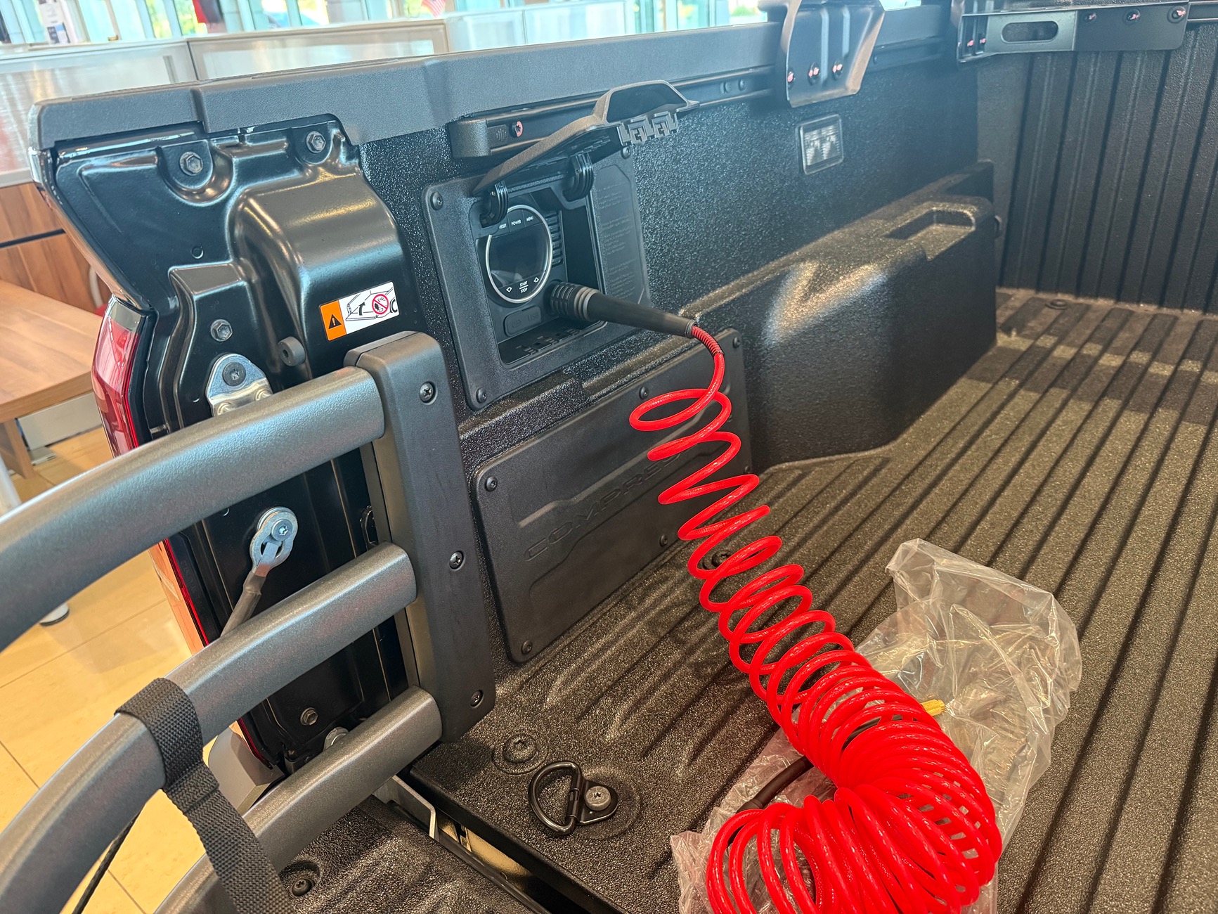

Was there anything blocking the air chuck line between the truck bed side and the outer bed skin? The line going to the data box. Thanks
ChesterCopperpot
Perry
Jun 13, 2024
19335
2024 TRD OR Hybrid
No the data box is completely exposed. You can just stick your head under there and see what is going on.

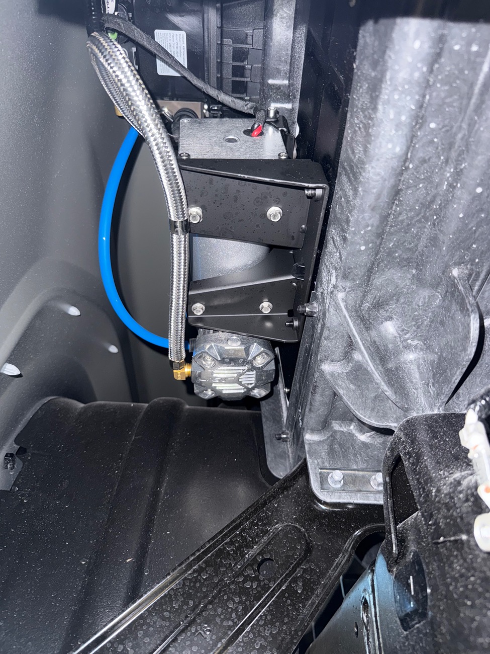

Great, I was reading someone's install that said that they had to scratch that because they weren't able to have access due to something in the way. Now I see that it will be ok. I have a better idea of where to mount the bulkhead. Thanks
(side view looking towards the rear)
2024 Tacoma Air Compressor Installed IMG_4562
(Bottom view looking up)
