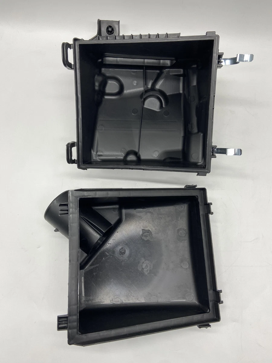

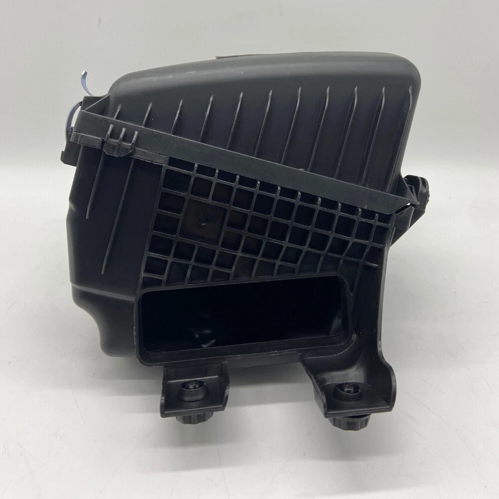

This is a regular Taco air box (image stolen from an eBay listing):
2024 Tacoma Airbox mod (Trailhunter)? {filename}
The bottom half of the air box (the "dirty" side) is on the top of the image. There are a couple spots where holes can easily be added for more air flow. I'd probably go for the front or right of the air box (facing up or right on the image) to shield it from road debris.
Adding holes to an air box is an old school technique for more intake flow, at the expense of some extra dirt or water intrusion. 1st Gen Tacos/3rd Gen 4runners did this with a boat "deck plate" on the front that could be sealed for dirty or wet trails. I did this on my old 4runner and it added more throttle response, and a lot of cool intake noise. I also had a fine mesh screen backed by hardware cloth to prevent debris or critters from getting in the air box.
There might even be room on the new Taco air box to add a 3" or 4" deck plate on the front:

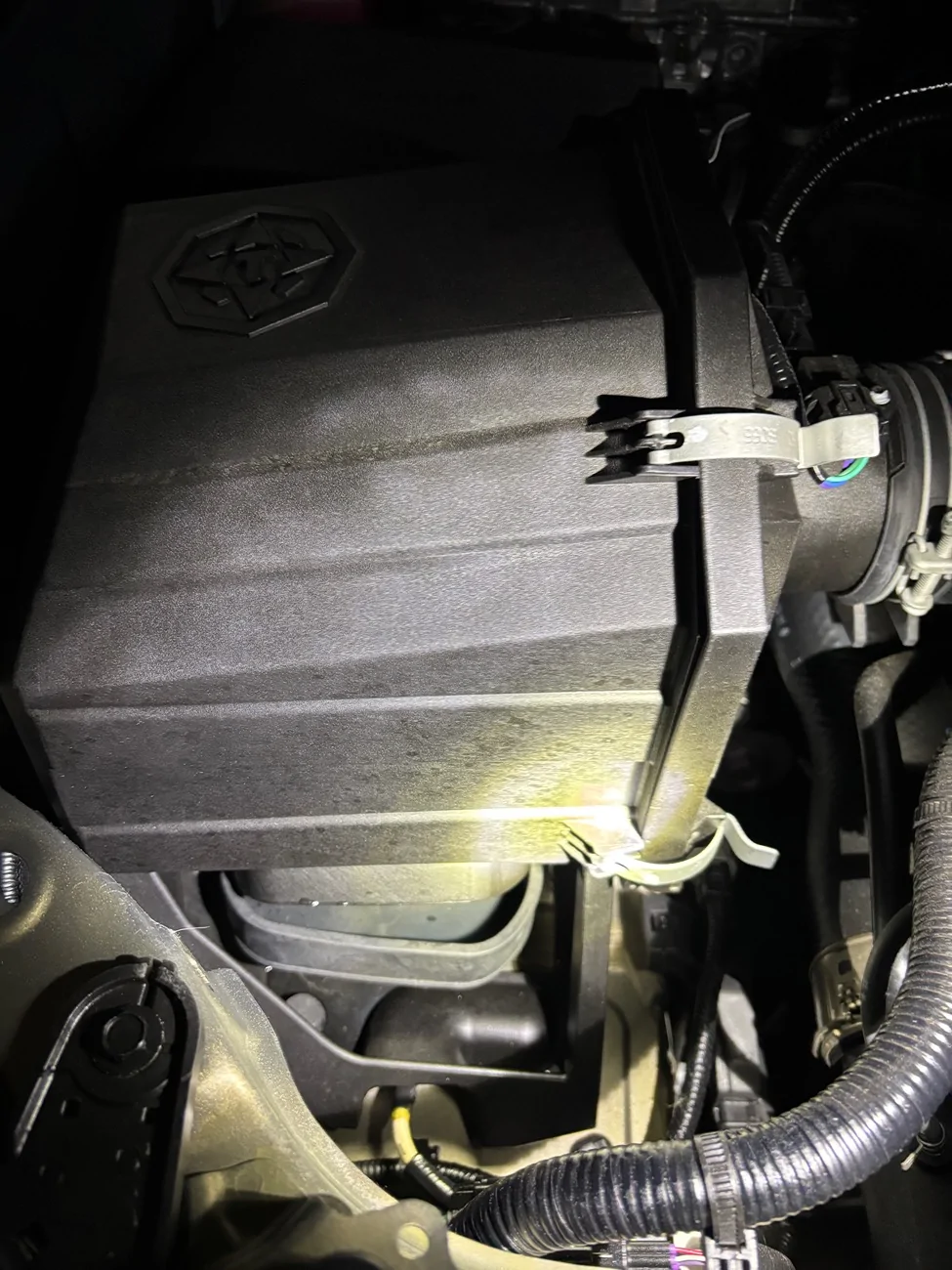

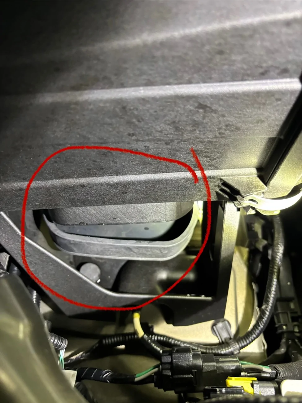

Yes the Trailhunter has this rubber plug. I would have thought that it would have been the same air box with non-Trailhunter/snorkeled trucks with the snorkel intake plugged and lower air box with a duct to the front, but it appears to be completely different air box. Which make me wonder why it’s there?
2024 Tacoma Airbox mod (Trailhunter)? IMG_1462
2024 Tacoma Airbox mod (Trailhunter)? IMG_1463
Yotota
Zane
Oct 10, 2024
297
279
SW WA
24 TRD
It's there because that is the TRD intake and air box, which is also used on non-snorkel trucks like the TRD PRO or any other Tacoma. So there are two air hole options on the box.
