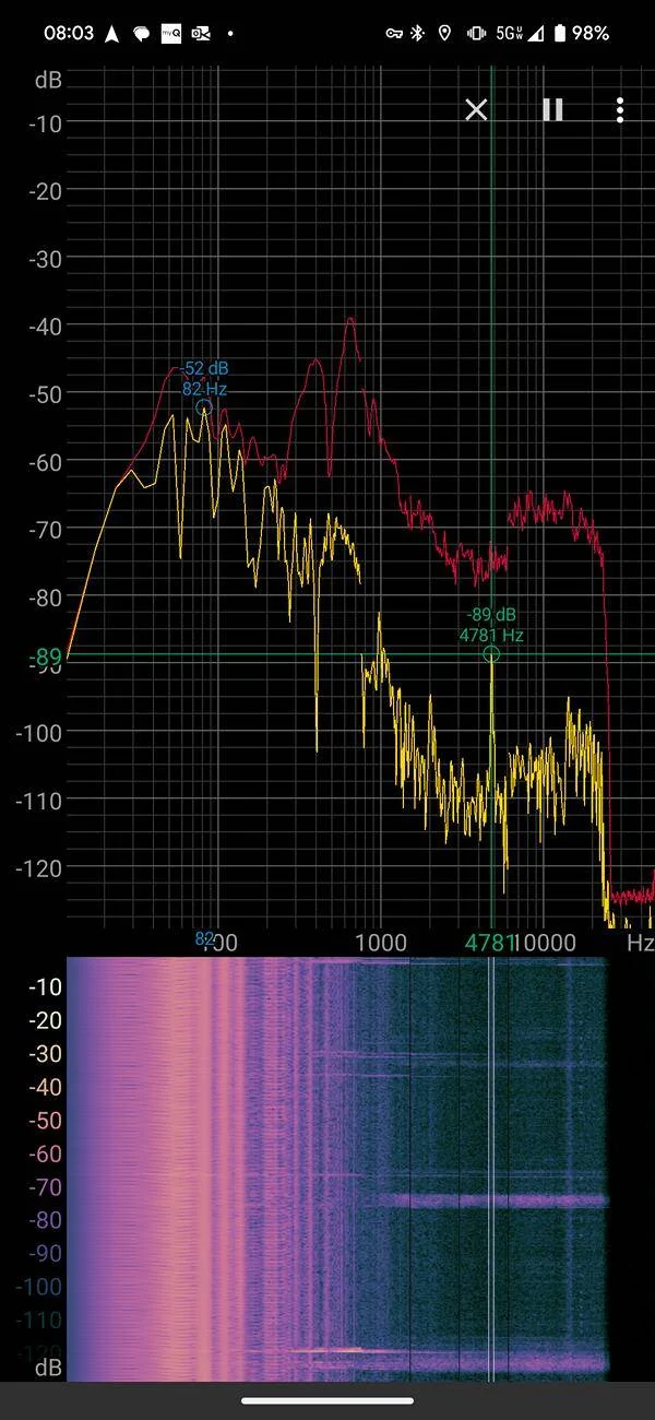

If you want, download an app like specdroid (or any FFT app), and you can easily 'see' the noise, even if you can't here it (note the location of the green crosshairs)
