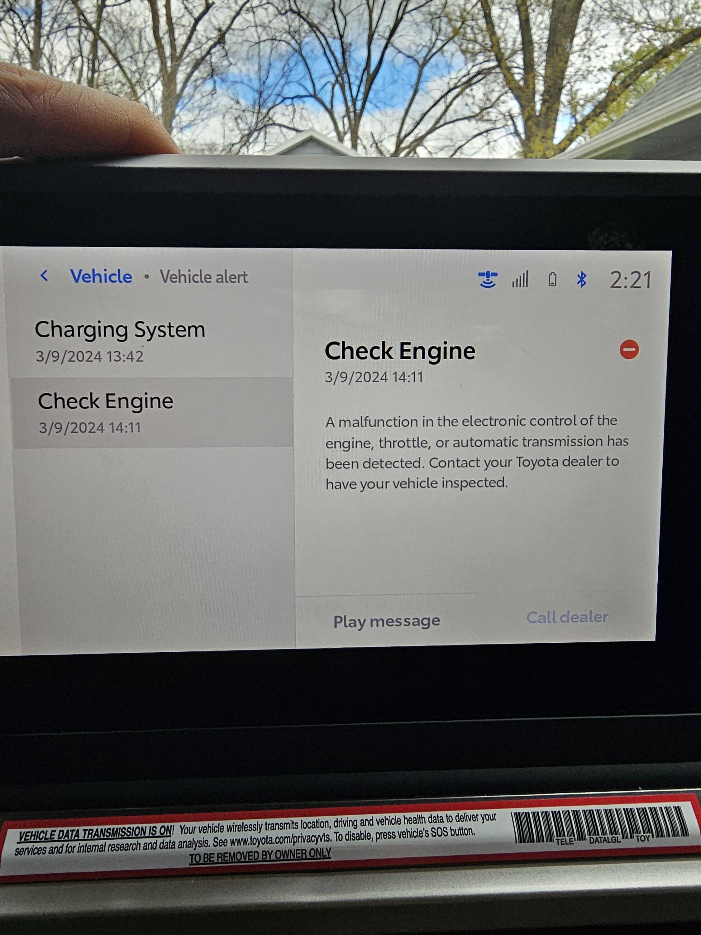

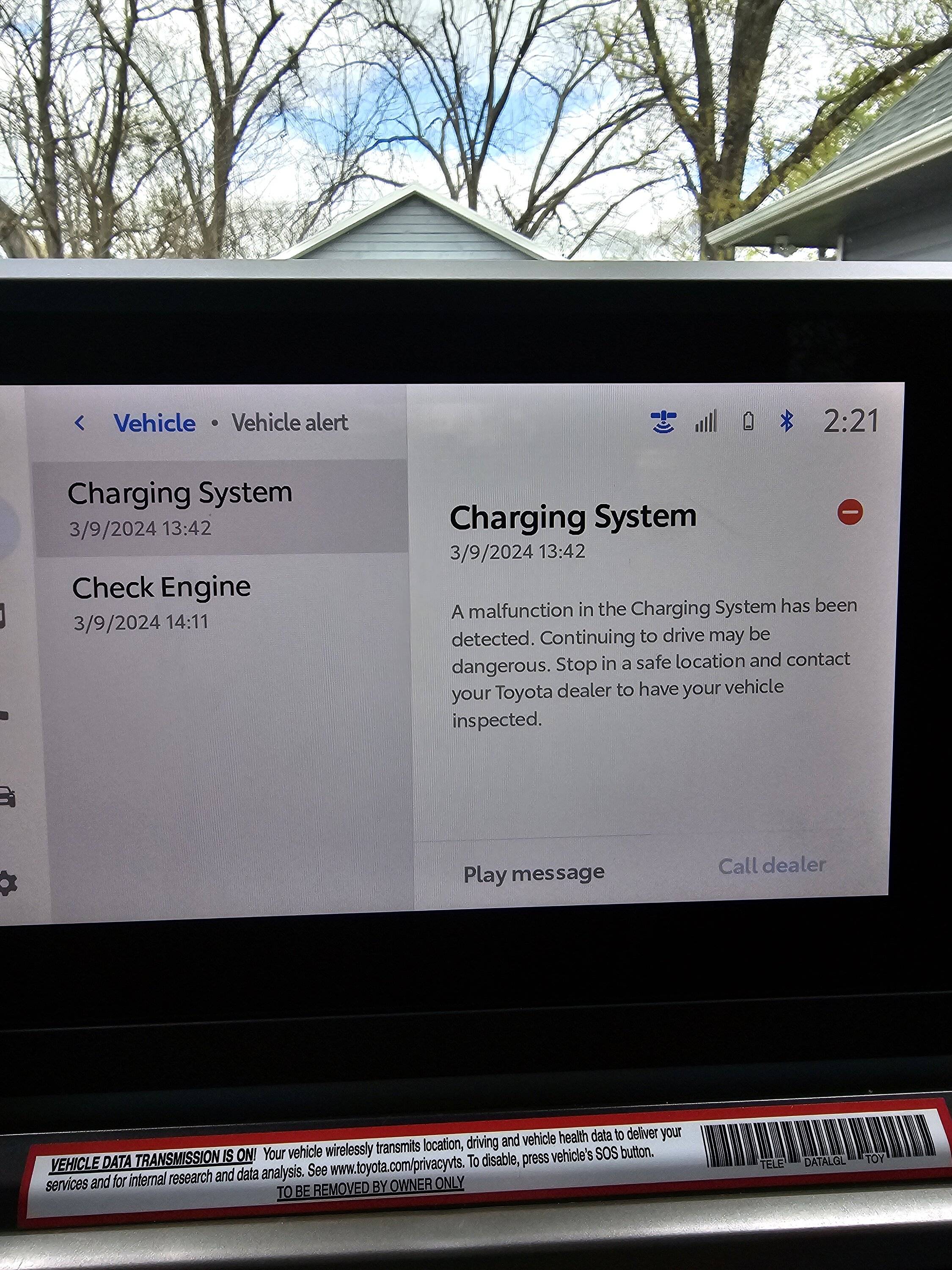

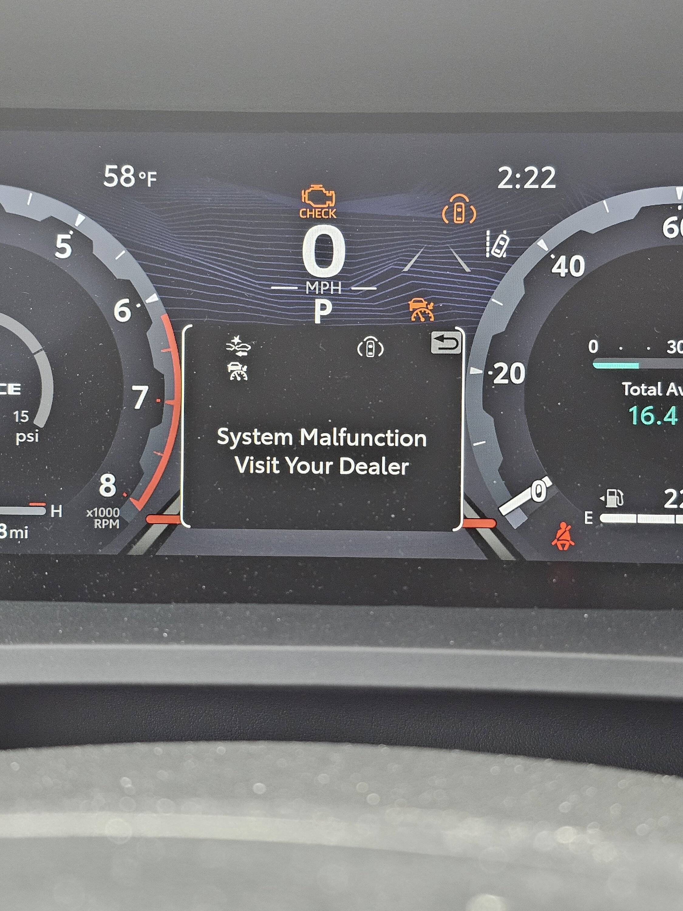

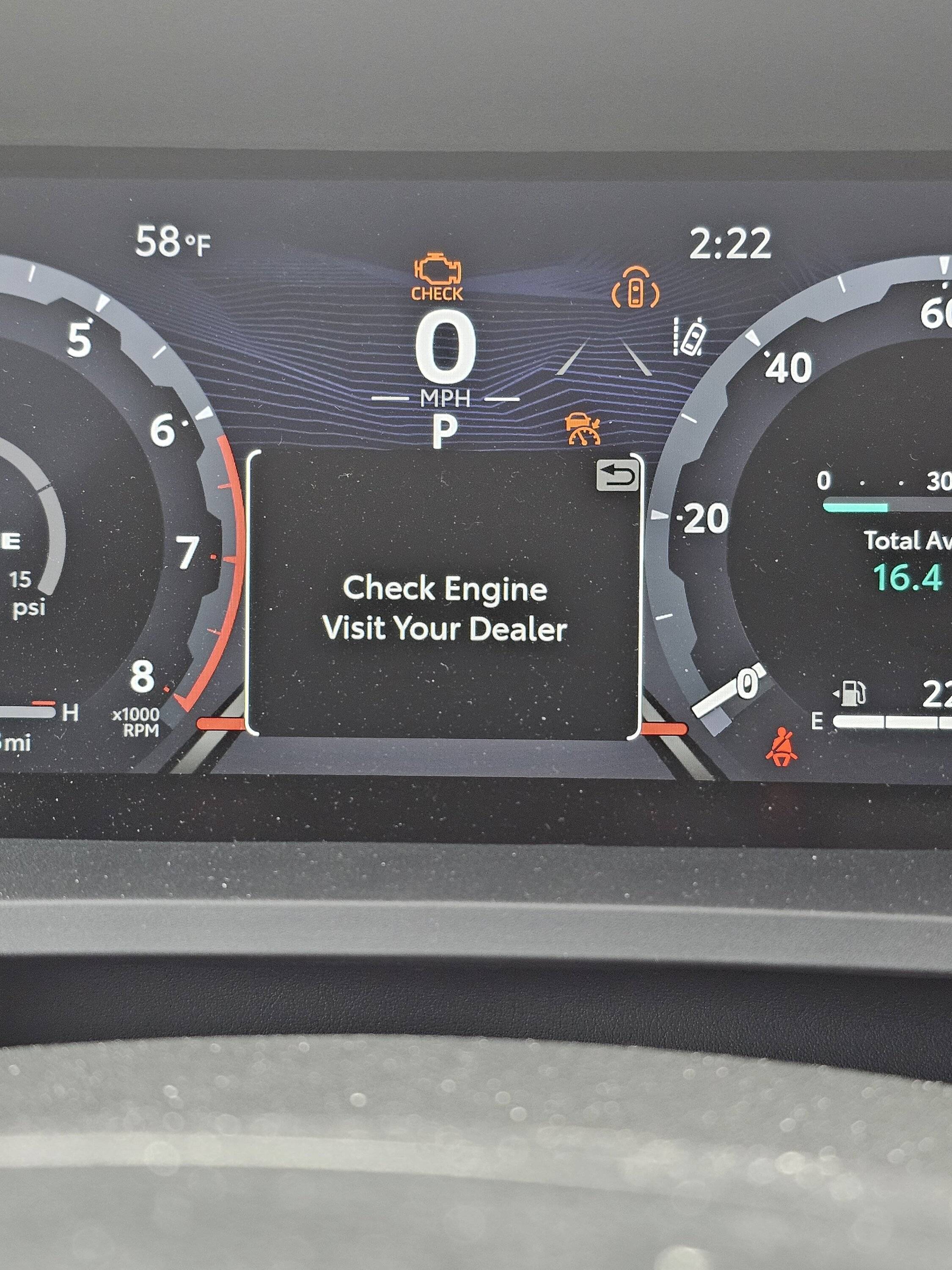

600 mi and the check engine light came on, really not pleased. I'll be going to the dealership Monday I'll give enough date as to what they tell me

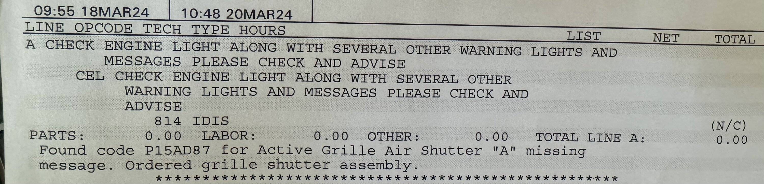

Here's a little update on my grill shutter problem. They have ordered the part. ETA up to 2 weeks. Shutters are stuck open and they suggested I just drive it for now which is what I'm doing. No way I'm leaving it in their parking lot that long. Spring in Oklahoma=Hailstorms. The error code leads me to believe the part failed or the connecter is so corroded it's not getting power or signal to open close at all.
