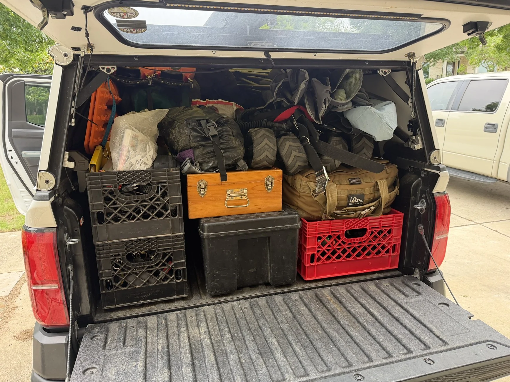

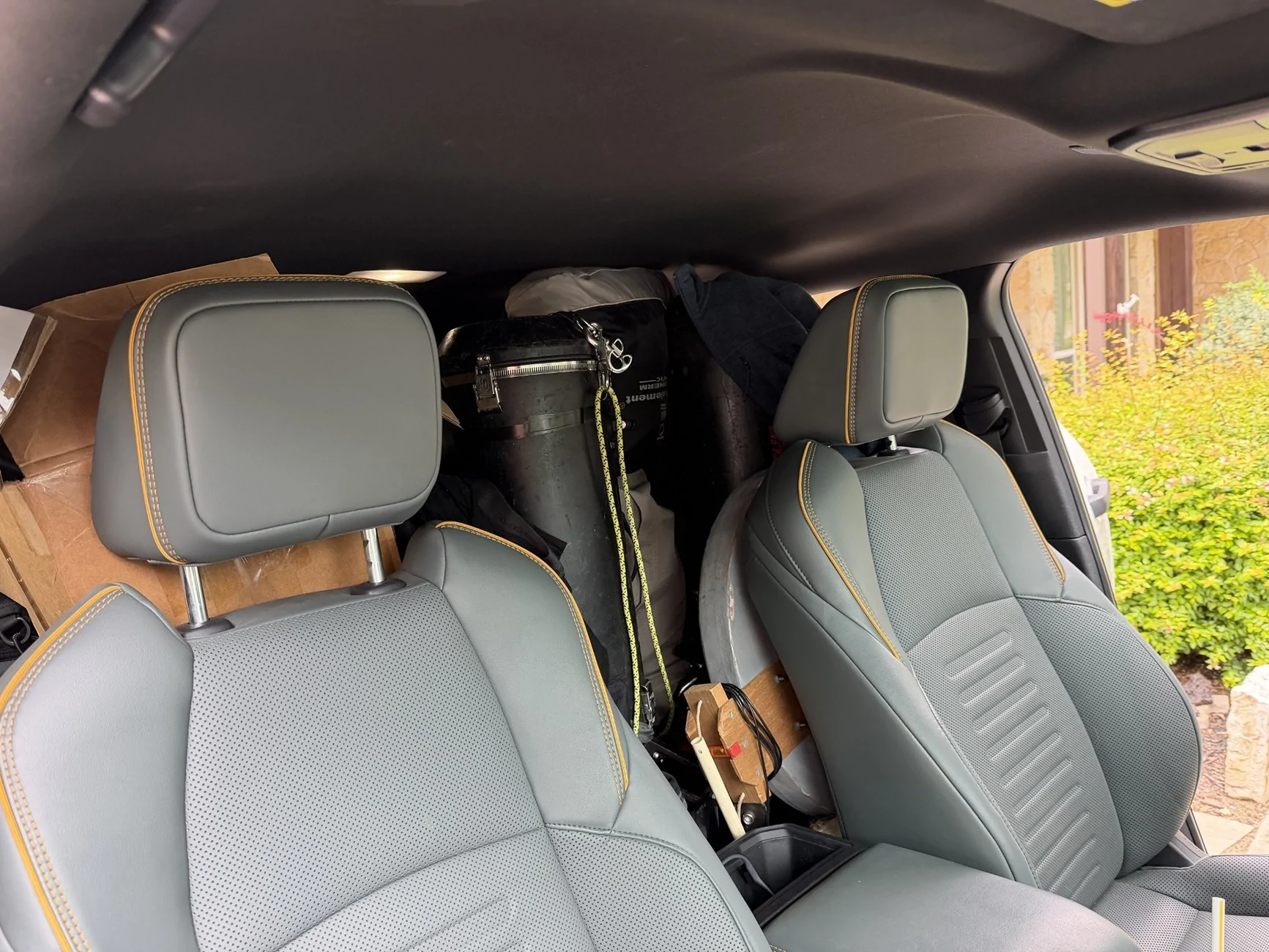

Follow up, I installed them, and they work fantastic. I loaded the truck up with 800 lbs of dive gear and drove from Tennessee to Mexico, and only bottomed everything out once or twice. I found that with the truck empty and 16" of ground to hitch space, with the truck loaded like this, I needed 50 PSI in the bags to regain 16" between the ground and the hitch. One thing that I did find is that the onboard compressor pushes too much air to easily fill the bags. Based on the way it samples pressure, it constantly over or undershoots the correct pressure because the volume is so small. I had better luck with a Silca Elettrico bike tire inflator that fills much more slowly and is very accurate.
