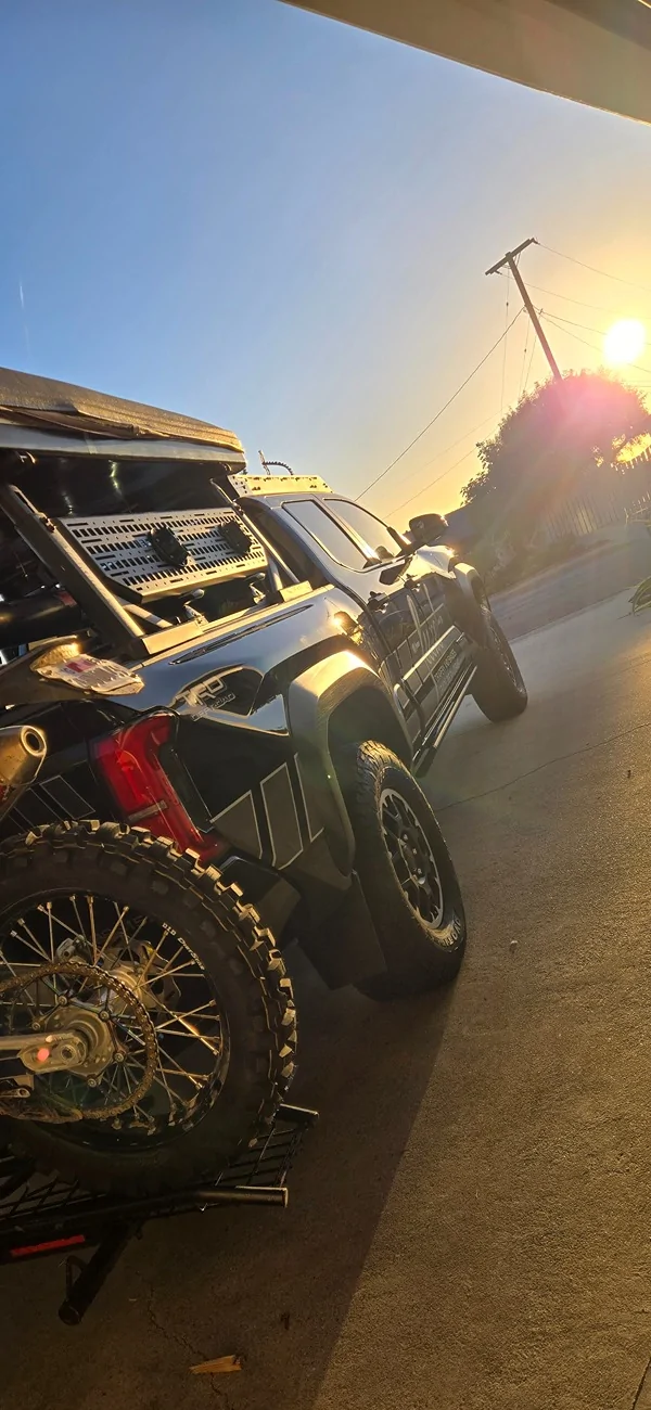

Hi I just ordered my kit. I have a king front and back kit on my truck 2 1/4 in the front and 2" in the back. When camping and dirtbiking I easly add about 1klbs I installef the Eibach 500lbs and they still sag. See picture below I Being I have a 2" lift in the back I ordered cradles and 2inch spacers just incase.
Thoughts?
