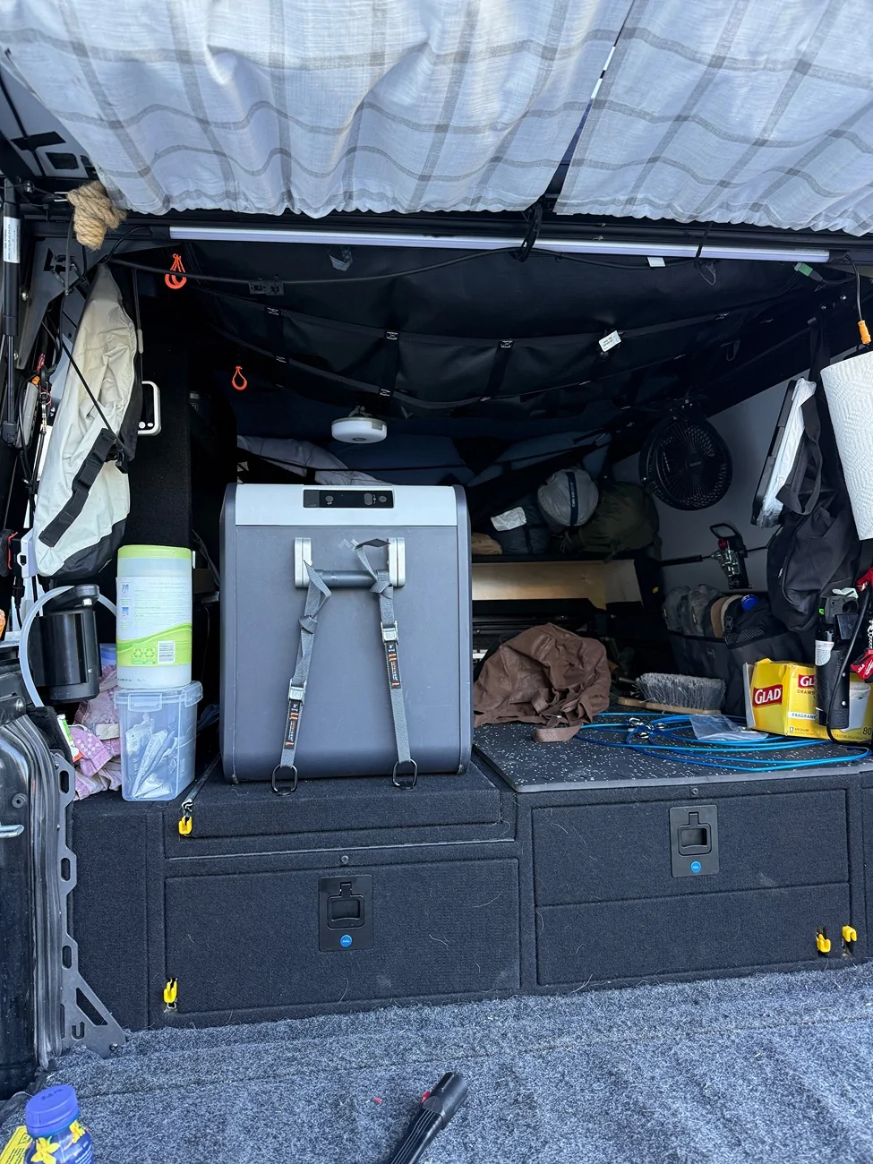

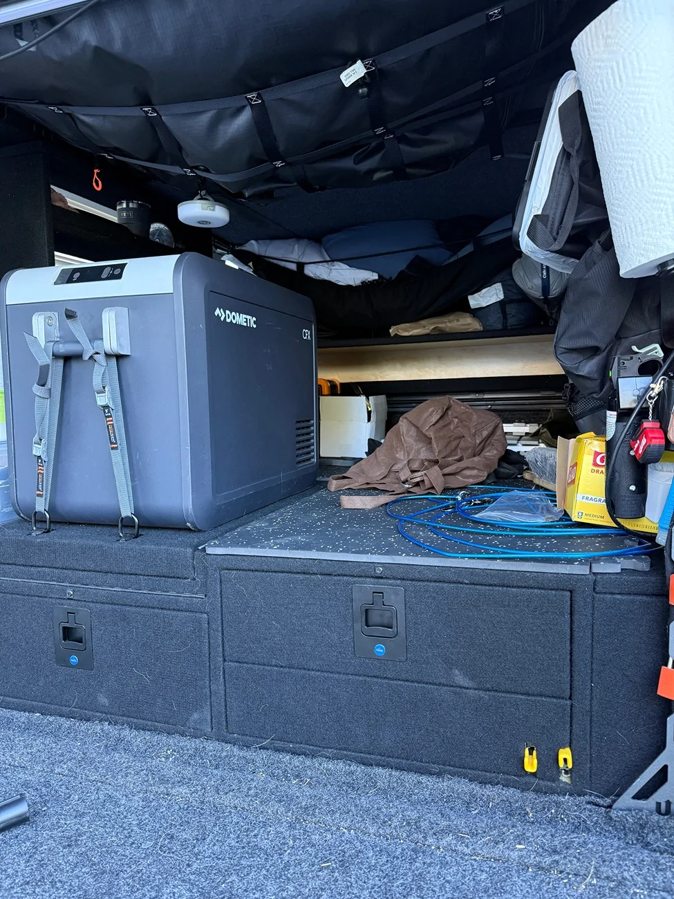

It’s still shamefully messy back here but, this is what my interior is like with ~12” tall drawers. Hope that helps a bit!
And yes I’ve seen a lot of owners run SUPs and kayaks on their roof without a problem!

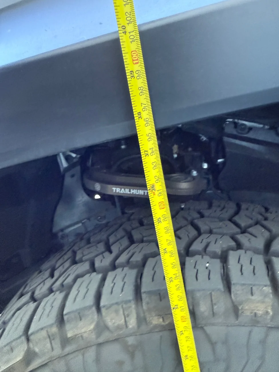

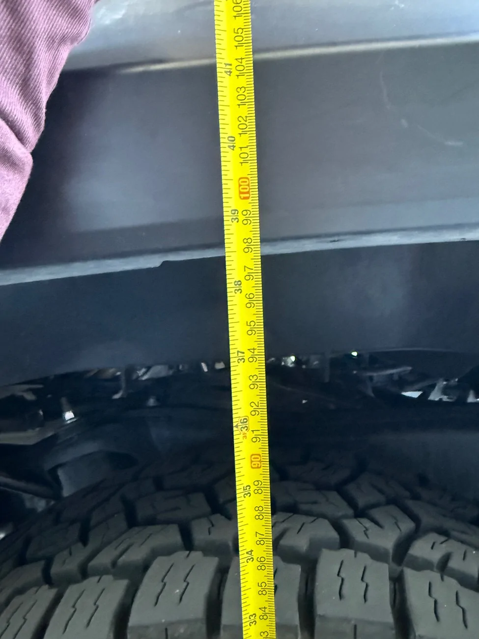

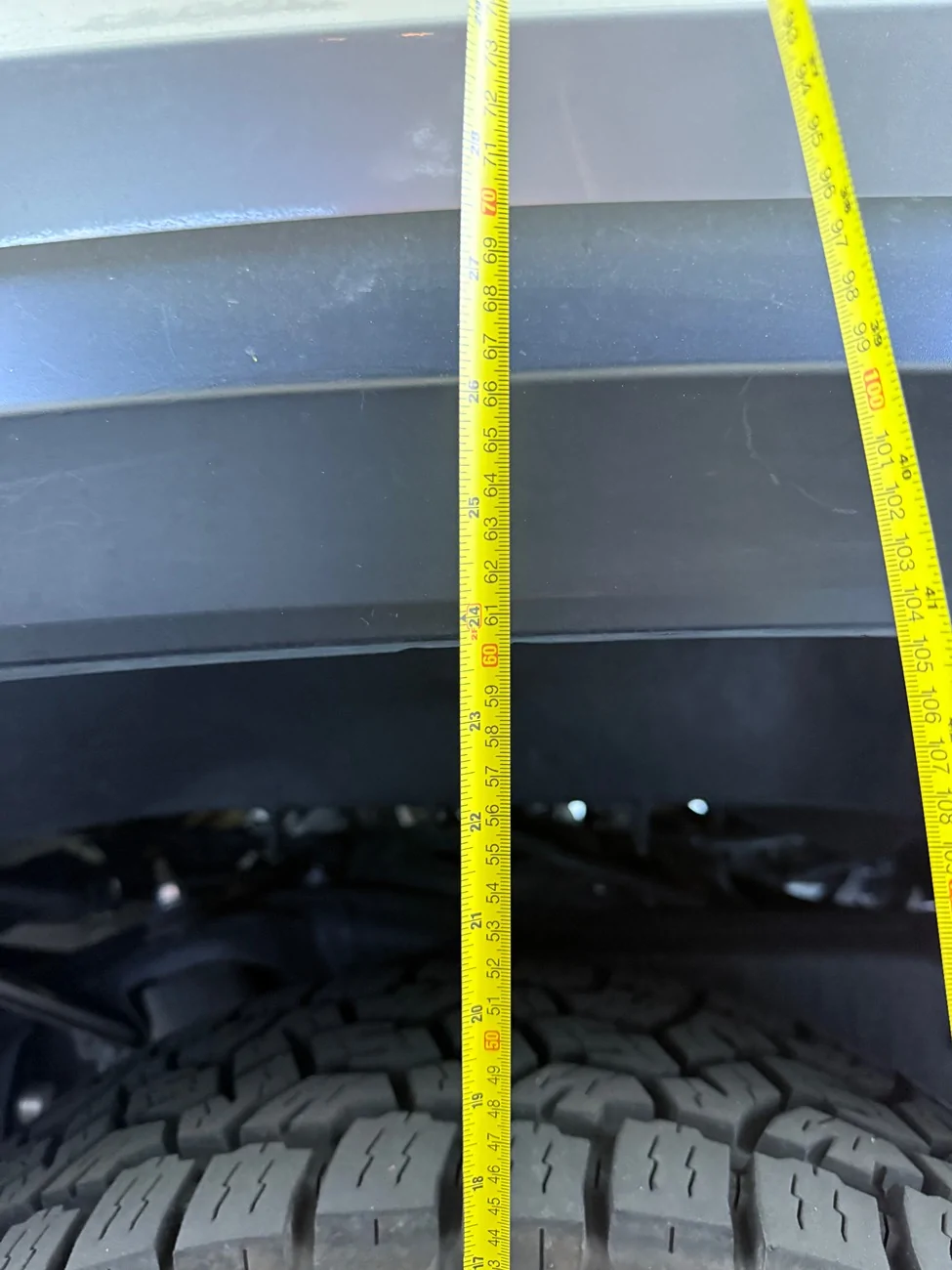

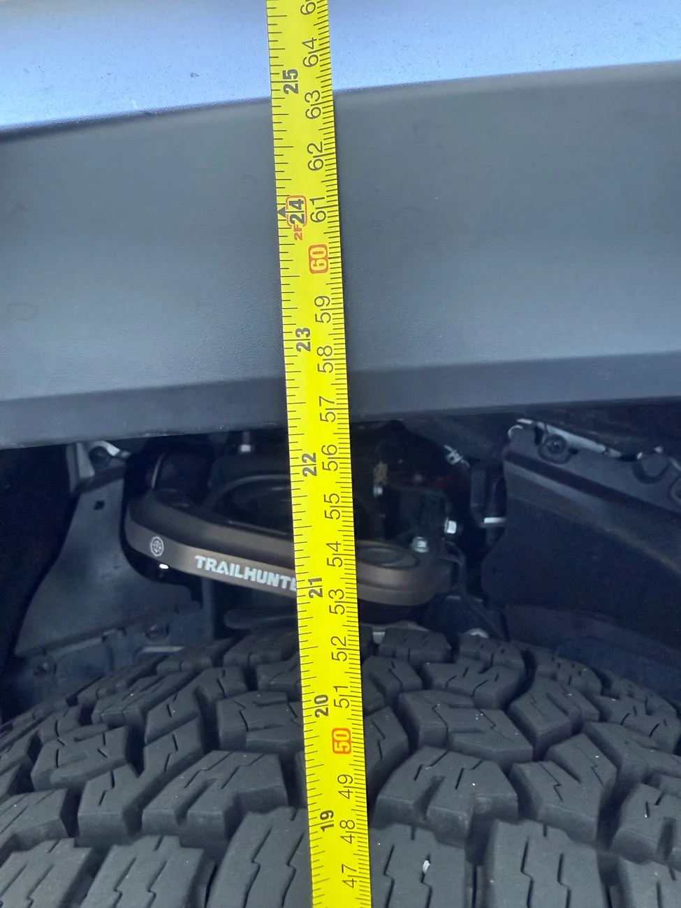

Here are some pics of the front and rear (measurement taken from the center of the wheel ~ I think that’s the proper way to do these(?) but I snapped a pic of each from the ground too just in case.) I have the oem 18” wheels and e load Toyo at3 265/70s
I’m pretty much at full load out weight right now minus getting gas + throwing a bag of groceries + backpack of clothes in there since I’m heading out this coming weekend. Hopefully this helps paint a picture though with the 821s

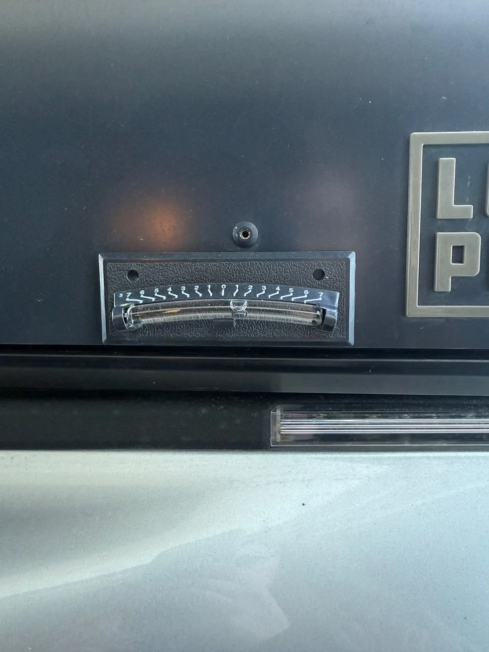

(I’m parked on level ground but I included my bubble level too for another reference point)

👍👍👍 Your truck is completely level
I'm still debating if I want to lift the front or swap out my 823s. I carry more weight on my receiver hitch. If 821s level out the truck for you, they might be a tad too soft for me.

Yeah the 821s might be a bit squishy for you then! If I carried bikes or anything of substance off my hitch, I’d maybe want one level up from these since most of my weight is in the rear right now (I don’t have a winch or anything going on up front). As it sits right now, these are perfect for me.
I’m pretty sure Dobinsons makes springs that are compatible with the front suspension, though I don’t know the details on those
