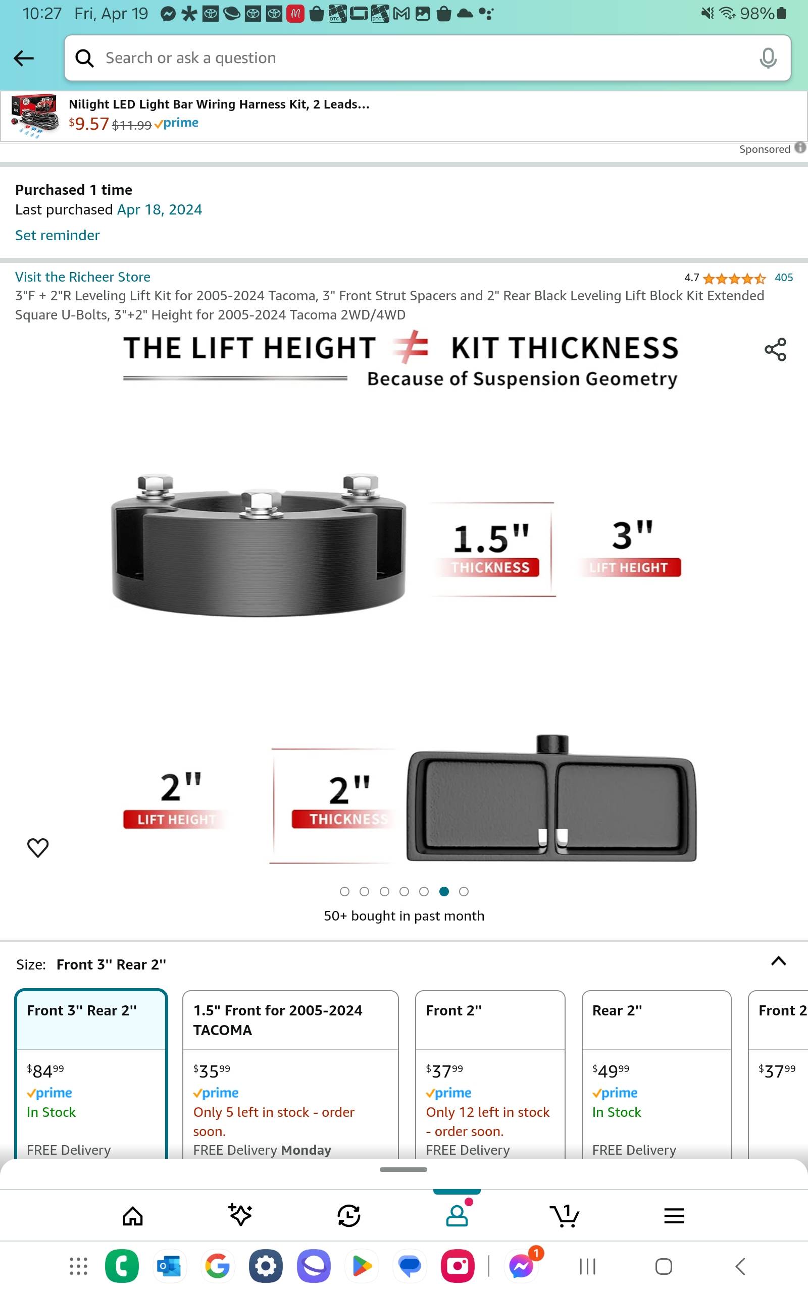

So I bought what is supposed to be a 3" leveling kit, States 3" lift in front 2" lift in back.
So it arrived today, was so excited to start the install.
So here is my issue, can someone explain to me how a 1.50 inch spacer is going to raise my 2024 Tacoma 3 inches. I have attached pictures of what they sent and stated. If I install this I think it going to have a big rake then now.

Suspension Geometry holds the answers you seek. While adding 1.5ā€ at the coil, you’re gaining 3ā€ at the hub.

Also, that lift won’t work on 2024 and newer Tacomas. Major redesign of the suspension in the 24 models.

On the 24 the top of the front shock/spring is a four bolt pattern instead of three like the other generations of tacoma’s

Wonder if the front spacer for strut has holes for BOTH 3 and 4 bolt strut tops (not much material - so don’t see how really possible?)
