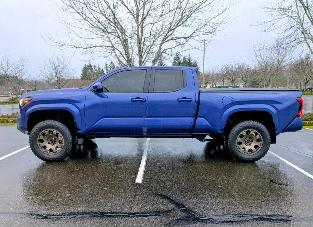

Bilstein 5100s front and rear. Front set at 1.4”
2024 Tacoma Stock SR5 measurements needed IMG_4635
Just for funesies would be curious to know what your measurements are at the front of the cab ground to rocker and rear of the cab ground to rocker on flat ground!
Below is same shocks/struts, same settings on an SR5. Equal measurements hub to fender front and rear, a little nose high with the wheel wells even, so slightly different results with same settings!
