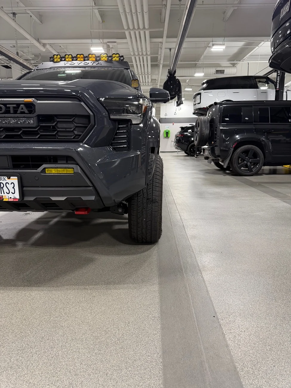

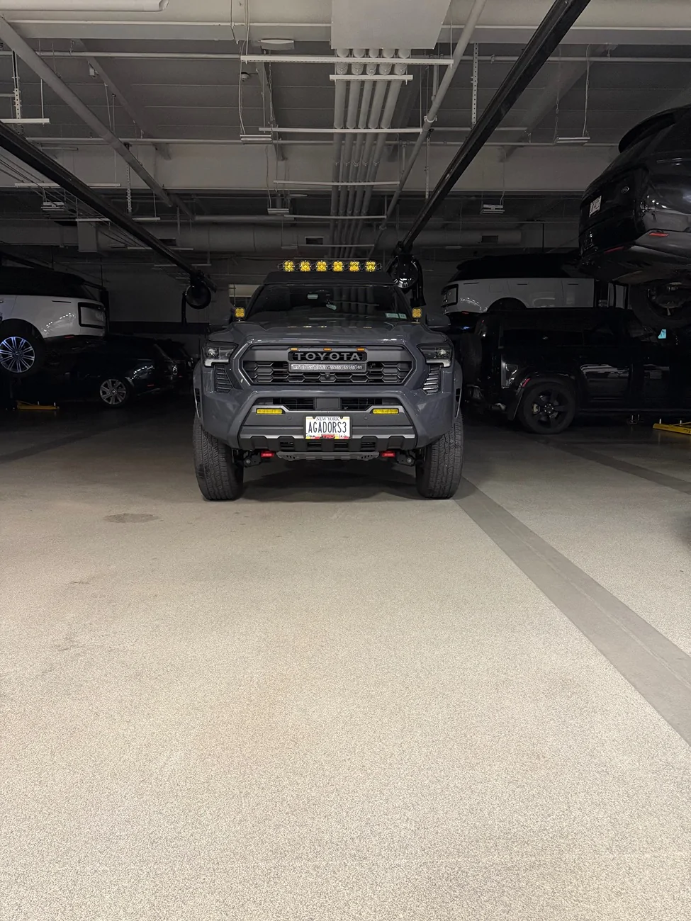

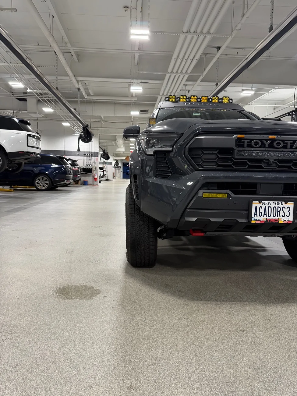

In need of some help aligning the front of my truck. I have a 2024 Tacoma off road hybrid premium. I recently upgraded from stock suspension to
Front trd pro UCAs
Front trd pro struts
Dobinson .5 inch rear springs
Trd pro rear shocks
The front wheels look like they have some positive camber/caster. I am technician for Land Rover and have access to a Hunter alignment rack at work. I have adjusted camber/caster many times, and toe I just can’t seem to get the wheels cambered in to look even. I don’t know if the truck is supposed to sit this way or if I’m doing something wrong. Attaching pictures to see if anyone with a trd pro or any Toyota mechanics or alignment guys can help me out. According to the machine this is within spec. But front wheels look a little cambered out, I’m worried about wearing the tires out. Also based out of Long Island, NY and willing to pay someone who can help me fix this. Thanks.

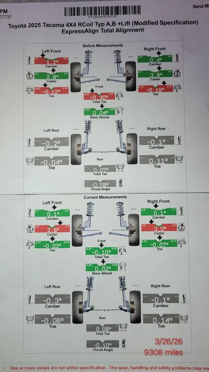

Doing some self-study, I found the attached: an alignment procedure for the '24 Tacoma HV.
Posting here as a reference for anyone interested.

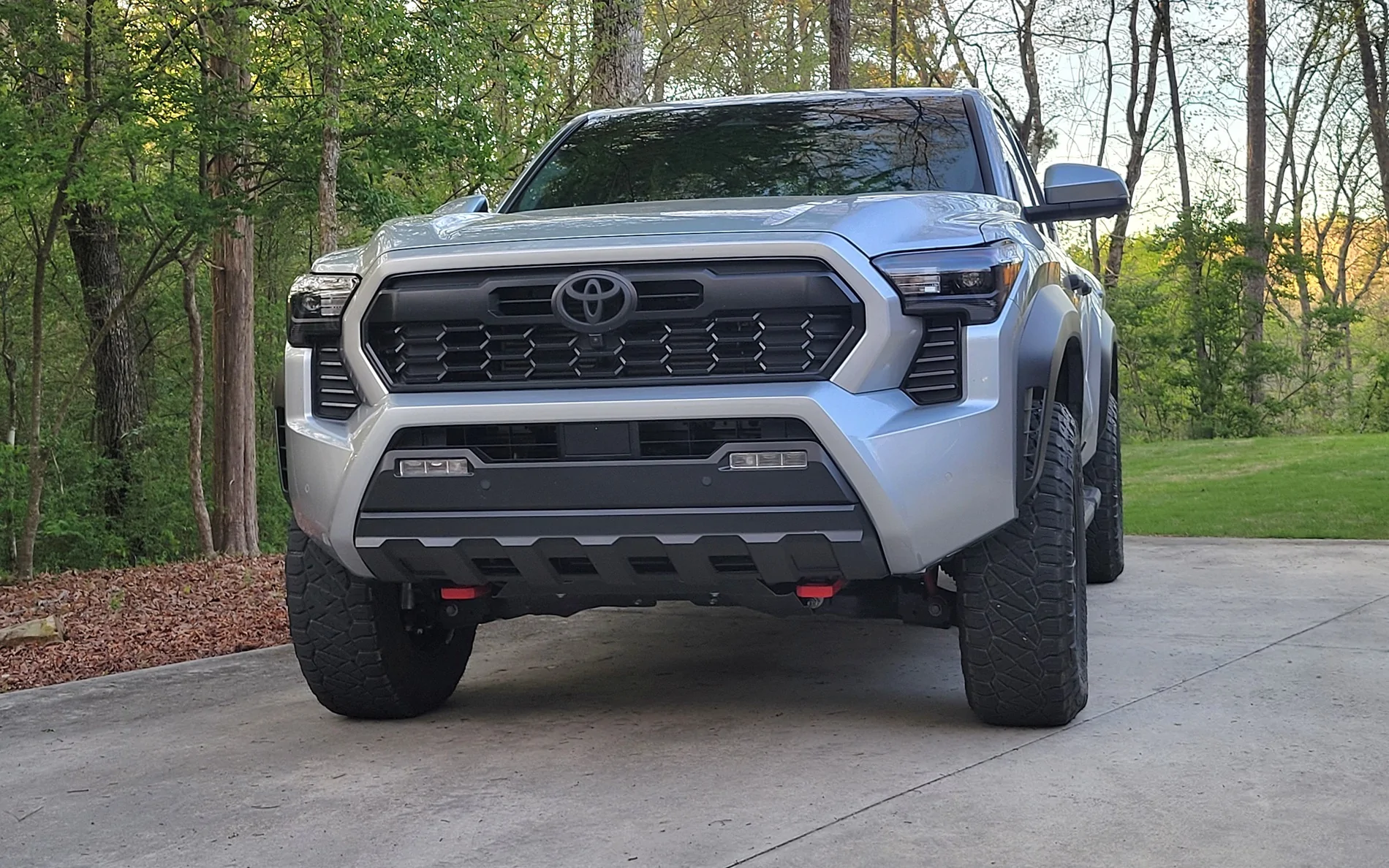

Having just over 1° positive camber seems to be within acceptable range. I don't like it and I don't understand why. 0° camber is also acceptable. I asked my alignment shop to get my camber as close to 0° as possible and they were able to do this for me. I have a TRD OR with 1.5" front/rear lift via All Dogs Offroad springs (everything else is stock). So you have even more adjustment than me with the UCA's. My Truck drives great with these numbers. Tires are 265/70r18.

Yea yours looks, more flat. What size tires are you running?

Can you possibly post a pic of the right side of your truck, like the way I have posted. I wanna compare that side.

I have a Pro, my front tires are like that, drives fine and tires are wearing even so far.

I see so this is normal then. Thanks for the response.
