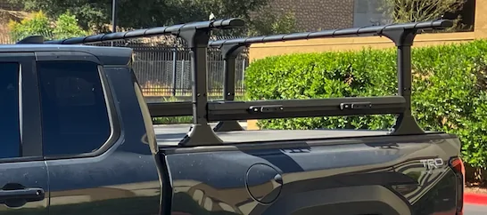

I’ve got the cover you’re asking about and unless Yakima has made a design change, it’s not compatible w/ that rack——the vertical side members taper inward toward the top which will prevent (block) the cover from rolling forward. My solution was to go with the Elevate rack since the uprights are straight up which allows the cover to pass through when rolling up. Below, I’ll add a pic and link to the write-up I posted after install if you’re interested. FWIW, I’ve been very happy with this set-up and haven’t seen anything yet that looks like it would be better for my needs.

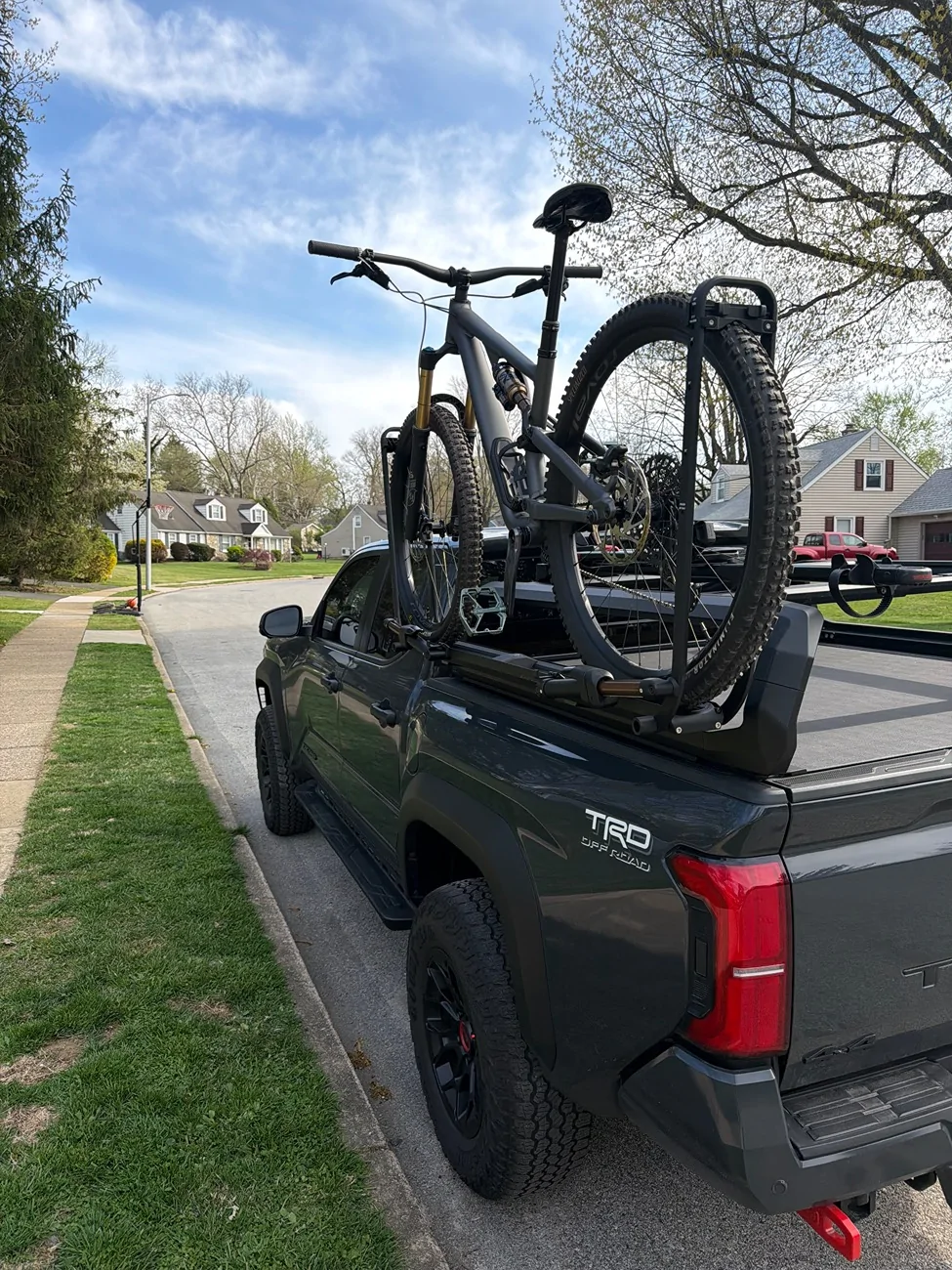

I have that same tonneau cover and am running the Kuat IBEX rack setup. I know a couple other people on here have that setup as well. Here is a pic with the bike rack they have for it.
Can run in mid height which is what I have… or run it full height….there are molle panel options…. Even can fully enclose it with their panel system if wanted. DD has a bunch of different lighting options for it.

That looks really nice. How much weight can that bike rack support?

According to Kuat, it can hold up to 67lbs. I have several Kuat products, they are top quality and their customer service is hands down the best I have ever dealt with!
