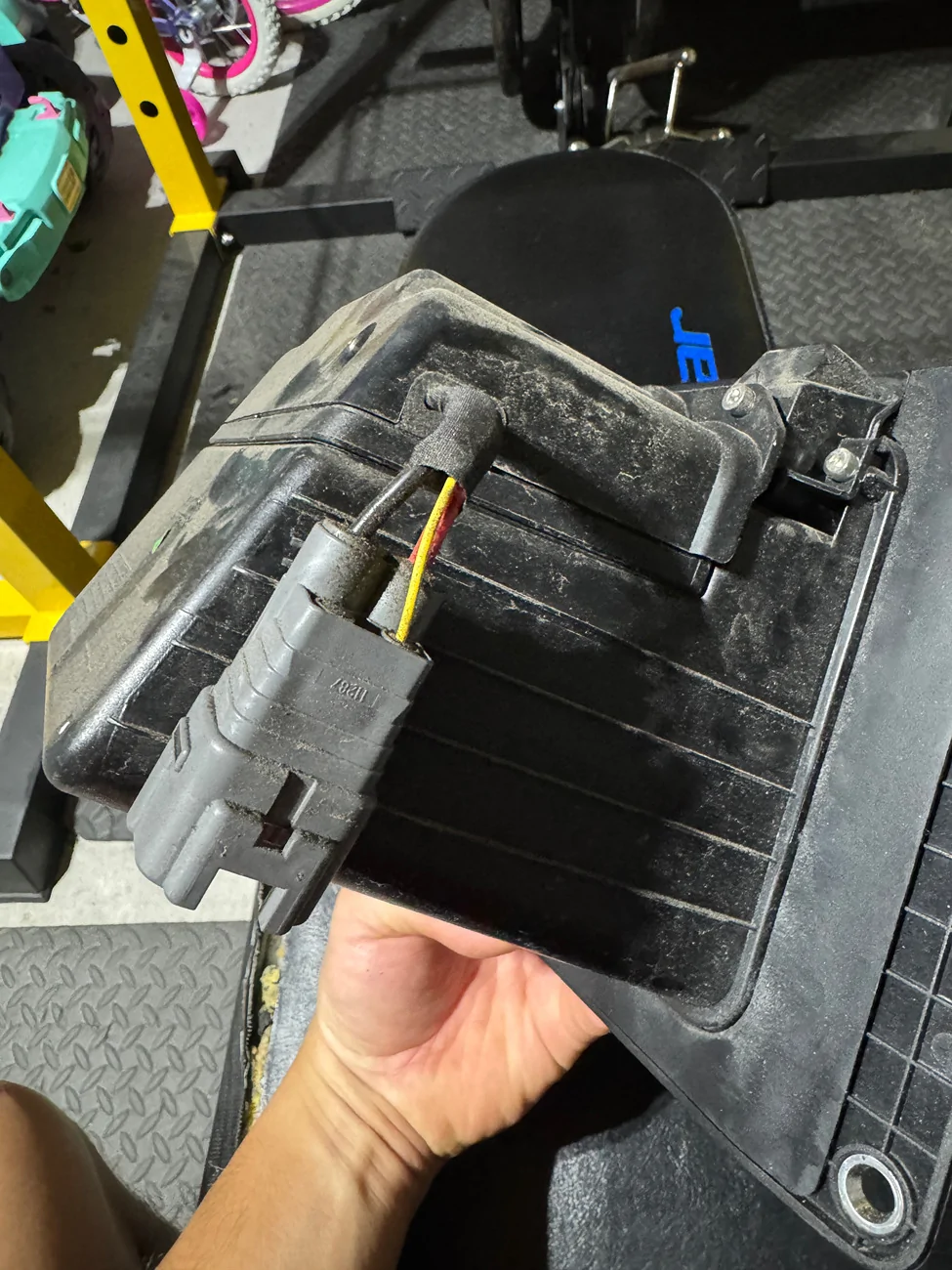

So on my 2024 TRD OR, the plug is there tucked up behind the rear quarter panel. Pulled off the connector, set truck to ACC mode (lights on, but not running). It's a 4 plug connector. It has 12v power on two of the pins so the wiring is already there instead of running a cable to the back of the truck bed. It seems like it would be simply a matter of cutting a hole and installing this, but curious if it is that simple before I pick up a $200 part.
So it's already powered from the factory. Option 1 is buying the thing below. Option 2 is some sort of connector that connects to the 4 pin grey OEM connector but could fit some sort of spade or ring terminal and I could install a blue sea type connector.
Truck Bed Power Port
Edit: There was a similar thread to this on the TW forum. The plug supplies always on power, but also has a sense switch on the red and green wires. Tested it on mine. Find that, like on the other thread, it has power always. Per the wiring diagram, fused for 50A under the hood using an air compressor labelled fuse.
Looks to literally be a cut and plug process. Not necessarily faint of heart cutting into the bed to make large hole, but not seeing another way to access that plug without all sorts of malarky to build a custom harness since it needs a fair bit of work. Not my cup of tea, but would make a nice aftermarket solution to make custom harnesses and a single round 12v water resistant plug. Would then give power to bed without ever needing to run anything from battery. Not sure why Toyota needed to make this thing so damn big. So much wasted space on this when a simple plug, like every minivan in the world has, would work.

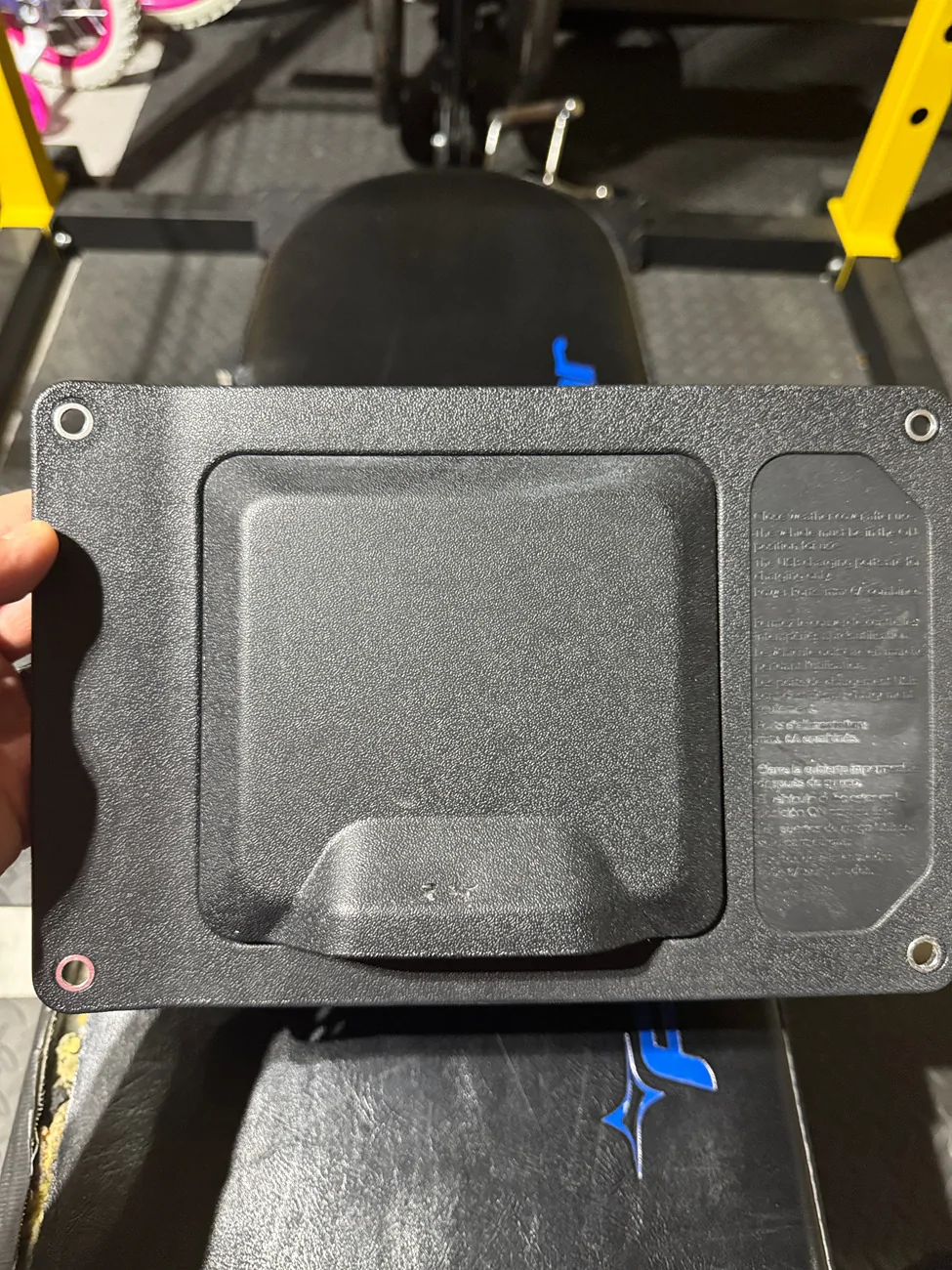

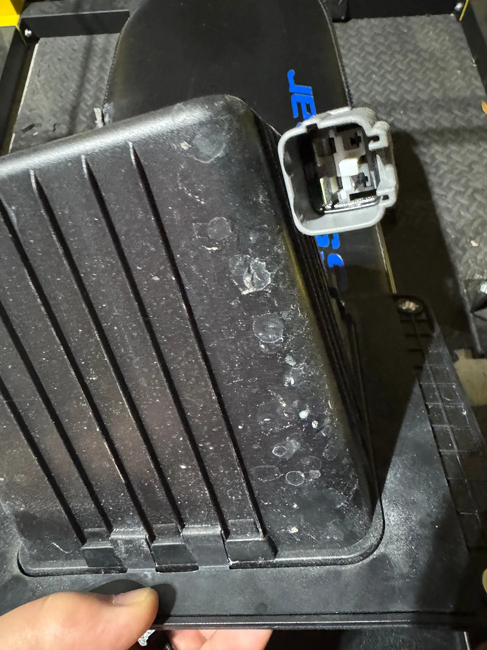

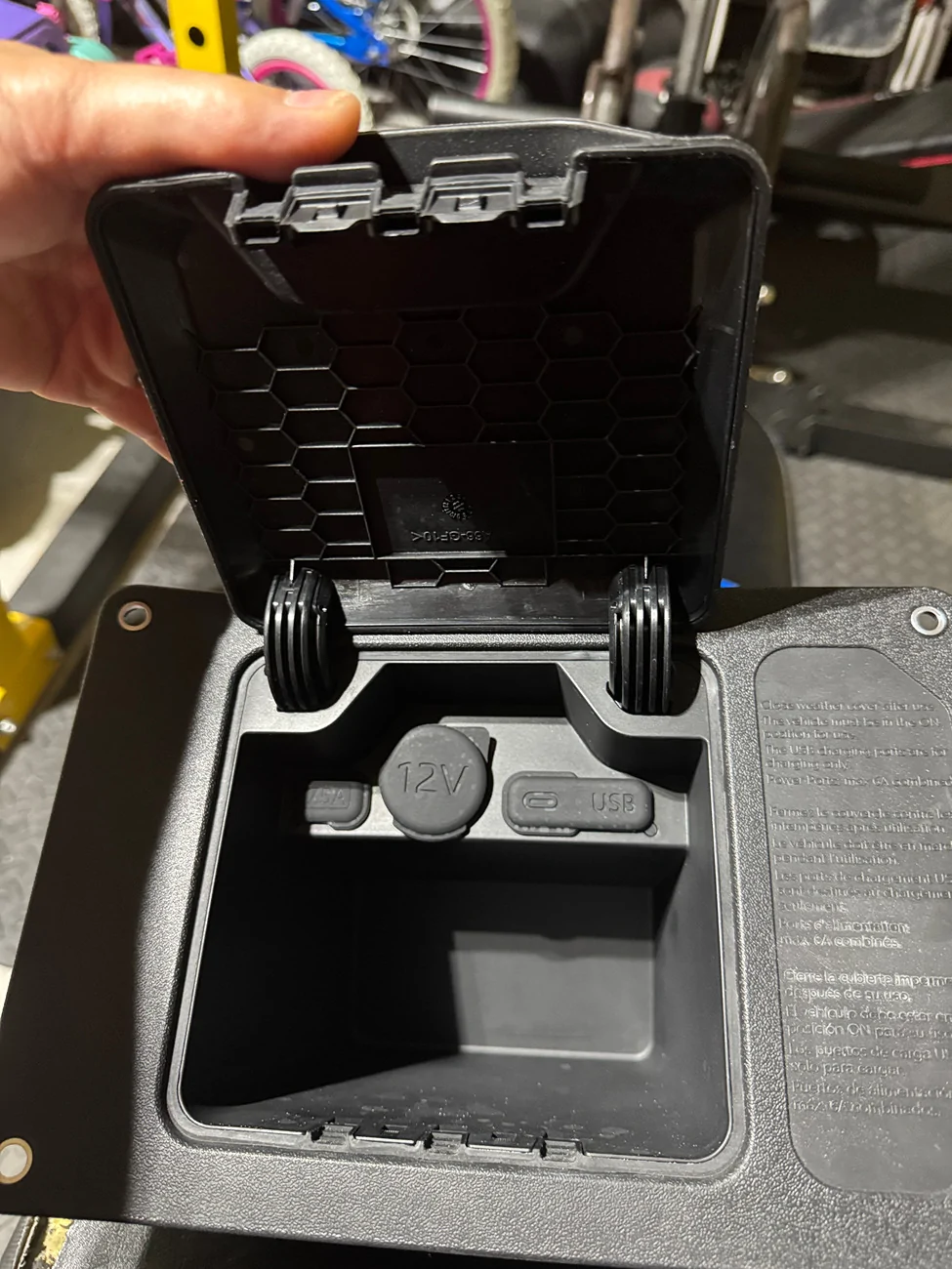

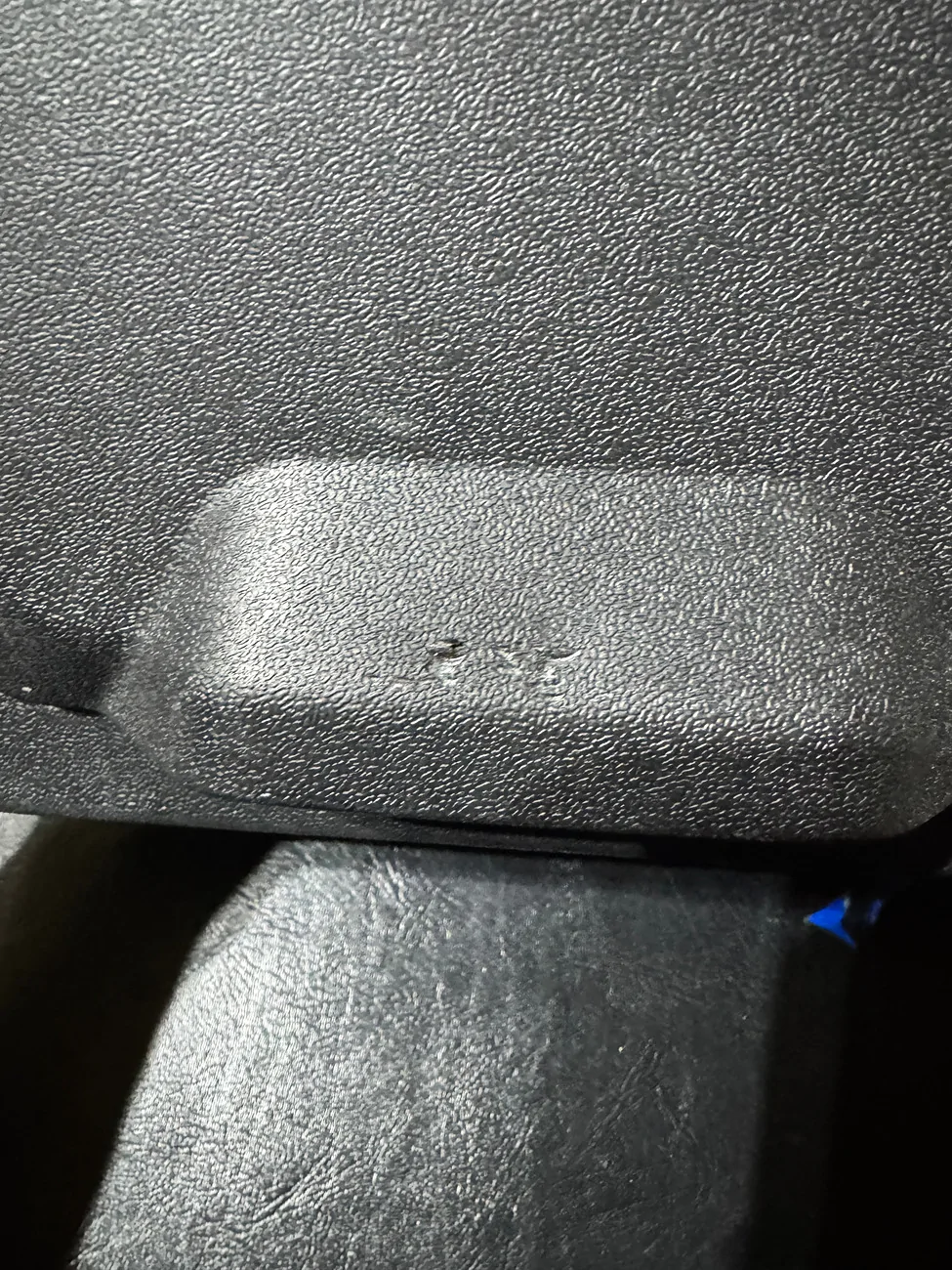

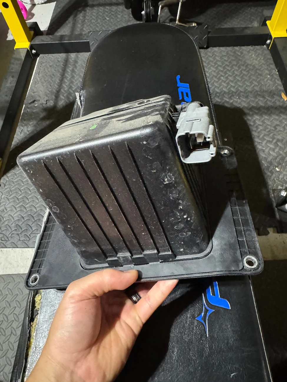

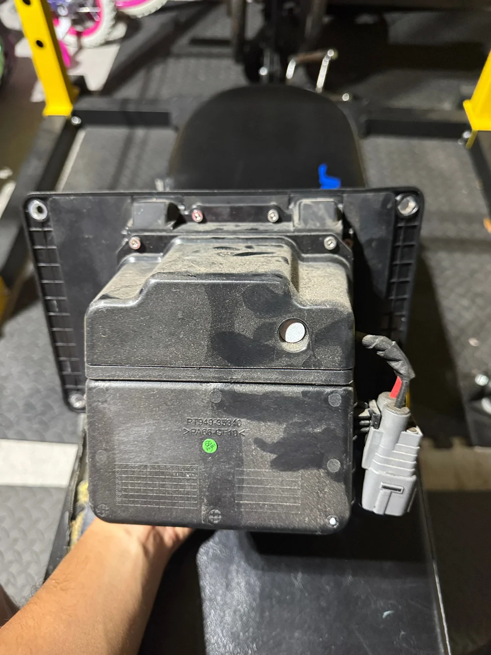

I got an OEM truck bed power port available is anyone wants to buy it. It works. There is a little damaged to the flip cover. I upgraded to the OEM compressor/truck bed power port. I am selling it for $100 local in Houston, TX. Can ship via USPS large flat rate box for $30.
