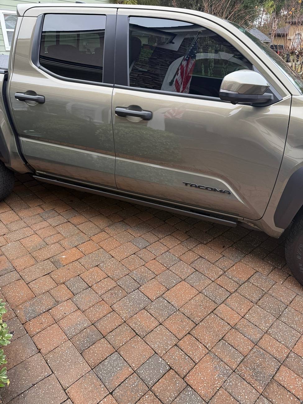

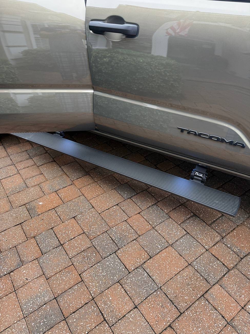

But I have the rough country power boards on my 2024 pro. They have been on for 3 months now and have worked flawlessly. Even in the most recent snow and ice we have had in MD.
No complaints what so ever. And they look sharp on the truck when folded in.
