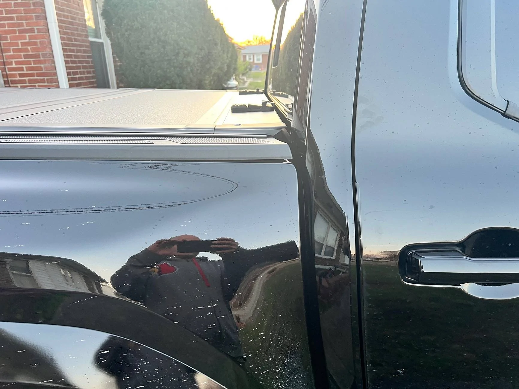

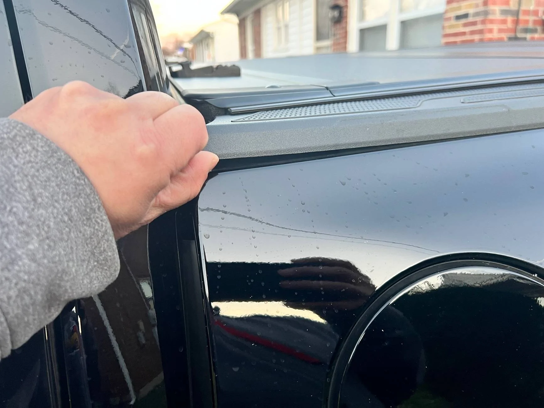

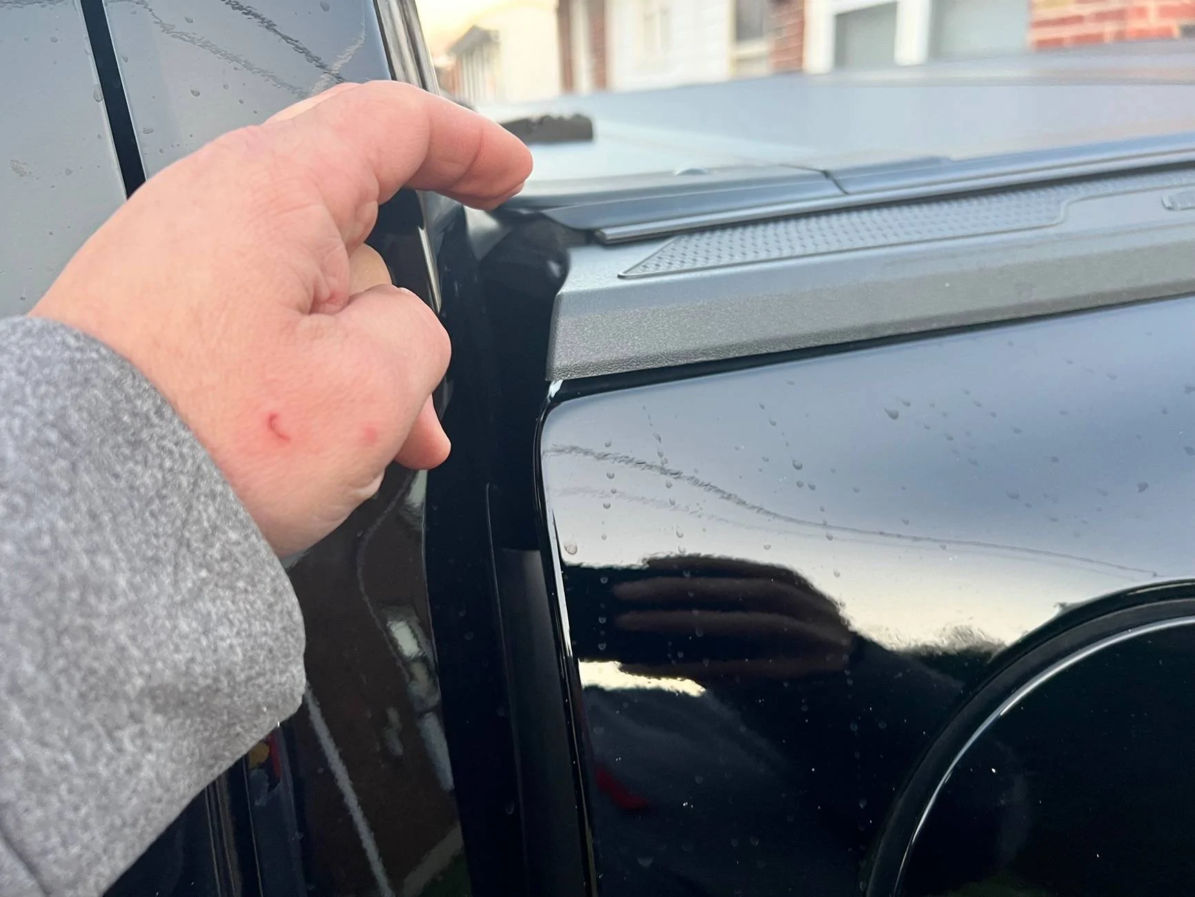

I have the same thing going on with my 2024 Taco also. Very annoying. Can you send a pic of how you used the tape for your bed cap? Does it bond well even though the edges of the cap is so thin?
You have to lift the bed cap up and you will see a white styrofoam block. I put the tape between the underside of the rail and that block. Be sure to put weight on it long enough to setup properly.

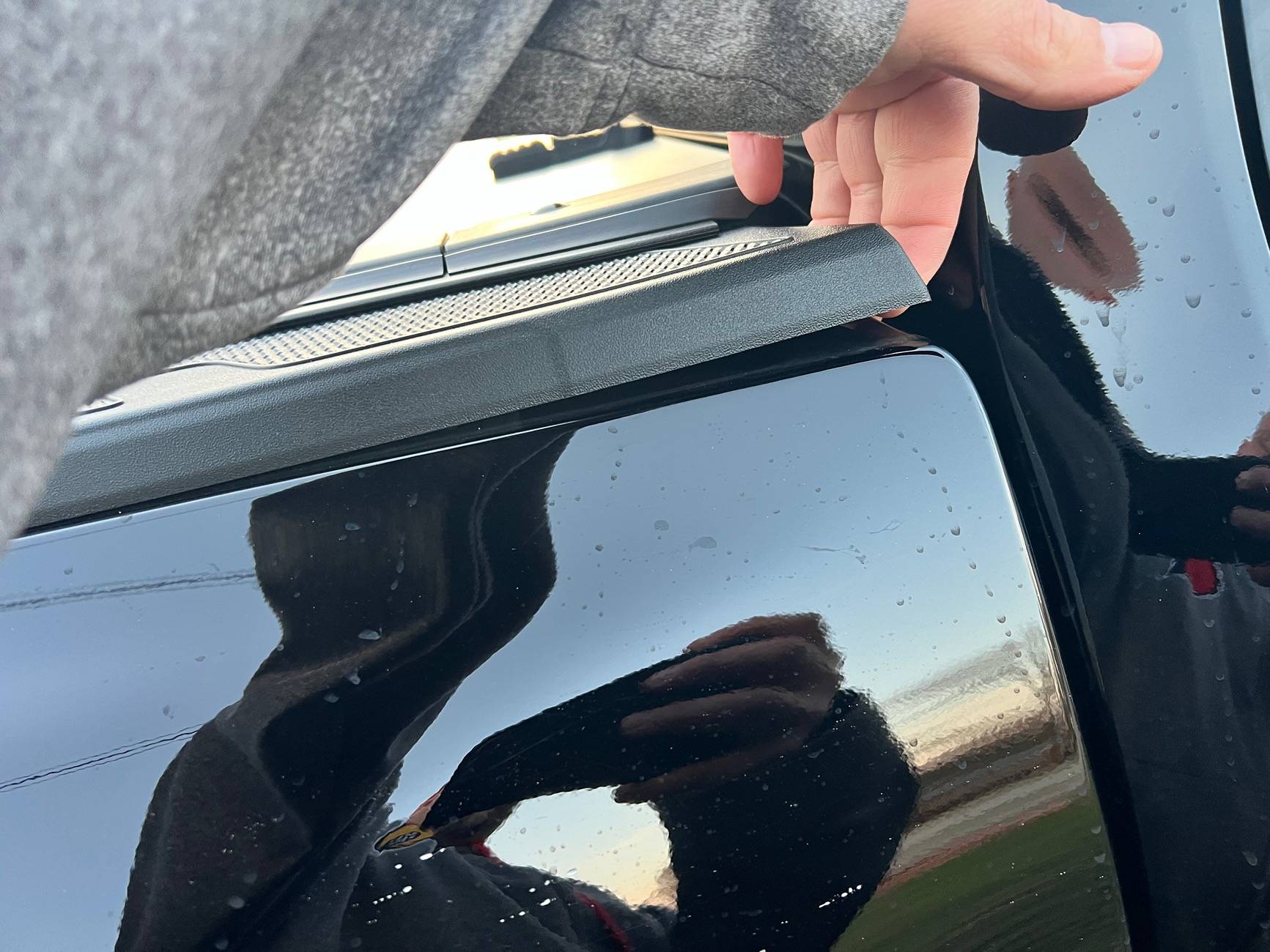

I have the same issue on mine. It's weird that Toyota didn't secure that point and just let it "rest" there.

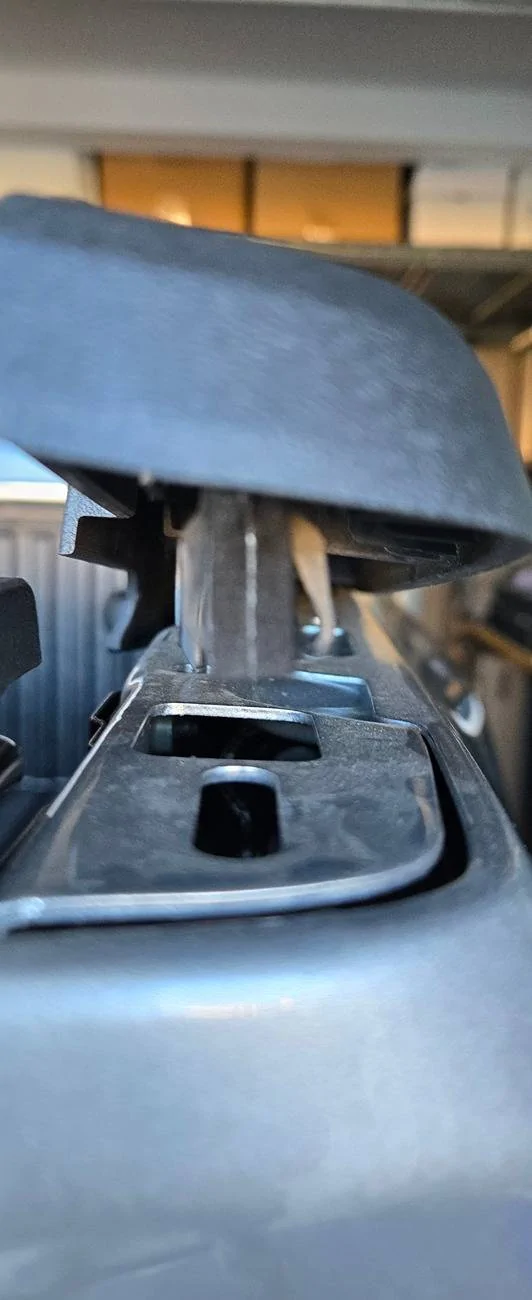

Thanks for the tip! I will check for that styrofoam block. During my quick initial inspection on the corner of the bed cap where it's lifting - I didn't notice any styrofoam block. Perhaps, I wasn't lifting it high enough. It's the exact same corners that TacoTacoBurritoBurrito pointed out.

I used a heat gun, on high heat constantly moving the gun then put a 25 pound dumbbell on top of it and kept it on there overnight

Had the same issue. Be careful with the Styrofoam block as it may be brittle and break. I took it off all together.
The problem is less with the adhesive and more about the retention clips. I used 3m and it still was lifting and I actually made it worse by messing with it.
I ended up putting a piece of dense foam I had laying around between the two sides of the retention clip to make it stronger. It worked really well and think it's is as flush as it can get.

I had the same issue on the mine as well except only on the driver's side of the bed. It was slightly irritating. I bought and installed the OEM tonneau cover. The frame of the bed cover actually holds the bed rail cap tight to the body, so that solved the issue. I'd say it's a very minor flaw, and if it really bothers anyone that much, some double sided tape should fix it pretty easily. Trying to get it resolved through a dealership is most likely to make the issue even more frustrating than anything else.

I had this issue after I went to Laughlin Nevada for a week and my truck was sitting in 105-110 degree weather.
I also have a tanneu flip up cover on my truck which I suspect contributed to the plastic trim lifting up in the corners due to the pressure that it puts on the truck bed in the corners.
Fixed this easily using 3M VHB double sided tape. If you lift up the trim there is styrofoam material with adhesive on it that is between the plastic trim and the painted body of the car. I scraped this old adhesive off with a plastic razor blade and reapplied the 3M stuff. Put masking tape over it to hold it down while the adhesive cured for 24 hours. Problem solved.
