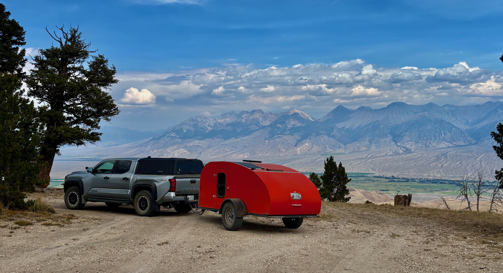

I've read of folks having issues, but have towed numerous times without any problems.
1. Turn the truck off and hitch up.
2. Tow
3. Turn the truck off and unhitch
4. After driving forty yards or so, it'll ask about the trailer and you select YES.
2024 Tacoma Best sequence for connecting and disconnecting trailer to avoid detection issues. 3IoLhvN
That's it.
