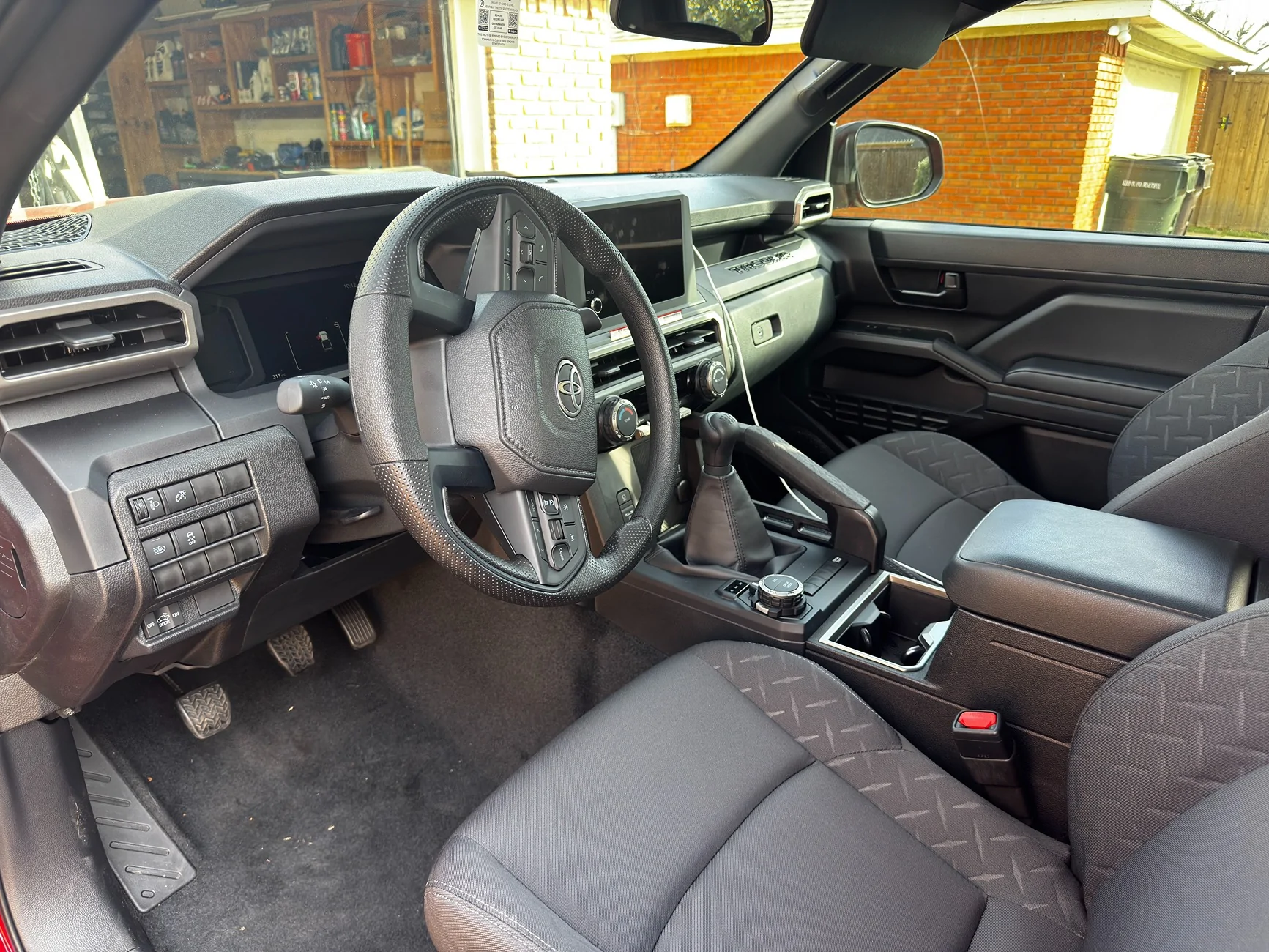

Some photos:

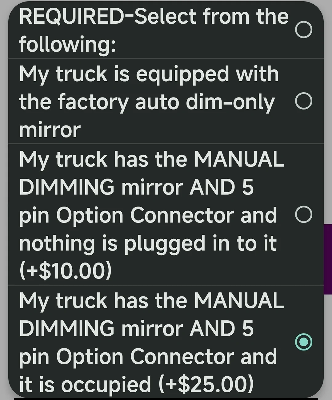

Yep the 5 pin is just sitting there, unless you have the action cam or another accessory plugged in.
Bob included the right 5 pin harness for my truck. He's got fancier edgeless glass versions too but for $259 or whatever the older looking style is fine for me. I definitely recommend buying the mirror from him.

Thanks for that. I've seen this before but wasn't sure if I was missing out on something better with the frameless design. Some mirrors are actually battery powered which I didn't want.
My only thing with his connector is i don't really want the mirror on ignition only. I like that for theft reasons but I find V5 mirrors when on ignition don't always work on the first press. So I wonder if he has any options for battery power wire.

I ended up reaching out to Bob's and it turns out that the $250 frameless package we discussed here is actually an ignition-only mirror, it has no use for constant battery power at all as the internals power the buttons off of the ignition pin. So I went with that one. I actually prefer ignition as well but other mirrors I had that were V5 and meant to be on constant power for the buttons, did not work well when run on ignition. So now that a mirror is actually dedicated to ignition, that is ideal for me.
Bob pointed me out to some other mirrors that are constant powered, such as their $350 frameless wtih the compass or the 3G used mirror with compass (non-frameless), but I ultimately decided the one without the compass for cheaper was the ideal way for me to go since the dash does have compass readouts (even if not super quickly accessible).
