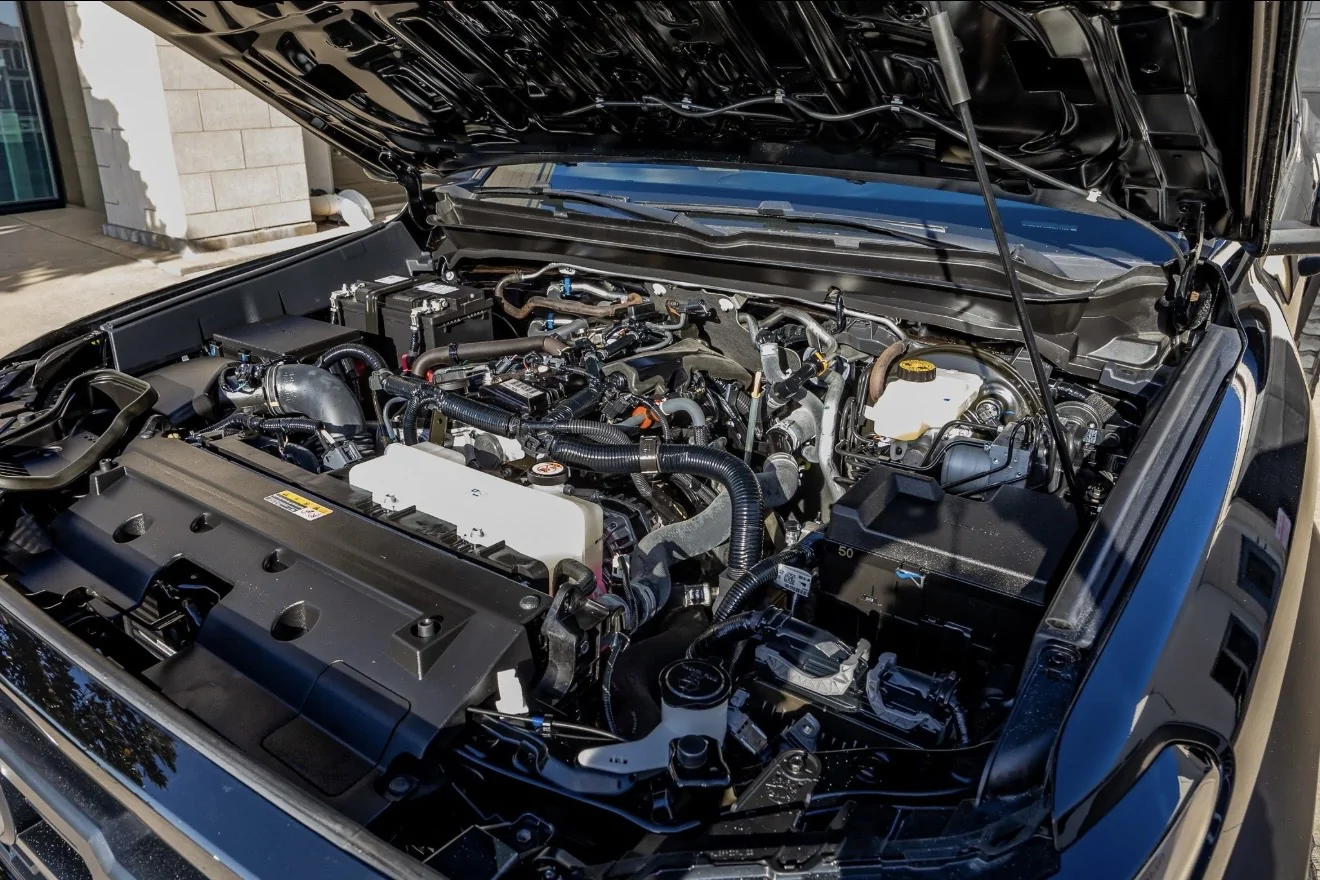

They feel a lot different than the vacuum brakes on the gas trucks.
I'm quite sure my fourth-gen (gas) OR utilizes an electronic hydraulic brake booster system without vacuum.
BLtheP
Apr 12, 2024
255
197
TX
All gas engines have vacuum boosters on the 4th gen.
