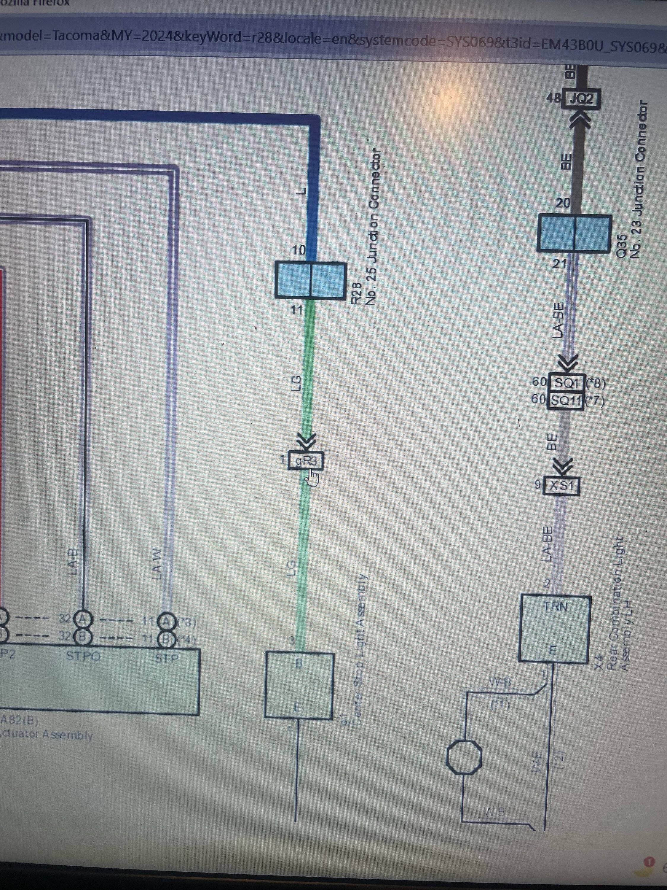

What wire did you tap into to get the brake light control input?
I’m pondering taking a gooseneck harness adapter to split apart to create a custom harness. Plug it in between the vehicle 7 pin and bumper plug. This will give me pins I can modify to collect left/right turn and the trailer brake wire.
Then use one of the third brake light modules that cancel out the turn signals and are used for toppers.Then run the output from this and a larger gauge wire for the trailer brakes up into the cab under the back driver seat as you have done. I’m also going to order the diode as well.
Any thoughts?
Gr3 goes to r28 in the yellow harness in diagram. You will need a diode so the brake controller doesn’t send voltage to wire.

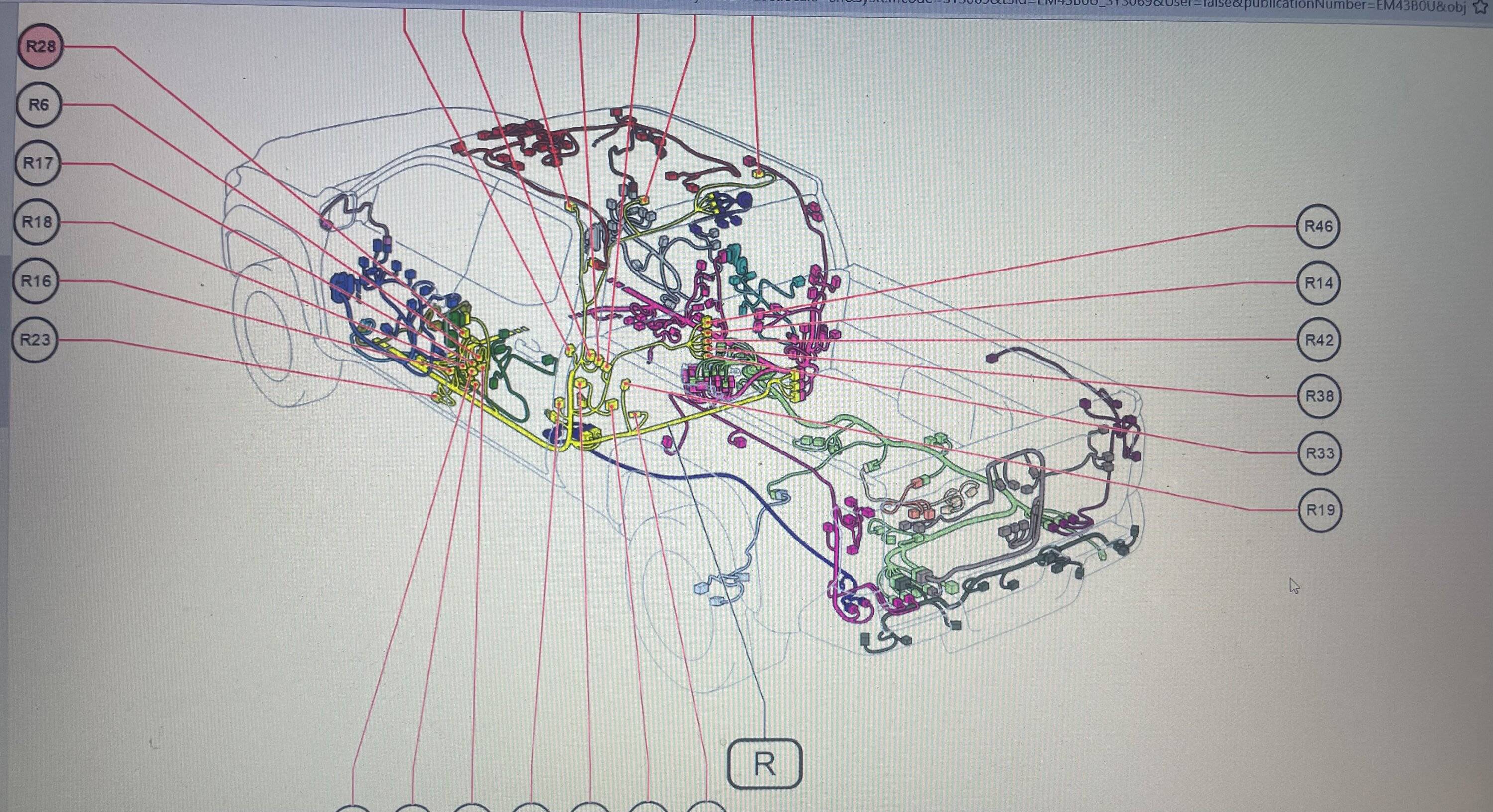

I had to probe it and see what was energized with brake light
Follow pin 11 of r28 connector
