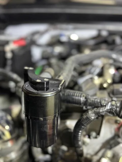

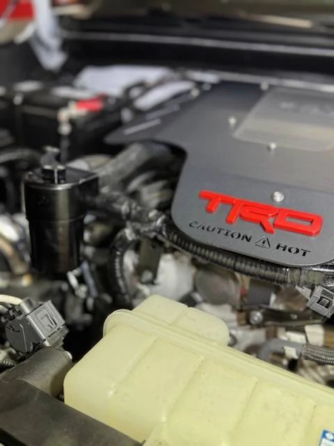

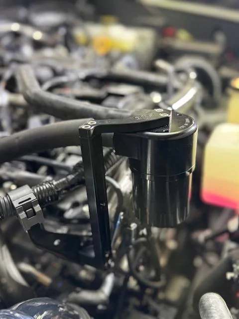

I have been a big believer of using a catch can on all my cars since my 2015 Rubicon - always am surprised at the amount of oil it keeps out of the throttle body and manifold - sometimes an inch or more between oil changes
Burger Motorsports has one for the '24. Nice quality, a tad expensive and a really simple install
2024 Tacoma Burger Motorsports Catch Can cc1
2024 Tacoma Burger Motorsports Catch Can cc2
2024 Tacoma Burger Motorsports Catch Can cc3
