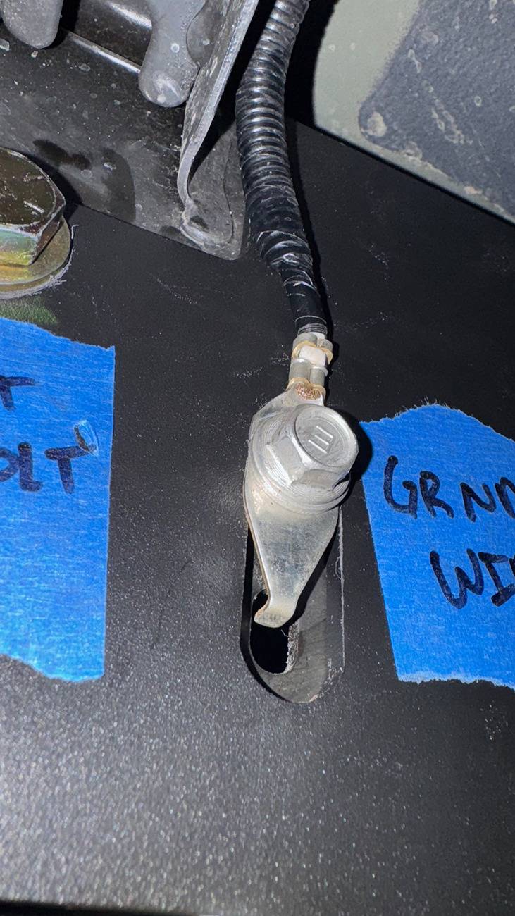

Thanks for confirming the design. That's annoying you had to shave the grounding tab to make it fit. Not sure why the gap tolerance is so tight for that piece.

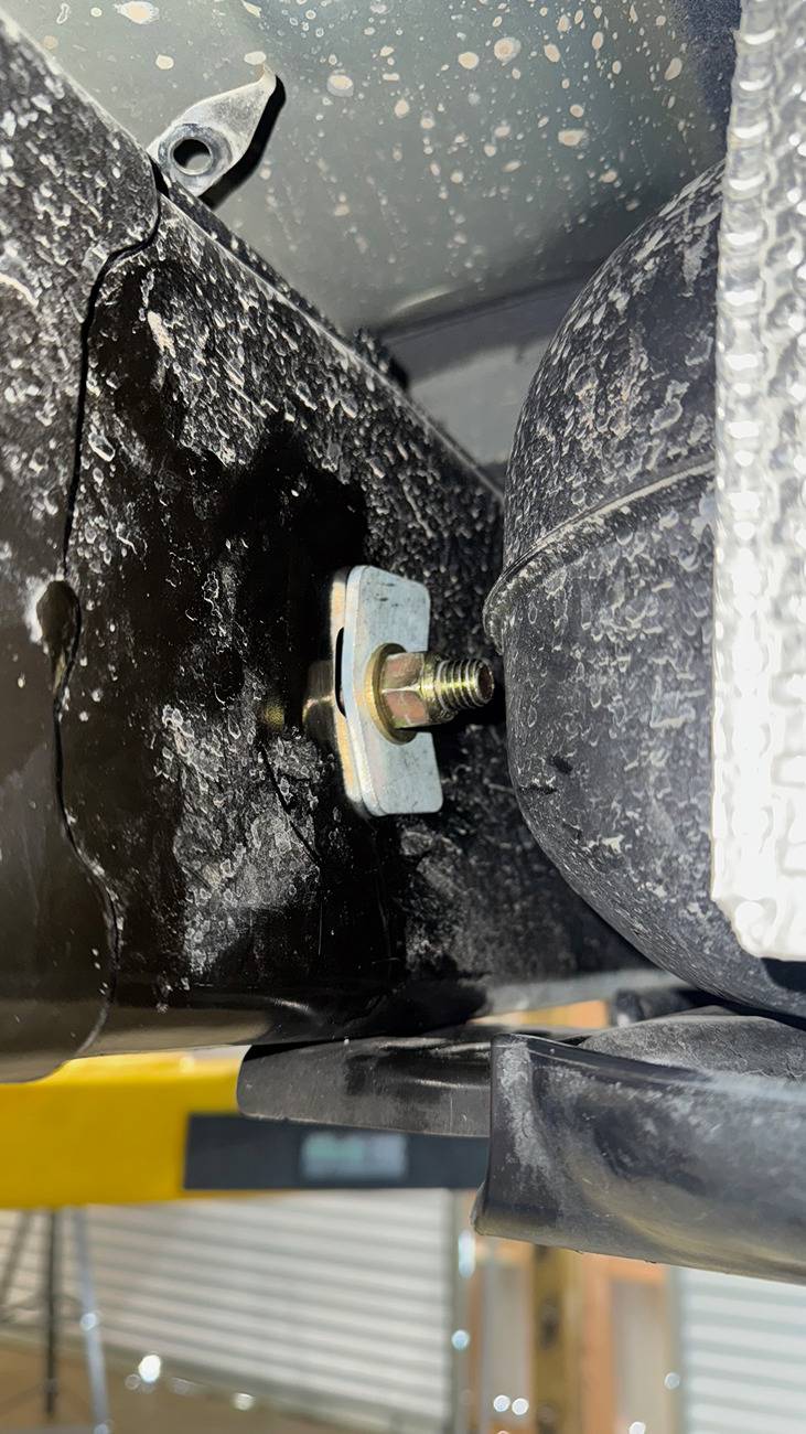

I got mine installed last week just wanted to share my experience. Cali Raised released an updated install video on their YouTube page with their current design and hardware so it helped a bit.
I did not have any hold alignment issues.
The hole where the ground wire goes on my sliders also were not wide enough for the ground wire to go back on flushed. I didn't have the tools to shave down the side so I installed it the best I could and set it a little crooked and on top of the plate instead of the frame.
I also had my washer plate bend a little for the ones in the middle of the sliders on both sides. I believe this is because the hold is a larger square hole that does not distribute the force of the plate well enough and the plate is basically sinking into the larger hole. It didn't matter if the plate was vertical or horizontal. They told me the torque spec is 37ft-lb for the M10 bolts and 55ft-lbs for the 1/2" bolts. These plates were bending as I got it to 50ft-lbs so I left it there.
I did it by myself on a lift and it took about 2.5 hours but I was a newbie and had family distracting me at the time. You can probably get it on faster if you're familiar with tools.

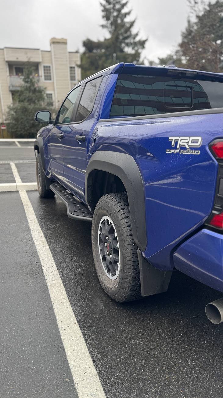

I just recieved my step edition sliders. It was 27 days from order to delivery. There was a pallet at my shop when I got back this afternoon. I went with the raw finish as I'm having them powdercoated red to match my Pro interior with high gloss black tread plates. These are very very high quality. I'm beyond impressed and feel they are a great value for the money. The manager at the powdercoat conpany commented that he doesn't see quality like this often. This is coming from.a 30 yr guy that does industrial parts, race car frames, heavy equipment parts.

That's awesome! Definitely share some pictures when you get 'em done. I bet they're gonna look amazing with that color scheme. Now you got me thinking :unsure: You're gonna love them too. They're super beefy and the added step feature is really nice to have as well. I have the manual seats, and before I got these sliders, I was finding myself having to manually jack my seat up pretty often cause my ass would hit the adjustment lever every time I slid in and out of the truck. With the step, I just plop right into the seat. It's kind of a hidden bonus feature that will hopefully add life to the seat bolstering as well. Can't wait to see how they turn out, and thanks for sharing!

You're welcome, I was concerned with wearing out the side bolsters getting in and out of front seat. I'm 6' and still can't just step into the truck without sliding over the side bolstering. Little ones need help getting in the back as well. Very impressed with the quality.
