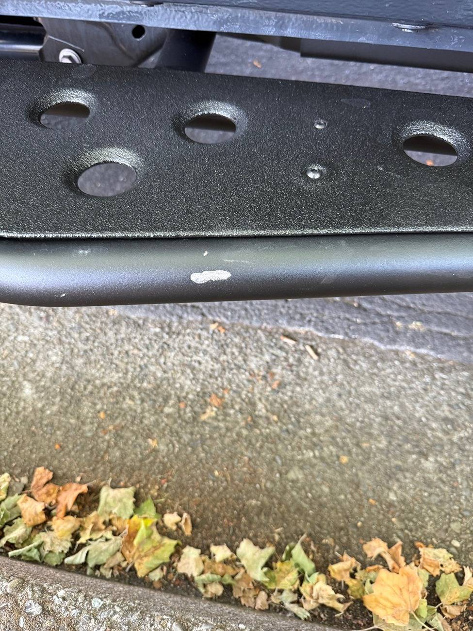

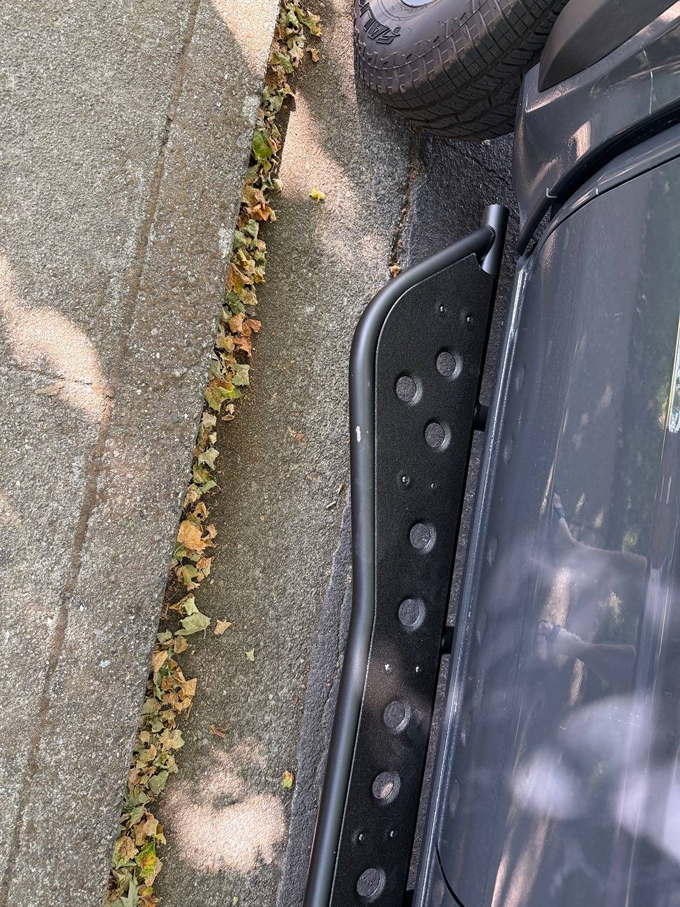

Mine took months, I got the same explanation/excuse for why they took so long. Now that they're here, I'm no longer thrilled with them. I got a first paint chip already. It's not a real powder coat. It's a single layer of black paint and it doesn't appear they were primed properly. Photo attached.
For those of you who have outstanding orders that haven't shipped, I would casually suggest considering canceling and ordering a different product. At this price, it should be right and this isn't right.

I sent them a DM on here since I think they should be aware a bunch of us are talking about it. I haven't contacted them directly yet... just found the chip over the weekend. I'm guessing they're going to send me a shaker can of black paint. Not really the solution...

I have to say this is the first thread I have seen that talked about these in a negative light. Everything else I read about them was nothing but glowing reviews of how well they were made and the quality of them. That is why I went with them as I hope I'm getting a quality product. I wonder what has changed that made all these flaws appear all of a sudden? I guess time will tell once I get mine.
Did a quick Google search and it looks like Powder Coating "can" chip off if hit with a sharp object hard enough. Doesn't sound like it's a perfect coating by any means and is subject to damage just like anything else.
