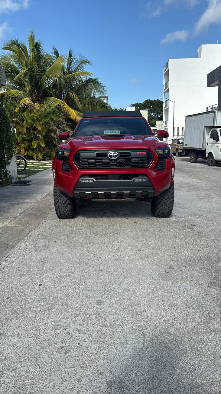

I recently changed the suspension on my Tacoma TRD Sport and installed a new TRD Pro Fox suspension. I changed the forks, shocks, and springs, but it has too much camber. It's already been aligned, but I can't get rid of the camber. Does anyone have any experience with this?

The dealership, and any shop who goes straight off Hunter's software, performs alignments on new Tacos and Tundras based on ride height. This only applies to stock height trucks and even then it's a bad alignment.
Take it to a performance shop who works on lowered cars and lifted trucks. We've had quite a few threads about this (I've posted in a few if you want to search my posts).
