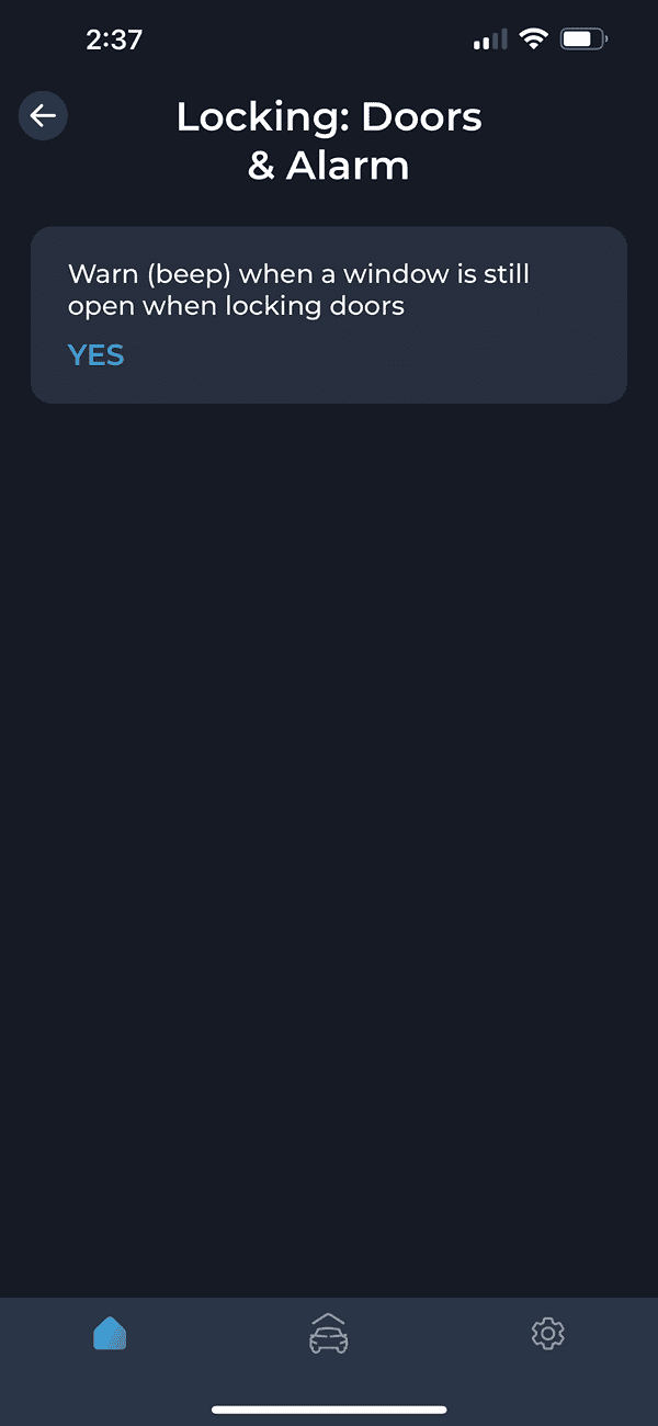

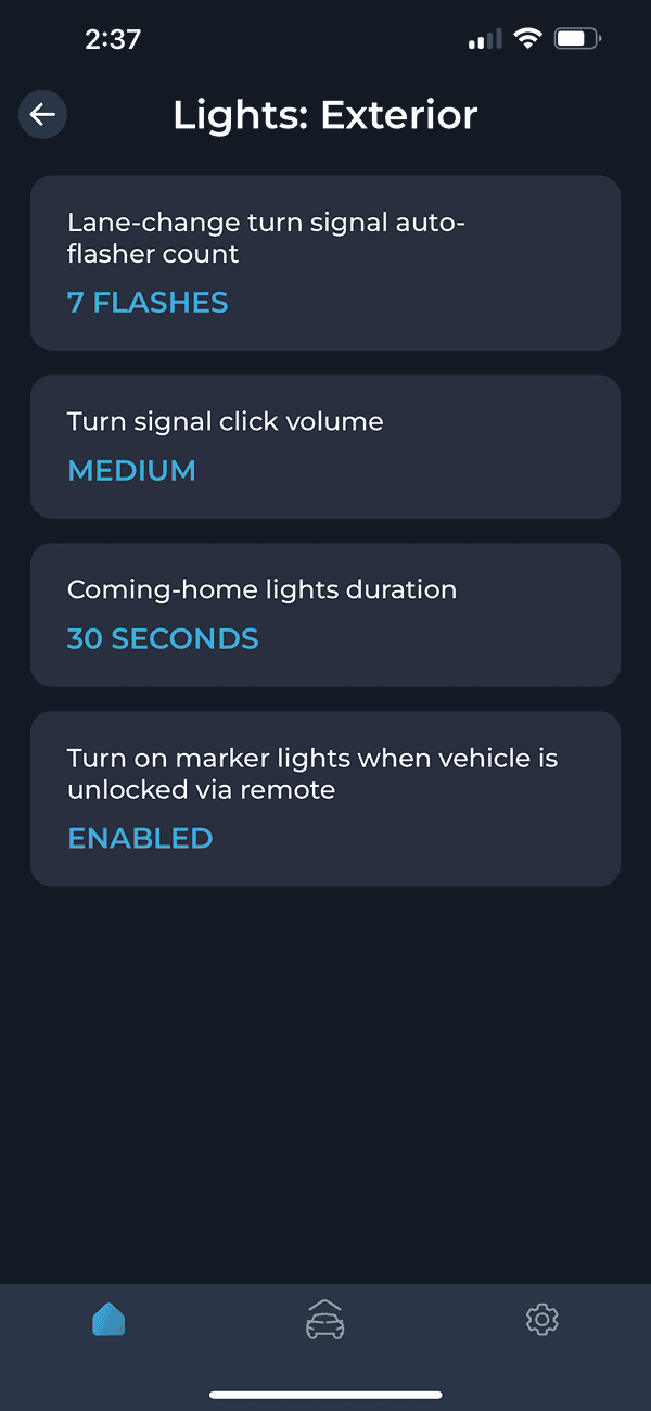

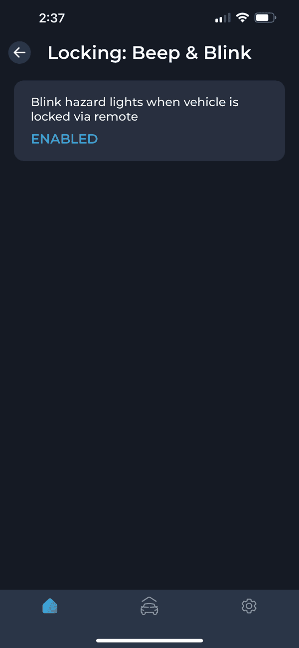

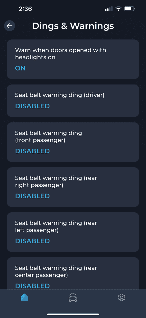

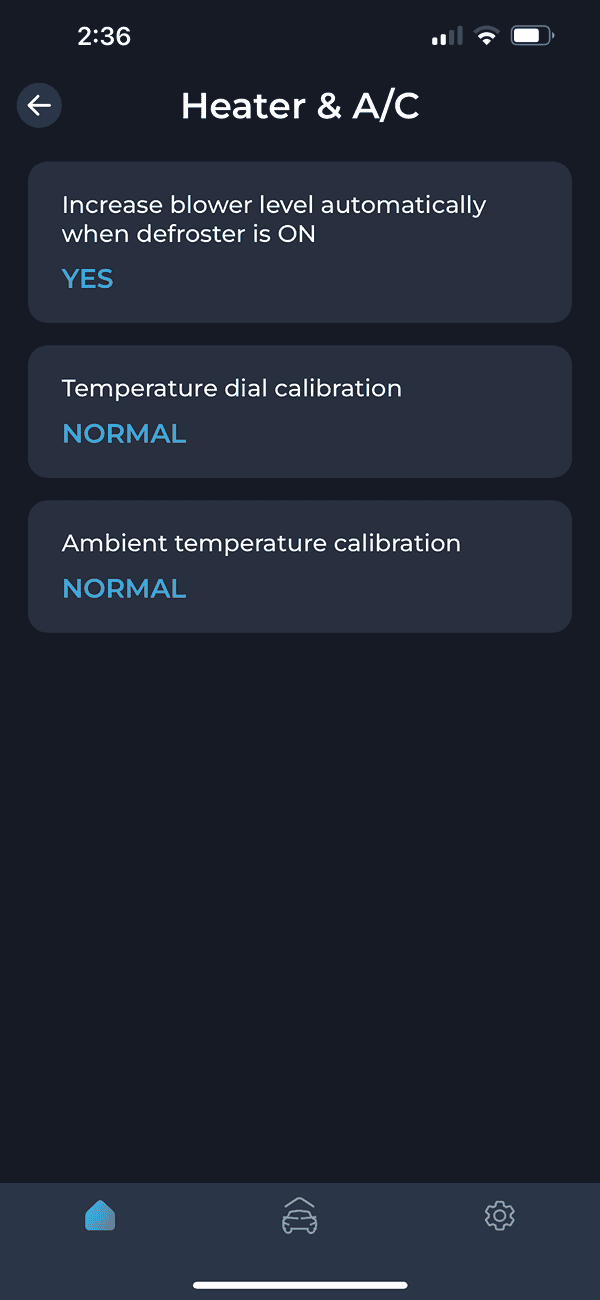

I finally got a chance to use my Carista. $9.99 subscription which I canceled immediately was totally worth it for these three things:
1) Change my blinker tap to 7 flashes instead of Toyota’s standard of 3 flashes. Since I only use tap on the highway, 7 flashes is perfect for changing lanes at highway speeds. If I’m turning in town, I’m not tapping the blinker, it’s a full-on engage at that point.

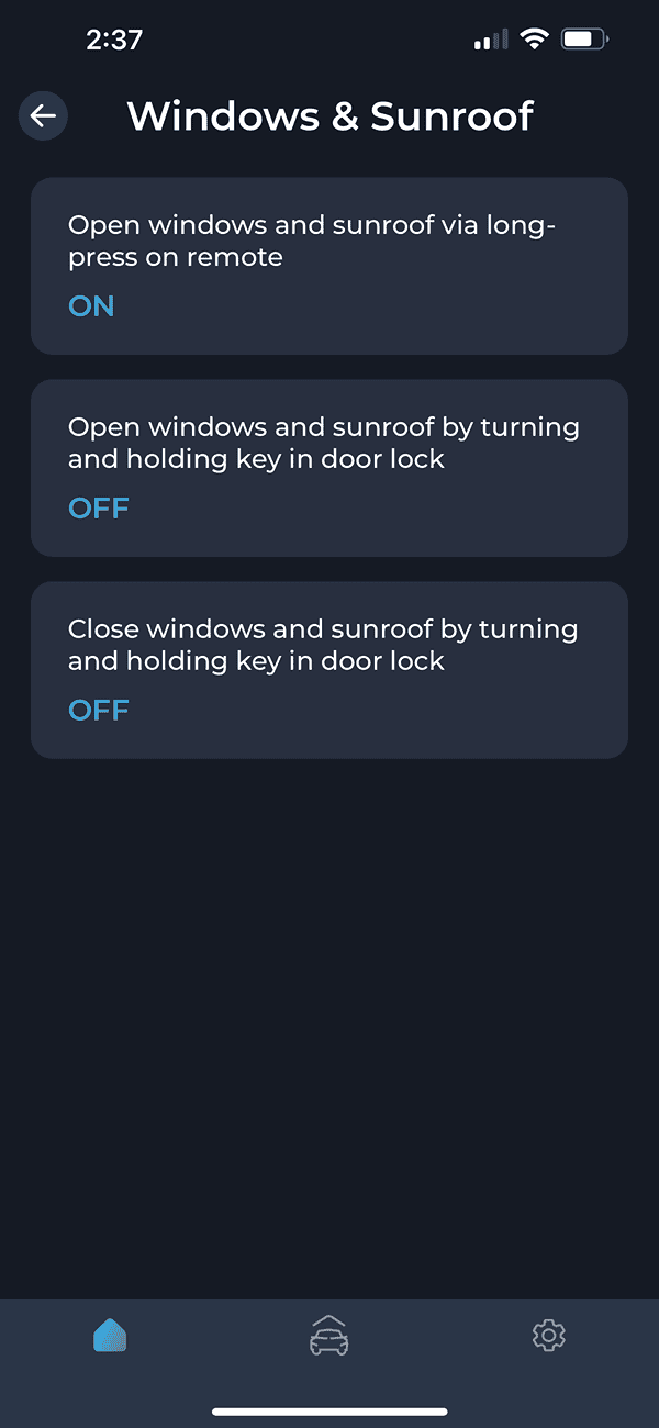

2) Auto-down of all windows with the keyfob
3) Remove the annoying-ass seatbelt chimes!

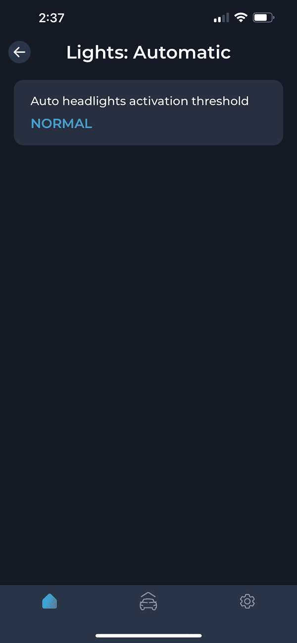

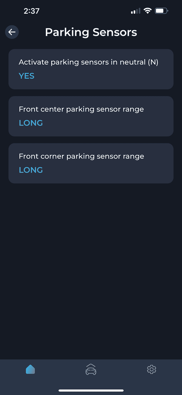

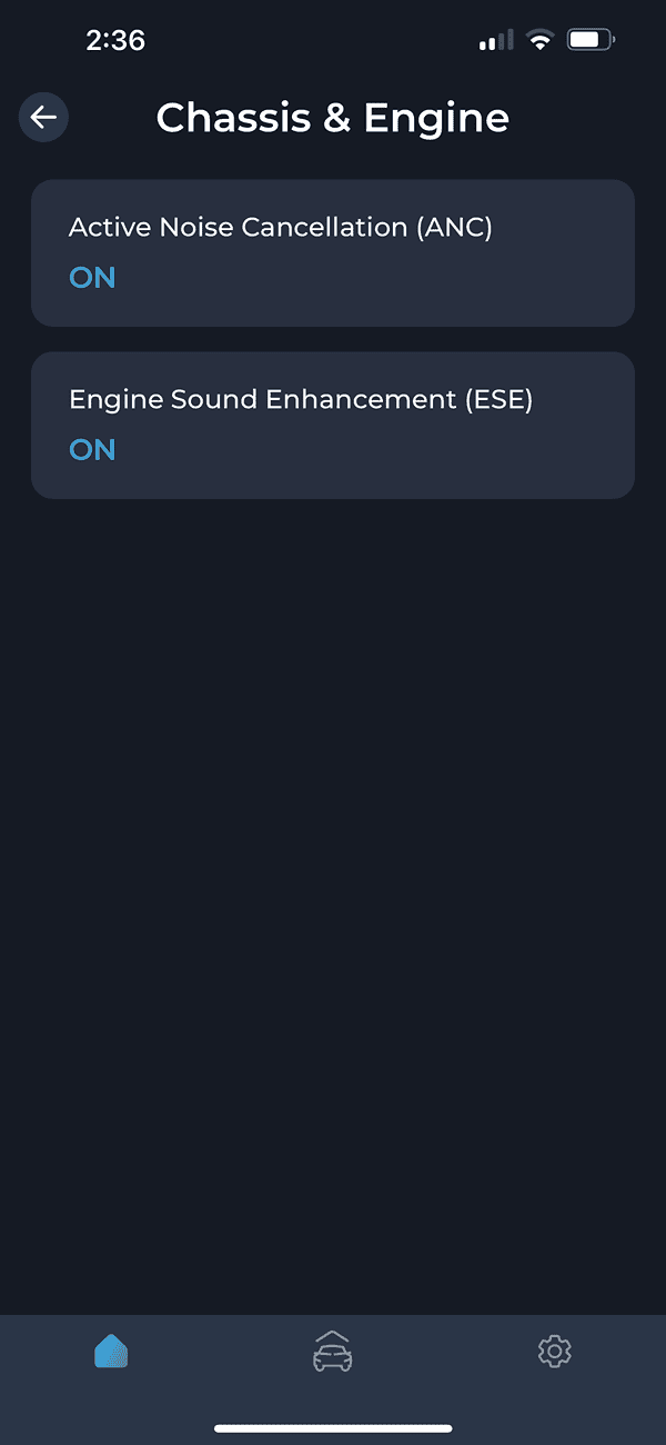

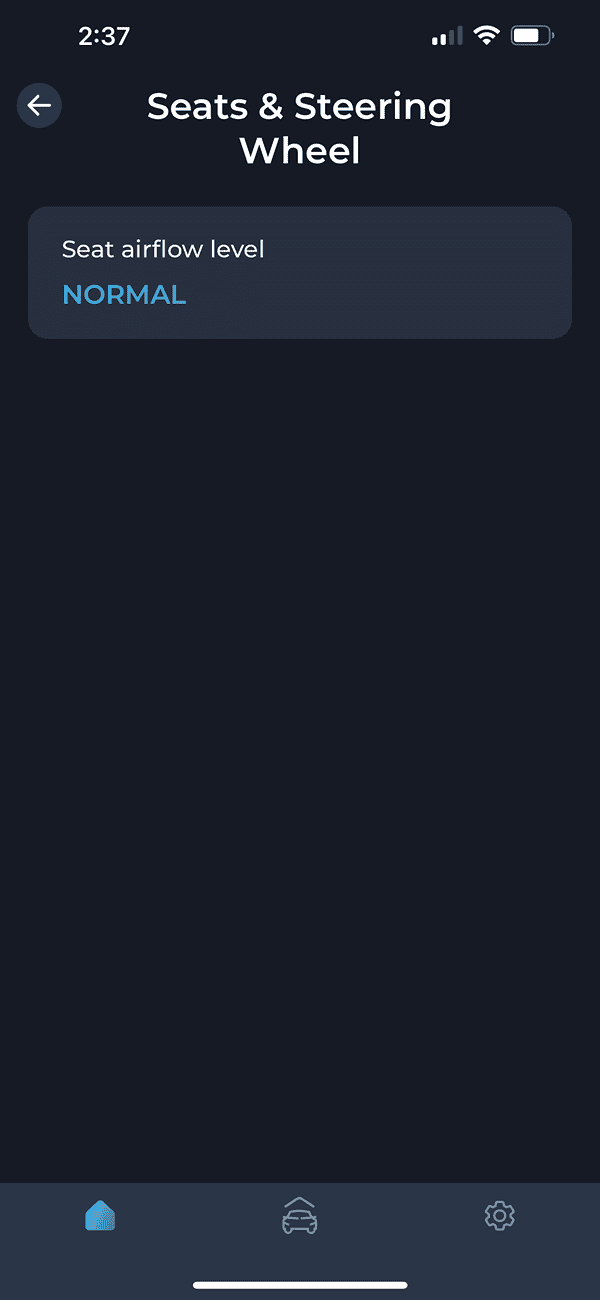

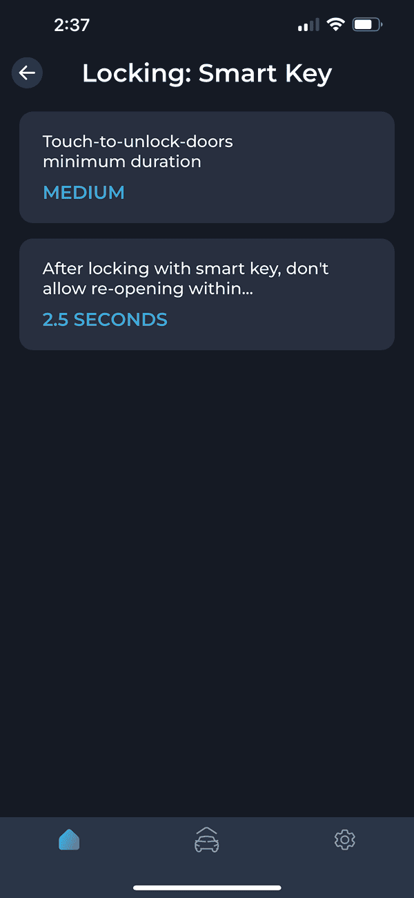

For those interested, here are all the options it gave me:

The video above goes over it well. The things I've seen talked about most are disabling the fake engine noise, disabling active noise canceling, and turning on the window control with the fob.
