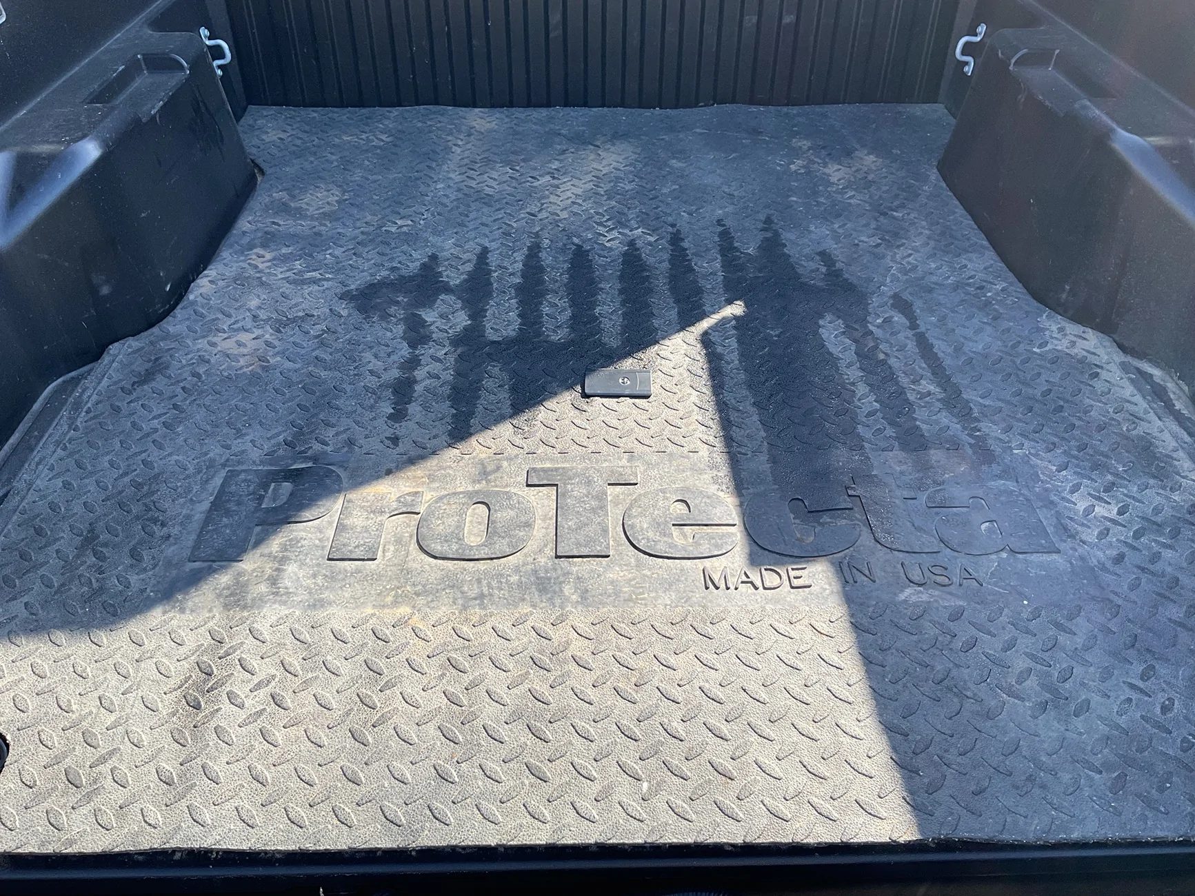

Weird. Mine works fine with the doors locked and the card key near the middle of the bed. I can open the tailgate but not the doors with the key card located here. I can’t imagine the bed cover makes a diffence.

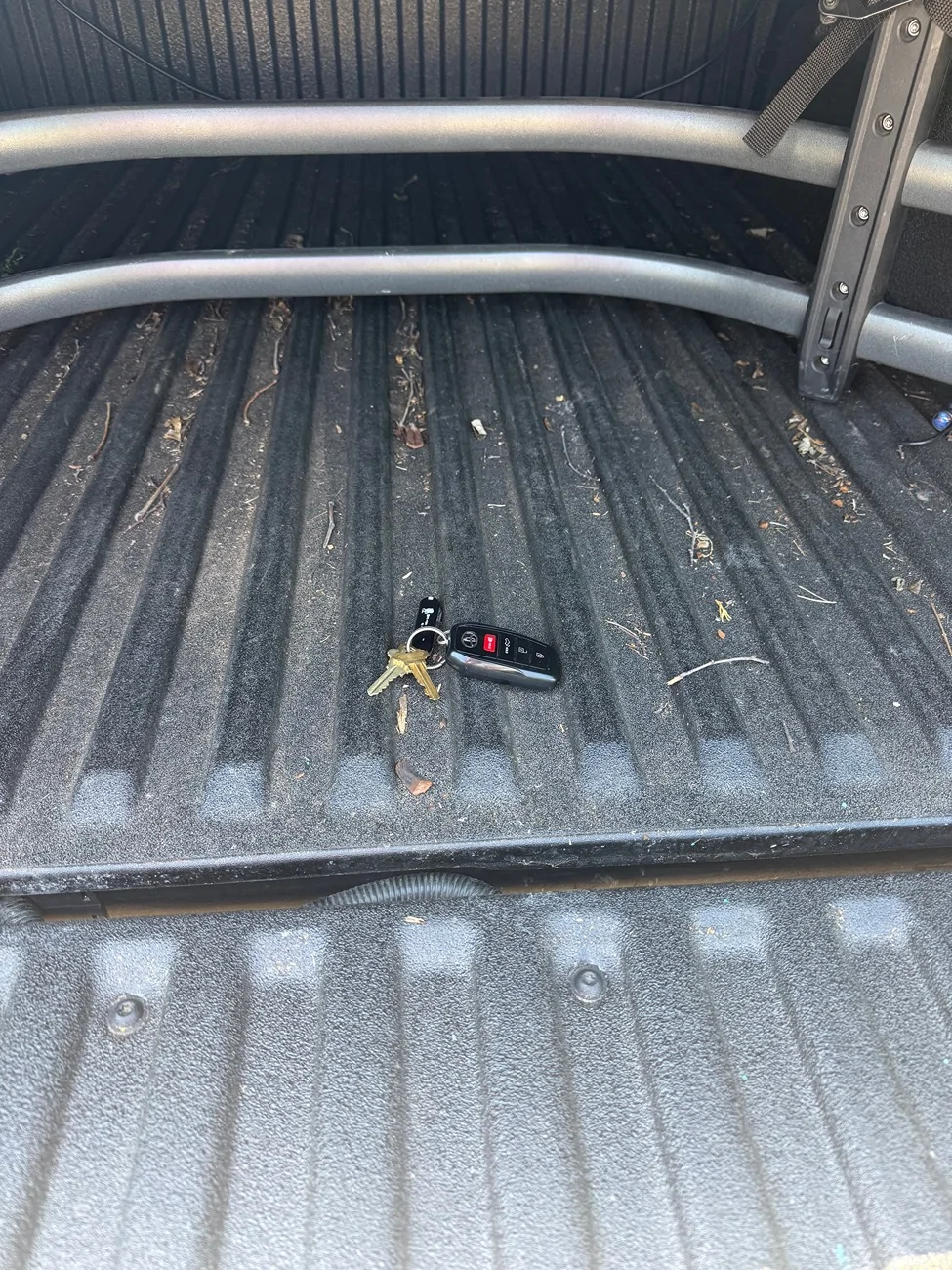

UPDATE:
Okay, I figured it out.
I couldn’t let this go and had to figure out why it locked on me and others had reported it did not lock on them. I went out, tried a little experiment. Locked my doors with my key fob, tossed the keys in the bed, and close the tailgate by pressing the tail light button. After about 15 seconds, I tried to open the tailgate by pushing one of the tail light buttons. It opened. Damn! So I tried the same experiment again. This time I waited one minute before trying to open the tailgate. It opened. Poop!
Then, I tried it again. Only this time I waited two minutes. Bingo! It would not open. I went back tried it again for a minute and 45 seconds and it opened. Apparently Toyota gives you two minutes to figure out you left your keys back there and gives you the grace period to go get them.
Now I know. Curious if someone else with a cover can try this, wait two minutes and see if you get the same results.

Confirmed! After two minutes of my key sitting in the bed with tailgate closed, the tailgate will not open.
