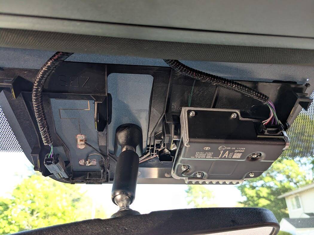

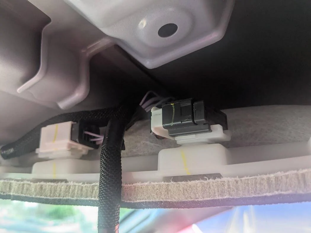

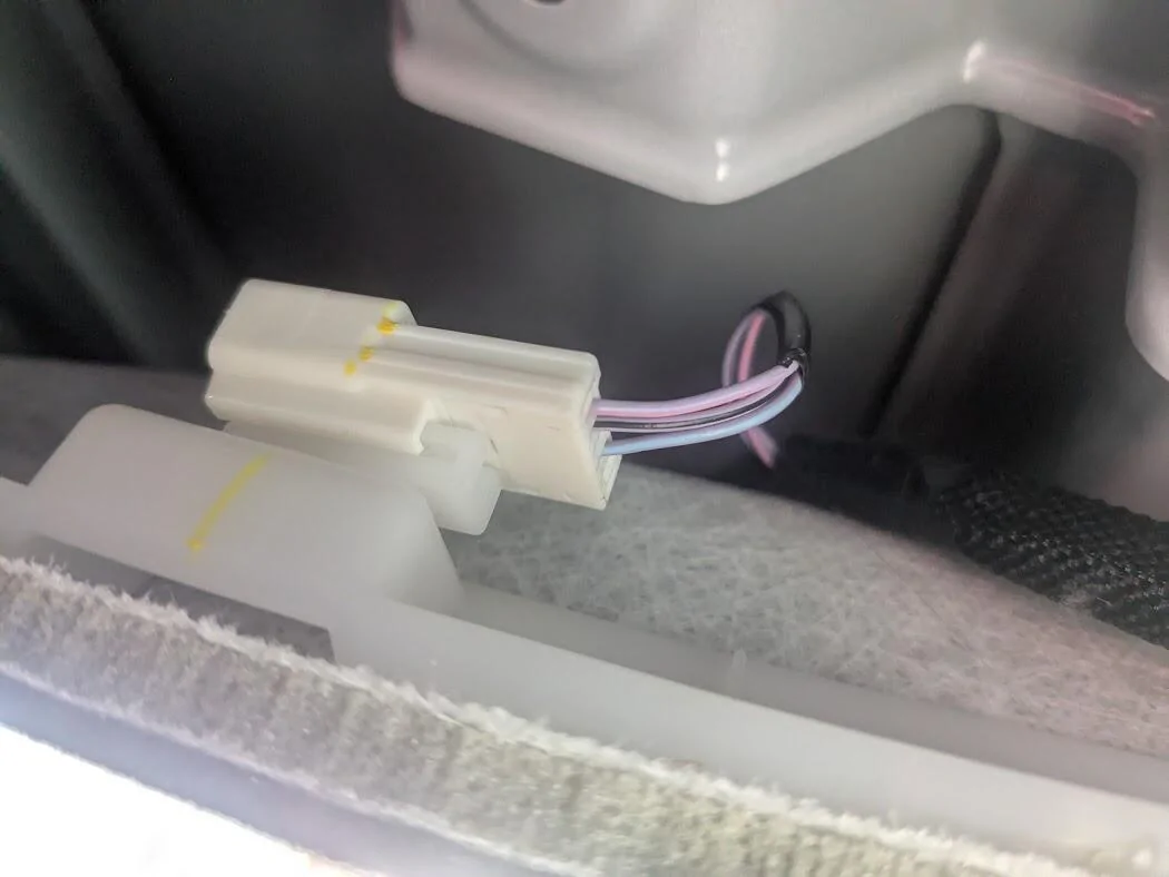

So I'm looking to see if I can add a dash cam and a auto dimming rearview mirror with the existing wiring. I took photos of the connectors up there, there is a 3 pin on the left side and then 2 connectors that are capped? or fused? I'm not sure but they are not plugged into anything. Are these usable for anything? I also looked under the mirror cowl and didn't see any free connectors.
This is for a 2024 SR with NO options and a manual transmission, I don't even have blind spot indicators on the mirrors.

Yes, the uncapped one is the OEM dashcam plug. I wouldn't load it up with too many devices but a dashcam and maybe one other low power accessory should be fine.
See my write up on the install here
https://www.tacoma4g.com/forum/threads/dashcam-hardwire-w-o-fuse-box-almost-as-easy-as-dongar.9910/
Do you have any idea what the capped plugs on the right are for? Maybe I can use them to tap additional power or signals from the truck? I'm talking about stuff like constant 12V power, switch power, signals, etc
Not entirely sure. I don't have access to the wiring diagram anymore. My guess is they might be for the sunroof but I couldn't tell you what the pin out is and I'd suspect there isn't a constant on source.

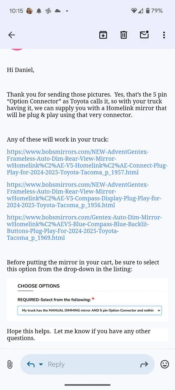

Response from Bob at Bob's mirrors himself, so the 5 pin will definitely work for my auto dim motor, I wonder if I can use the 10 pin for anything else as well. I'm pretty sure the early SR trucks did not have any wiring up here so I'm feeling pretty lucky and appreciative that this will be plug and play
