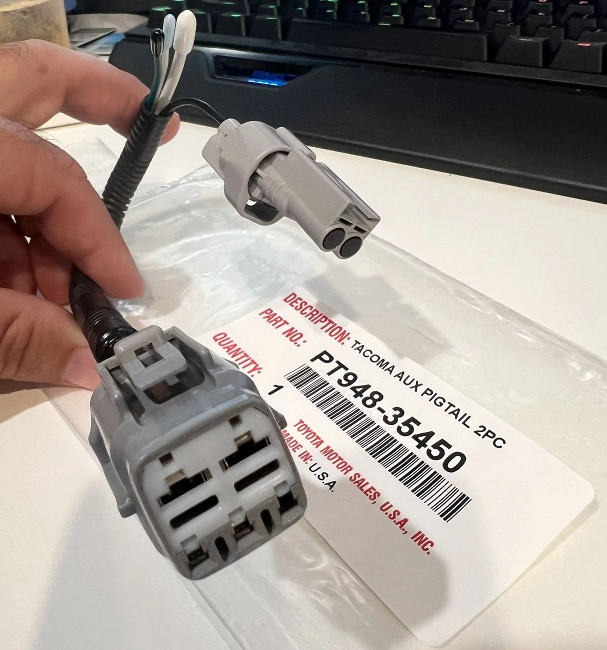

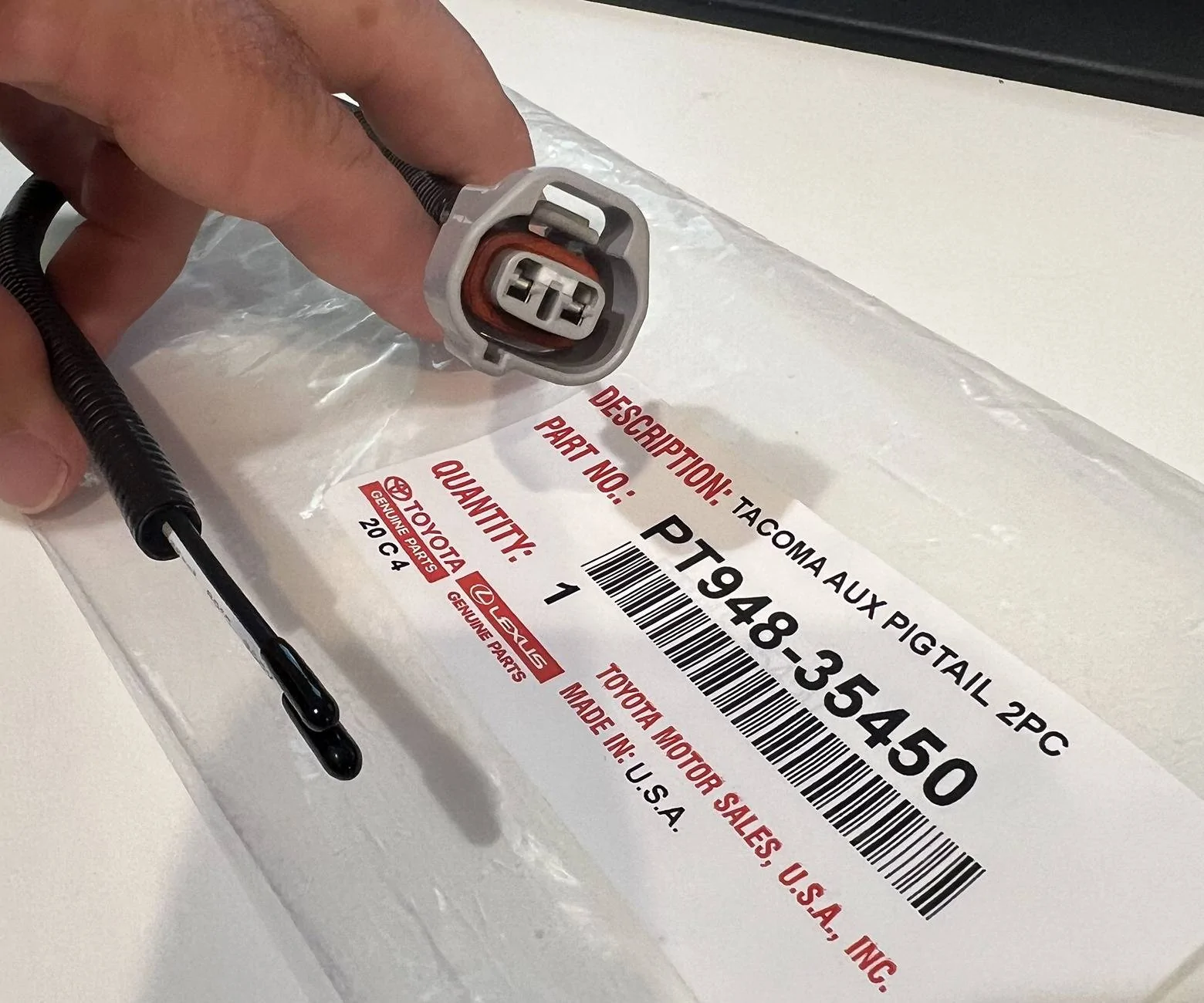

Follow up post for the second connector kit I received with my Trailhunter: PT948-35450 Tacoma Aux Pigtail, 2 Pc:

So this brings up the question what the front and rear aux connectors are, and where you get the connector hardware for that little two pin connector jobbie.
