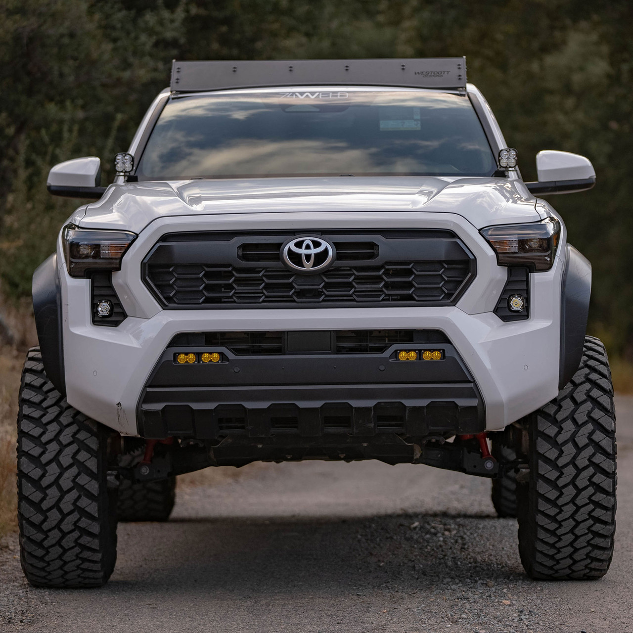

Baja now has a "vent" LED option but only in white. No amber.
2024 Tacoma Control aftermarket lights with high beam lever (in addition to high beams)? 1756141059027-v6
Thanks, Ron, I'm checking out Baja now.
