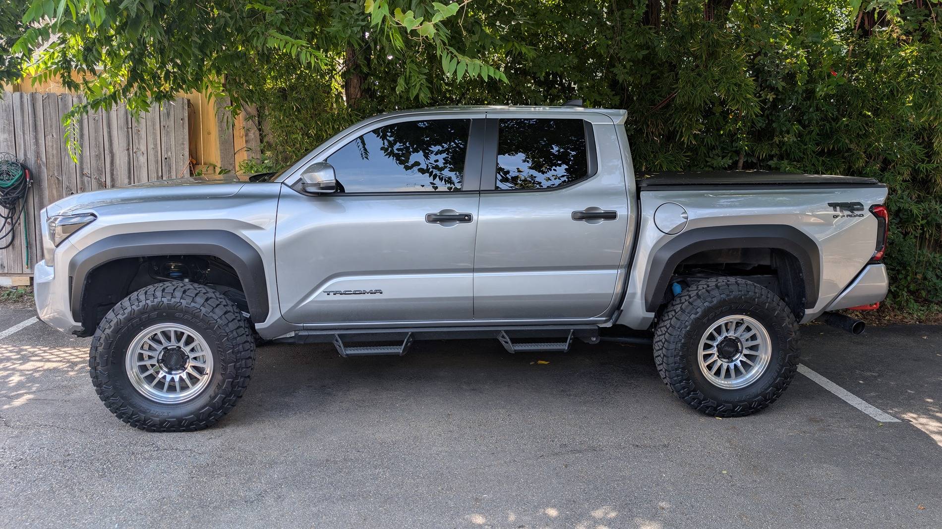

Just curious if anyone has lifted their 4th gen and had issues with cruise control calibration and a possible fix. It works in the day time only, I'm guessing the camera at the top of the windshield cant see the road at night? Recalibration is expensive. Just wondering if there's another fix.

Hate to break it to you but you're probably going to have to go to the dealership and pay for the ADAS recalibration.
I know on the third gen we all just put a washer or two on the top bolt of the radar sensor.. not sure if that's possible anymore it was always finicky
If you want to DIY, You could get a bootleg version of Toyota Techstream and get one of those USB ODB2 cables and try to find the TSB instructions for the OEM lift kit.
But I think there's a lot more to it with special reflectors or something

Search here. Pretty sure I have seen forum posts about calibrating some of the truck sensors (and maybe some are DIY if handy?) if you have an obd2 scanner and diag tool. Can’t recall the details but I bet it is possible!
