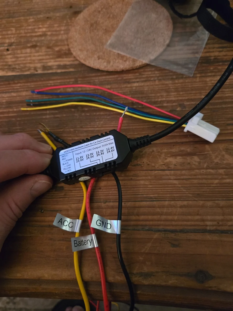

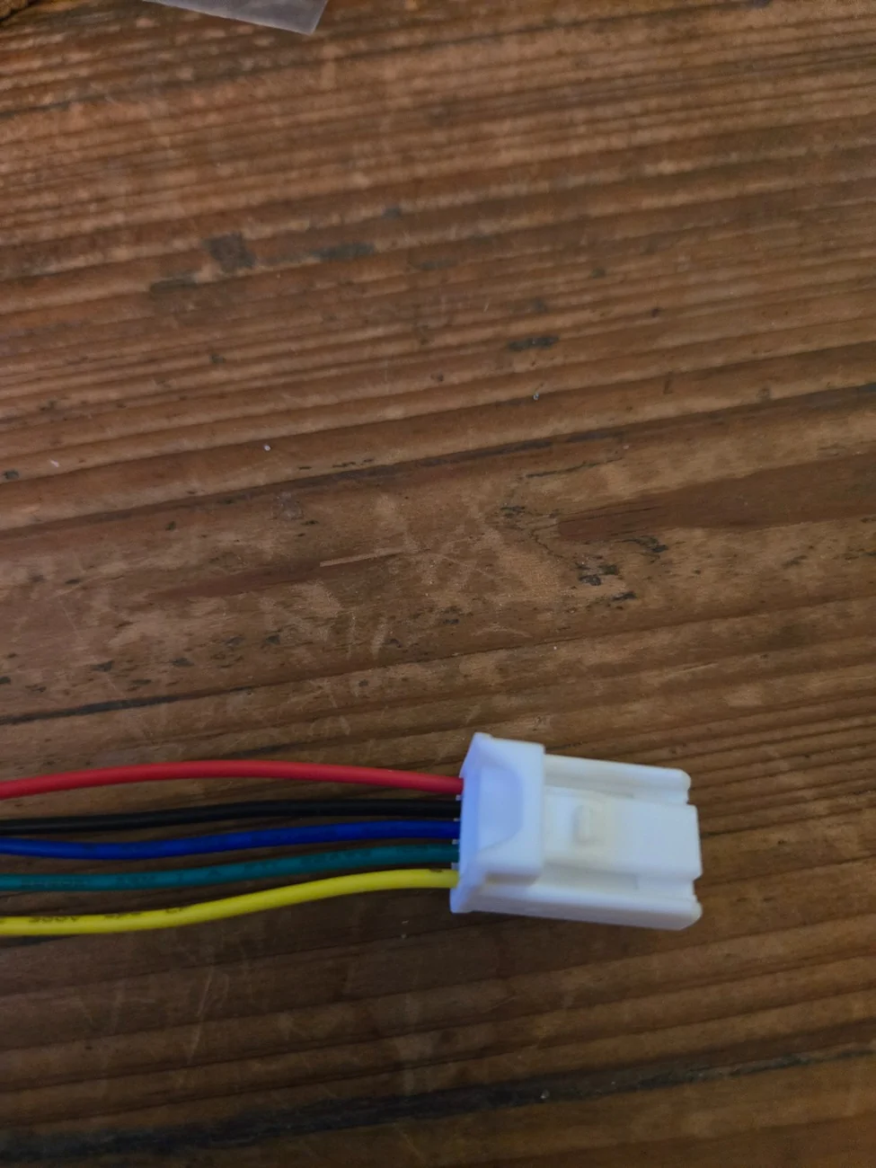

Im hoping those more learned than me can help me out with how to wire the HJ4 parking wires (red,yellow,black) to my 5 pin female connector (red,black,blue,green,yellow). My Taco is a 2025 Off Road... Im seriously hoping Im not asking a question whose answering is slapping me in the chicklets... ie red to red, yellow to yellow and black to black... It cant be that simple :)))

In your case it’s going to be:
Adapter Red = Plug Yellow
Adapter Yellow = Plug Green
Adapter Black = Plug Black

The colors on the plug you have are arbitrary. That plug is used for many different functions so the wire colors are just so you can differentiate them, not to match any sort of standard.
You can reference the photo I took of which color from the adapter goes into which pin of the plug and compare that to your plug and cross reference the colors.

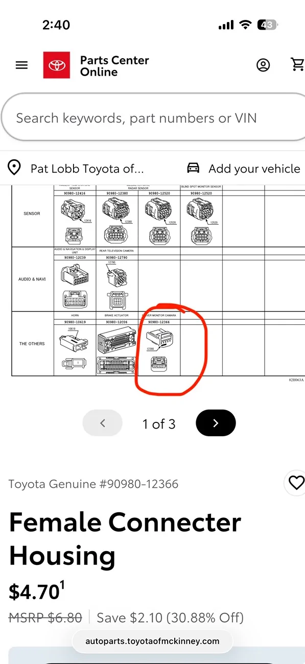

Hi all,
Sorry to dig up an old thread, I just want to get some clarification about the female plug and its wiring.
I got pretty much the same dashcam A229 Plus with rear cam like the @BoboForShort has, and wanting to do the same set up.
Im planning to order just 1 plug from Toyota OEM, as pictured below, would it work just like the one from Aliexpress. That OP posted?
How do you put the wires into the female plug? Sorry, im kinda confused looking at the pictures on aliexpress and how it all works out.
other than that, once the wires go straight into female plug in the order listed, it’s simple, correct?
Thanks yall

You’ll need more than that. I don’t recommend it.
The wire that comes with the wire harness for the dash cam is too thick to fit in the crimps for the plug.
So you’ll need smaller wire, and the pins for the plug, and the crimping tool for the pins. Then you’ll need something to connect the smaller wire to the wire harness for the dash cam. If you don’t know what tools you need you probably shouldn’t attempt it.
It’s much easier to get the plug pre-wired and crimp it to the wire harness or use a solder connection like I did. You could also use a Wago lever nut.
