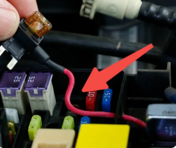

Quick question for those using an Add-A-Fuse in the engine bay fuse box.
Mabett
Apr 21, 2026
68
LA
www.facebook.com
2026 Tacoma TRD Sport
2024 Tacoma Quick question for those using an Add-A-Fuse in the engine bay fuse box. screenshot-20260608-182133
How are you getting the cover back on with the wire coming out?
Did you cut a notch in the cover, run the wire through a gap, use a fuse box riser, or find another solution?
Would love to see some photos of how you did it.

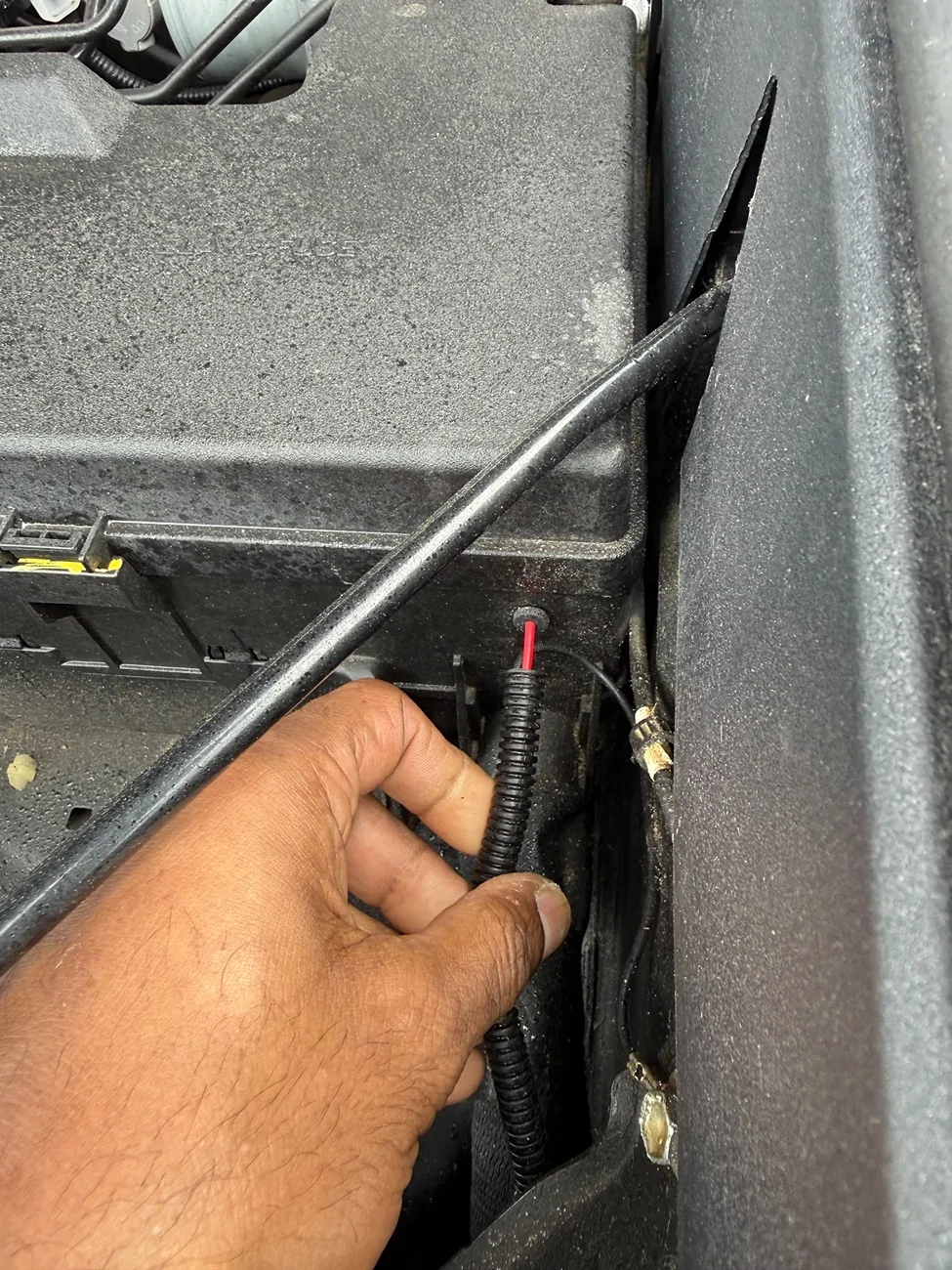

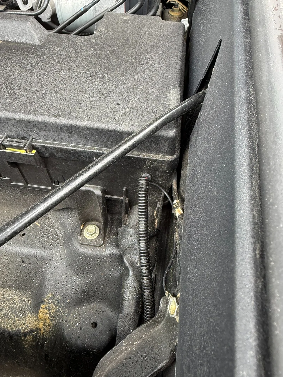

I chose to take the fuse box on the driver's side ( non hybrid ), loose and ran the tap wire through the factory loom. The process takes a bit longer but the end result appears factory.
A picture would be futile because it shows nothing but a fuse tap, that's the idea !

Thanks, that definitely sounds like one of the cleaner OEM-style solutions. A few others have also mentioned loosening the driver-side or passenger-side fuse box and routing the tap wire through the factory loom. Our main concern is that it adds too much additional labor time.

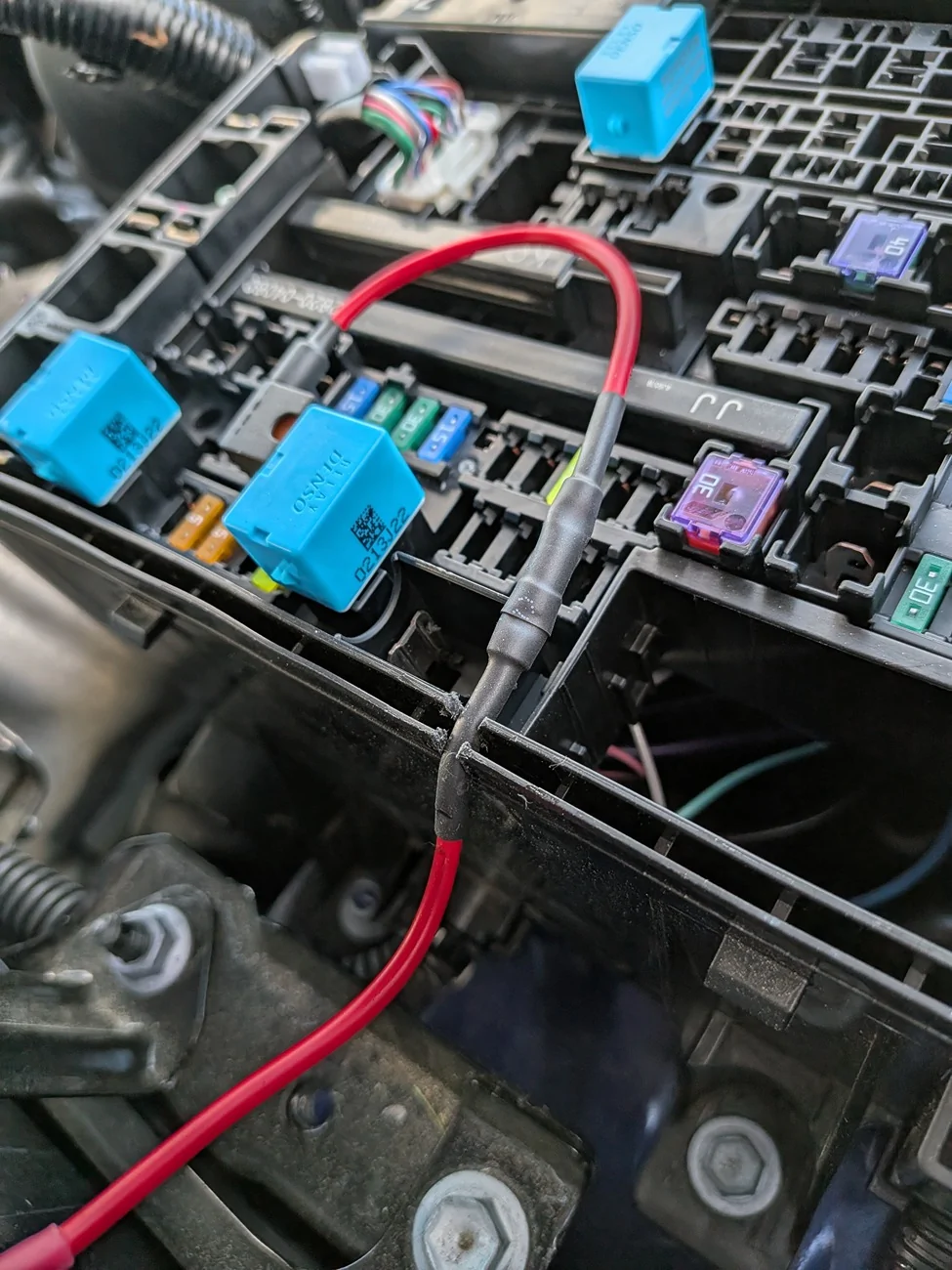

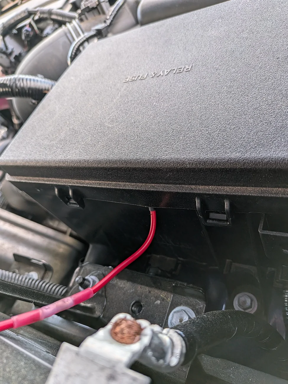

I used a small grommet. Fit perfectly and seals the hole.
Thanks! This is probably the best solution we've seen so far. Simple, clean, and keeps everything protected. Really appreciate you sharing the photos.
