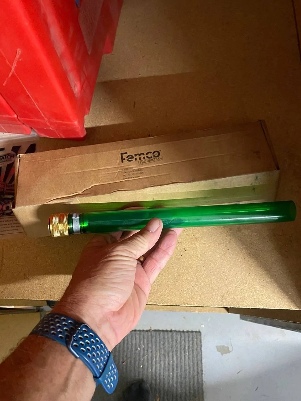

Try the Femco drain plug. Have one on my JL with skids and you screw a hose to the plug and don’t spill a drop.
What part number fits the 2024 Toyota Tacoma? I see there are different sizes.
I email them here is what they said.
Hello Ted,
The Toyota Tacoma would take any of our plugs with an M12x1.25-T9 thread pitch. Residual oil is not an issue when utilizing a Femco drain plug. We recommend draining the oil at engine temperature to fully flush out all waste particulates. This is easier as Femco’s system prevents burns.
Hello Ted,
Best regards,
Do you think this is more user friendly than the Fumoto brand? I’m deciding between the two.

Yes I do like this better check out the web site and ask them your questions.
The plug screws into the pan and has a cap that screws on to it . They have a valve in the plug that is closed until the hose is screwed on to the plug. Very easy and clean to use. Used on my Jeep for many years, Jeep has skids with a hole and I screw the hose in and drain the oil right into an extra 5 qt bottle with no mess. Only have 1500 on the Tacoma but will be ordering one soon
Yes I like this one cause the way the hose connects after the cap is screwed off the drain plug. The drain hose pushes a valve inside the drain plug to drain the oil. Have not used the other one but do not like the release handle to open the valve on the other.
Yes! Exactly why I went the same route.
