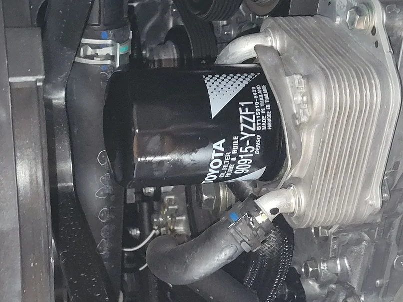

@Pappy are those larger filters a confirmed fit? Might be worthwhile switching to the bigger ones as there is room
I've run all of them, well, I haven't seen an N3 yet (N3 superseded -10010 which is now NLA in the USA). But yes, I've run -10009, -10010, N1, F1. When I took my truck in for it's 20K service, the tech noticed I had a F1 on the engine, and installed another. It was funny. The paperwork said N1.

@Pappy are those larger filters a confirmed fit? Might be worthwhile switching to the bigger ones as there is room.
A picture is worth what?
2024 Tacoma Oil Change Question? F1 installed-sm

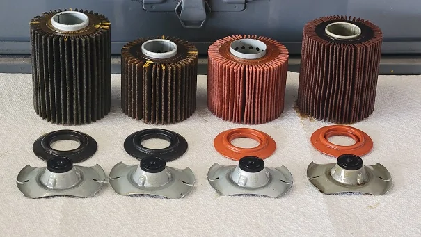

Also, for chuckles and grins ... I have no thoughts or opinions at this time (I don't have the skills or knowledge to have an opinion). I can tell you the pleat count is different. This picture is posted for entertainment purposes only (my entertainment, grabbing popcorn for the comments). I will let you all argue about this. Bottom line ... run what you want.
2024 Tacoma Oil Change Question? Cut filters-sm
L-R: F1, N1, -10009 (original filter), -10010.

@Pappy I've got an M1-103 filter on currently, and it's definitely an inch longer than the OEM toyota filter...more similar to the 10010 version I'd say. Honestly...the OEM filter for these trucks is smaller than most lawn mower engines. It's pretty pathetic, especially considering the recommended oil change interval. Planned obsolesce if you ask me...
